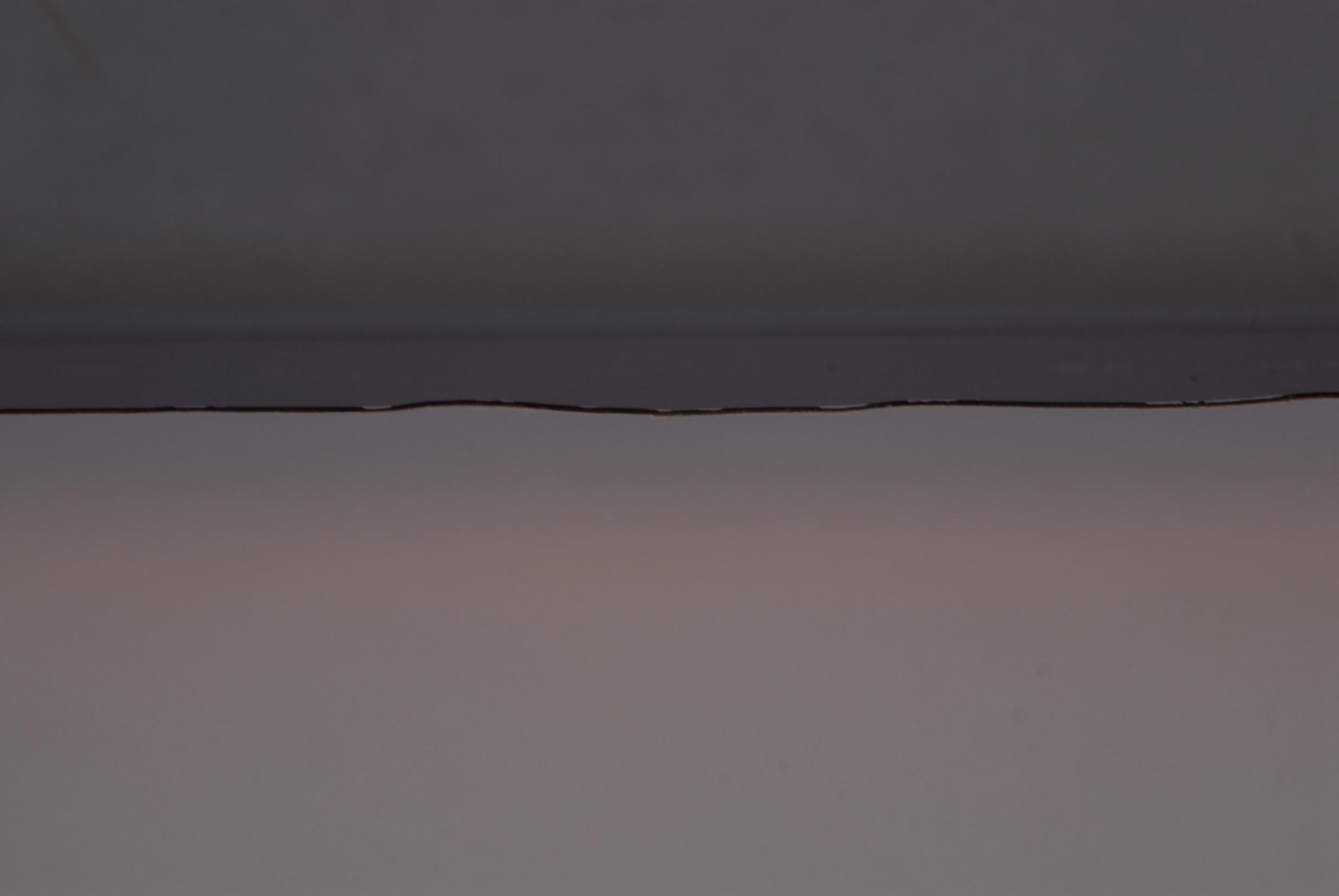

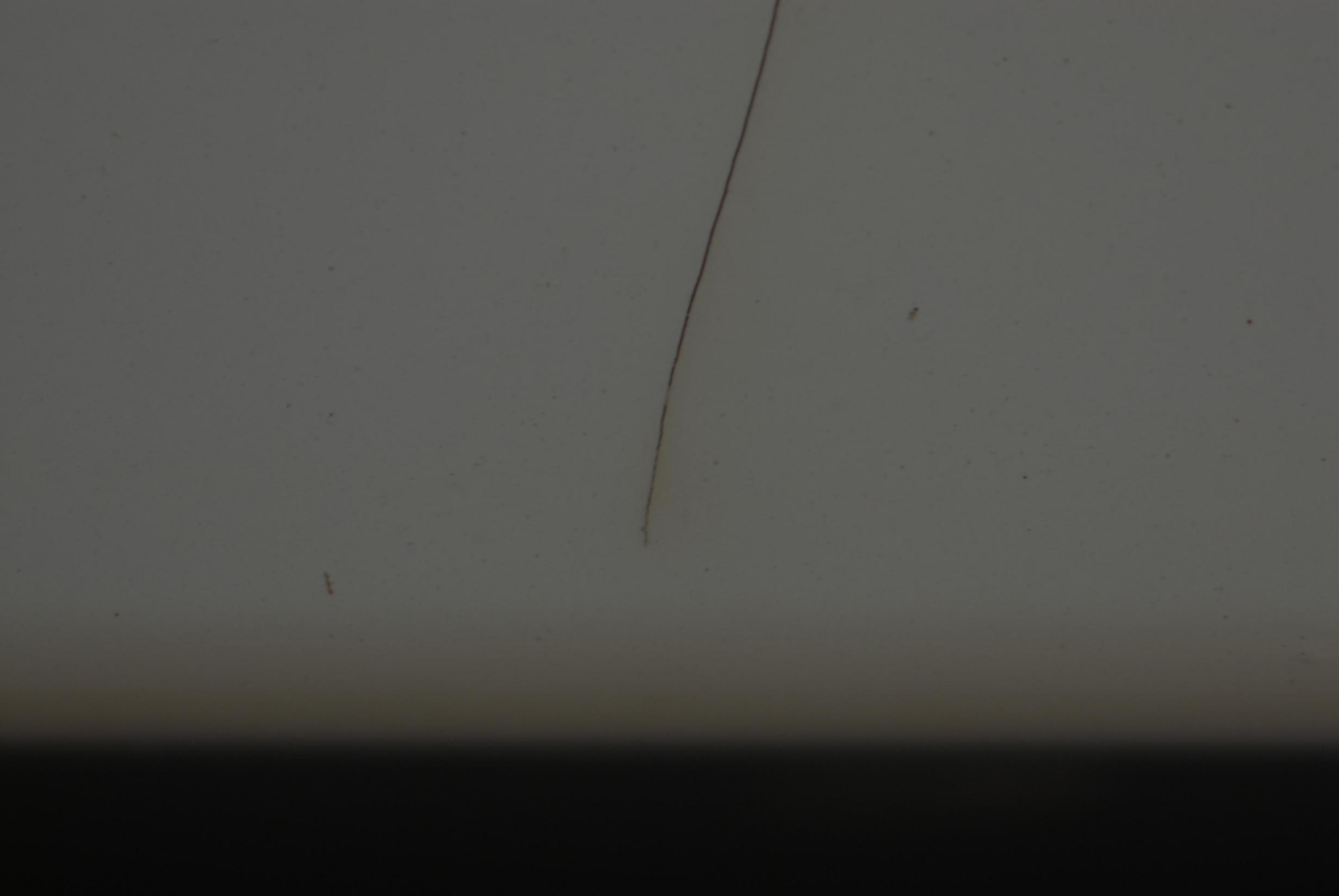

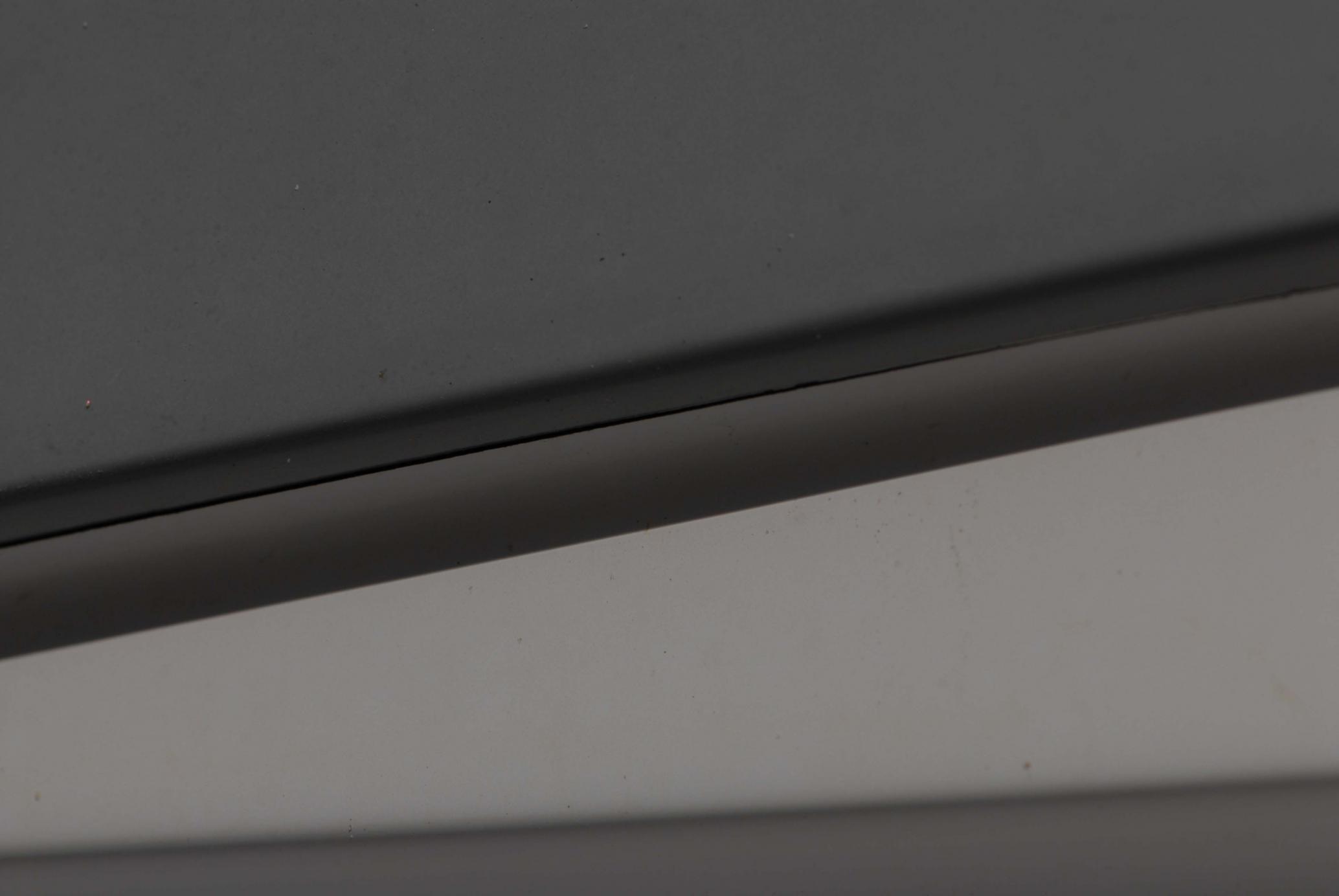

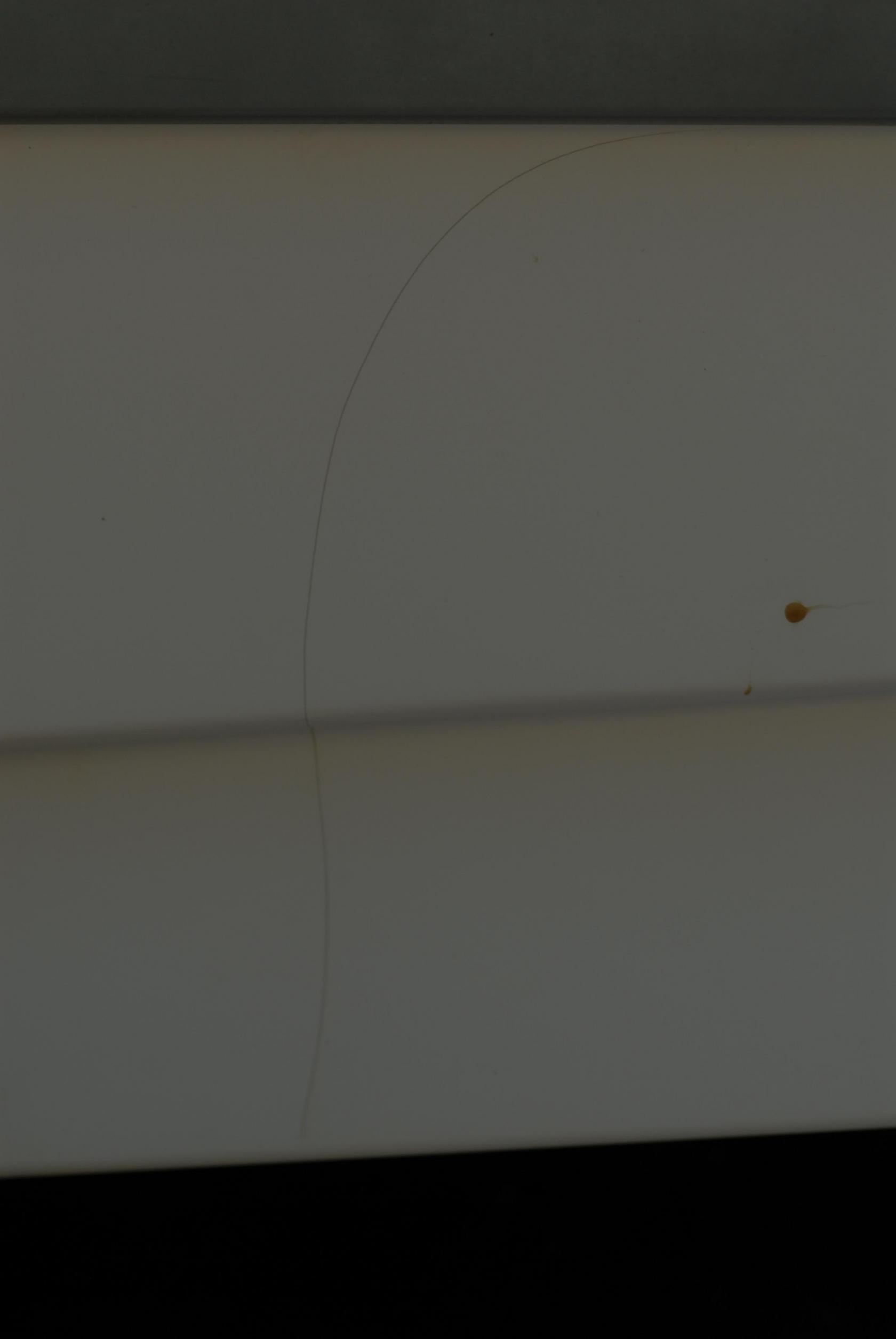

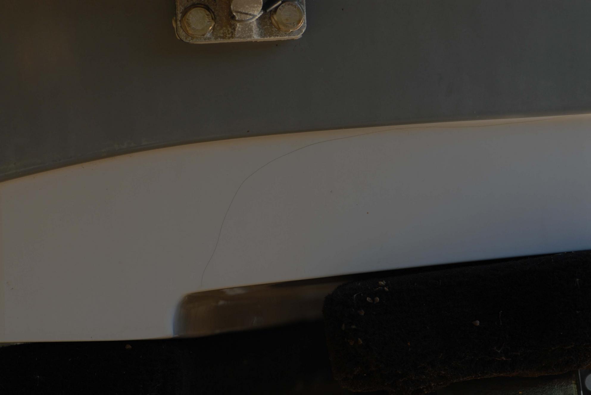

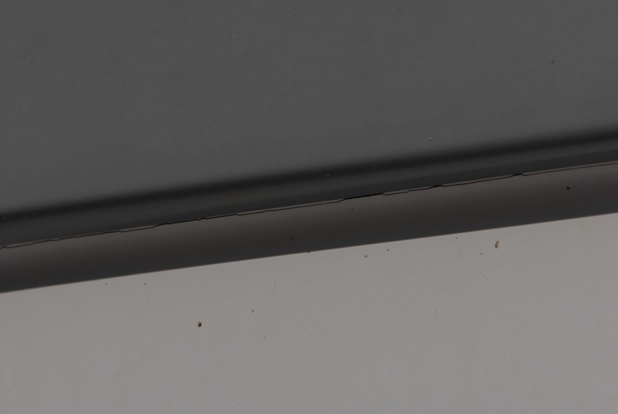

    Noticed 3 curved vertical cracks on our 211. Then noticed a crack along the 90 degree angle/seam near where lower white/grey meet running from about 3' from stern, around stern, to about 2' forward of stern. Neighbor said that the way the crack in the seam runs and not following the colors would lead him to believe it's delaminating at the seam and the curved cracks I'd originally noticed are stress from that. Cracks seem to small to me to be any deeper than Gelcoat. ??

        99.99% of all cracks that you see on most any boat are just in the gel coat. In the simpliest form gel is just colored resin, which by nature has very little structural strength. They also take the most beating and stress being on the exterior exposed surface.
        I would disagree with your neighbor that believes the cracks go through to the laminate. Take it to a gel shop, and they will grind out the cracks and most likely just need to do a gel patch.

            Thanks everyone. I took a feeler gauge over today and was able to get one of the thinner ones (0.05mm IIRC) in about 1/16" to 1/8" in a couple of places but most of the crack was too narrow.

                I think your boat is far too new for these cracks to be normal. I understand your feelings regarding your local CC dealership, but I'd think these cracks need to be investigated by CC. For a glass repair shop, it can all be repaired with somewhat ease, but you have to wonder why they're there in the first place.

                      Those are some pretty wide cracks! My guess is that they are just in the gel coat but have not seen them that wide before.

                        They're pretty wide, though not sure if they're as wide as you think. I was pretty close on some of those shots.
