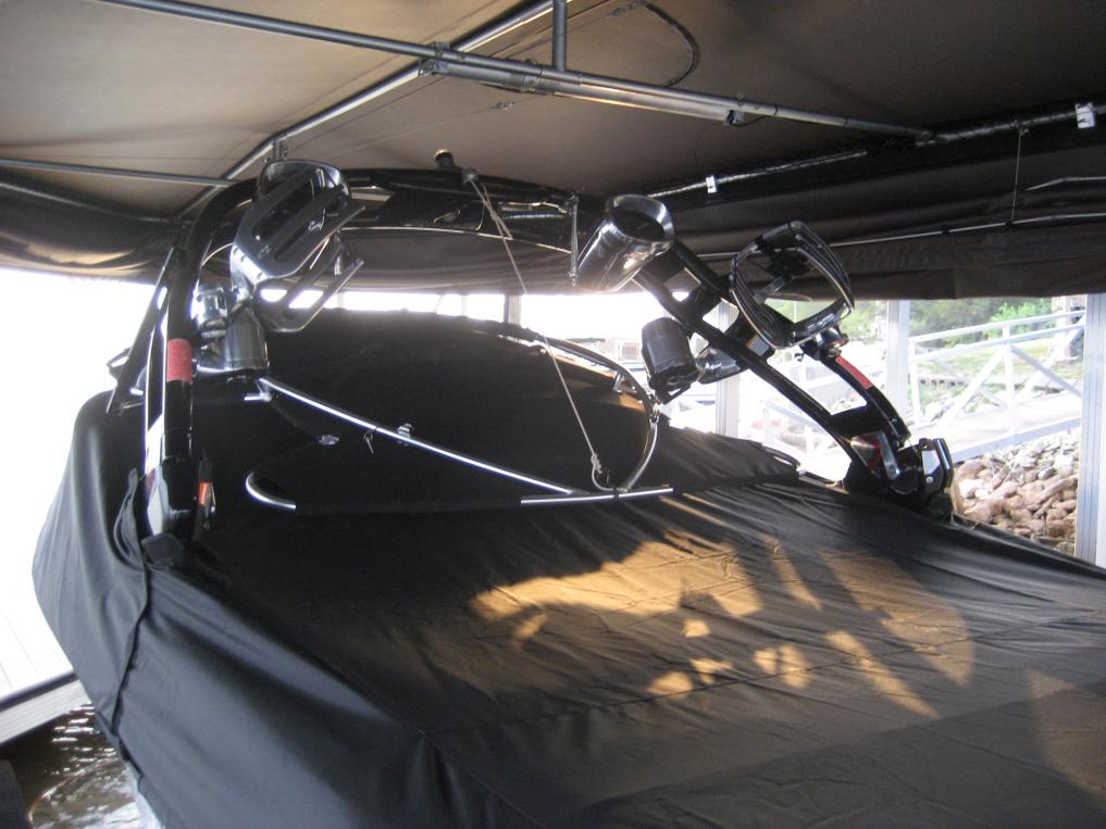

            On our 210 w/Z5 we have to partially collapse the tower to lift the boat in the dock. We didn't need to go all the way down, so I made some wedges from a 2 X 6 and covered them with carpet so all we have to do is remove the back two holders for the Z5, put the wedges in and drop the tower. Saves a lot of time for us.Click image for larger version

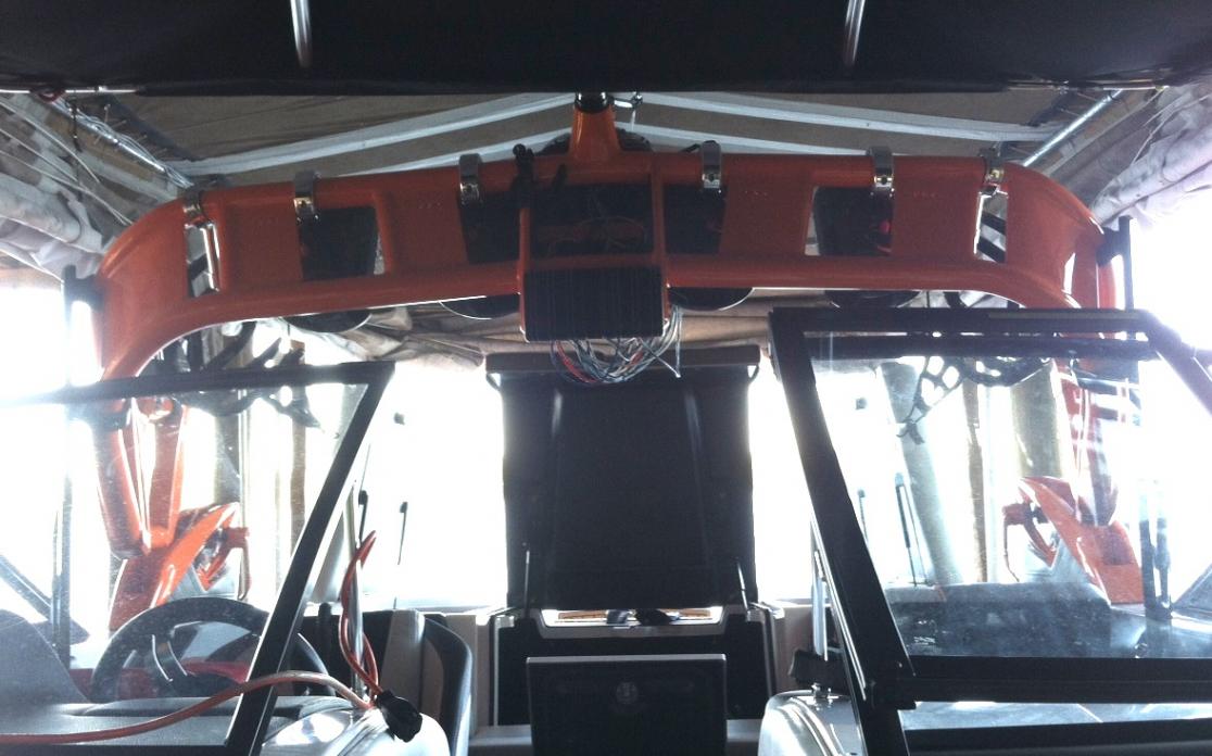

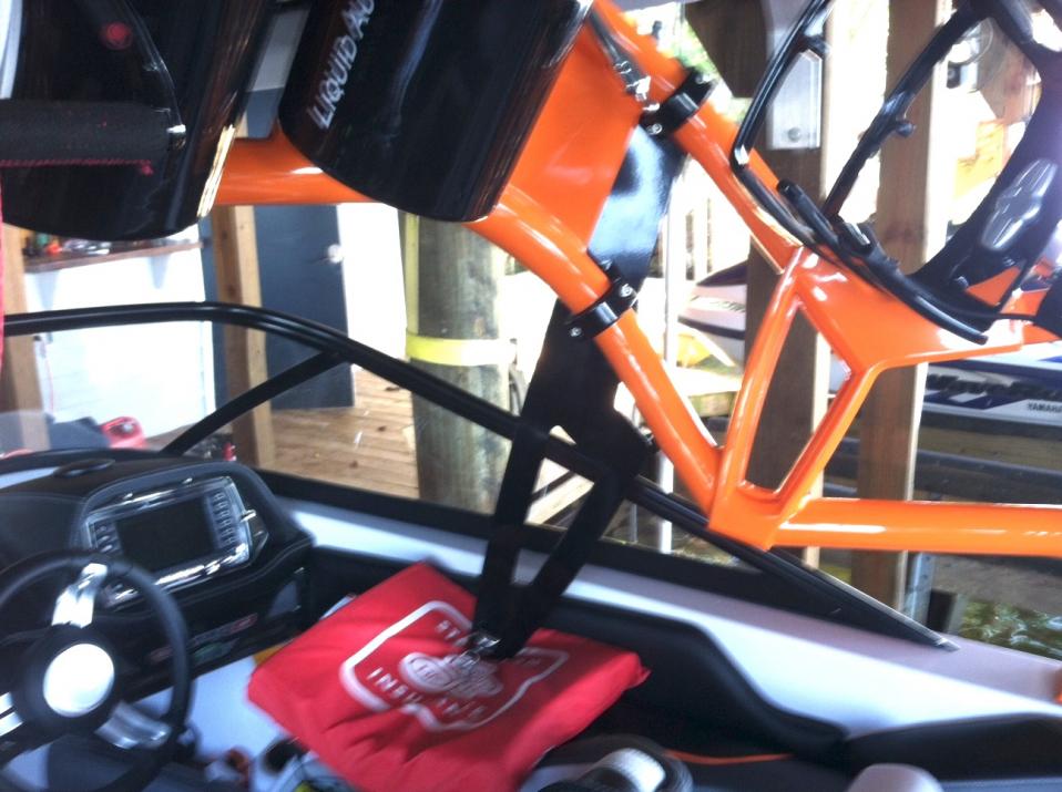

                  The tower is actually about 22 inches above the windshield when lowered and the Z5 adapter brackets are in place. Here are some lousy images, but they may help. Too bad they do not make the adapter bracket as a two piece part with a pin that would allow quick separation.

                    Thanks, 2 good images there for comparison to the stock tower.

                          RE: the pics of the orange tower with the z5 mounts-
                          Seems like those arms mounted to the tower could be designed to either quick connect or some sort of folding design. If I were on the market I would get the z5 and I would fabricate a better design.
