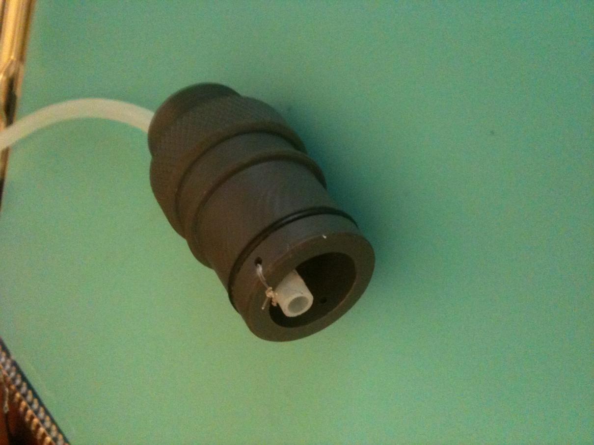

Thanks to the threatening rain in DFW which keep me off the water this afternoon, mine is done and with a whole lost less hassle and money than the route I was headed down with WakeMakers.
tdc_worm get the innovation award of the year! THANK YOU!!!2013 G23 450 with NSS (175hrs) and still have the original prop
2010 SANTE 230 343 (280hrs)
I'm going to run my 1/4 tubing with quick connects so I can remove the sacs when needed. I will just drill the quick connects and then attach them to the sac fitting then attach the tubing to that2008 210 SAN TE (Moonraker Yellow over Midnight Blue)
tdc_worm...great idea....and thanks for the photo, swankster.
I took the path of least resistance and used a bungie cord wrapped around the vent line at the rear of the sack to keep the rear pulled up so the bag never gets sucked flat (which then prevents the hard tank from venting and will collapse the hard tank on the drain cycle). I haven't had a problem with this set up for two years after bending two sender units in 12 months (and having a couple of close calls).
But tdc_worm's solution is MUCH better. ( 1 ) It gets rid of the white-trash-looking bungie, and ( 2 ) it lets me vent entirely from the front of the fat sac so I don't have a vent line visible across the top of the sac (right now I vent from both the front and rear of the sacs).Last edited by xrichard; 08-21-2012, 09:39 AM.Previous boats:
