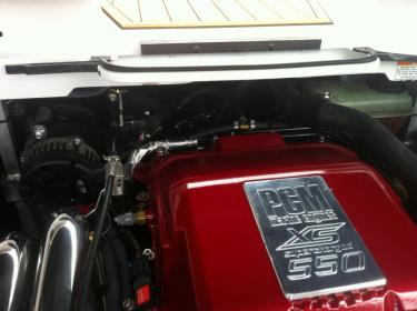

          Just throw a new PCM XS-550 in there. It is already supercharged from the factory!
