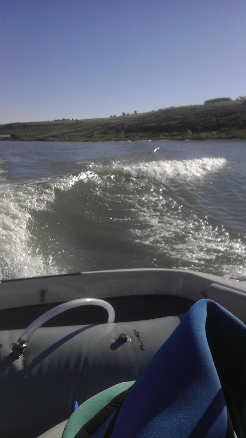

Here is a picture of the wave. Note: this is not the greatest photo as I also needed to drive the boat so I couldn't get it from a better angle which would show the height. It is also on the worst side of the boat. The prop rotates right on a 99 so the goofy side is usually bigger. IMHO it was easily surfable.
I hope this helps. Usually I am very detailed oriented with stuff like this but I am slammed with work so I apologize if the info is coming out in bits and pieces. -Marc
