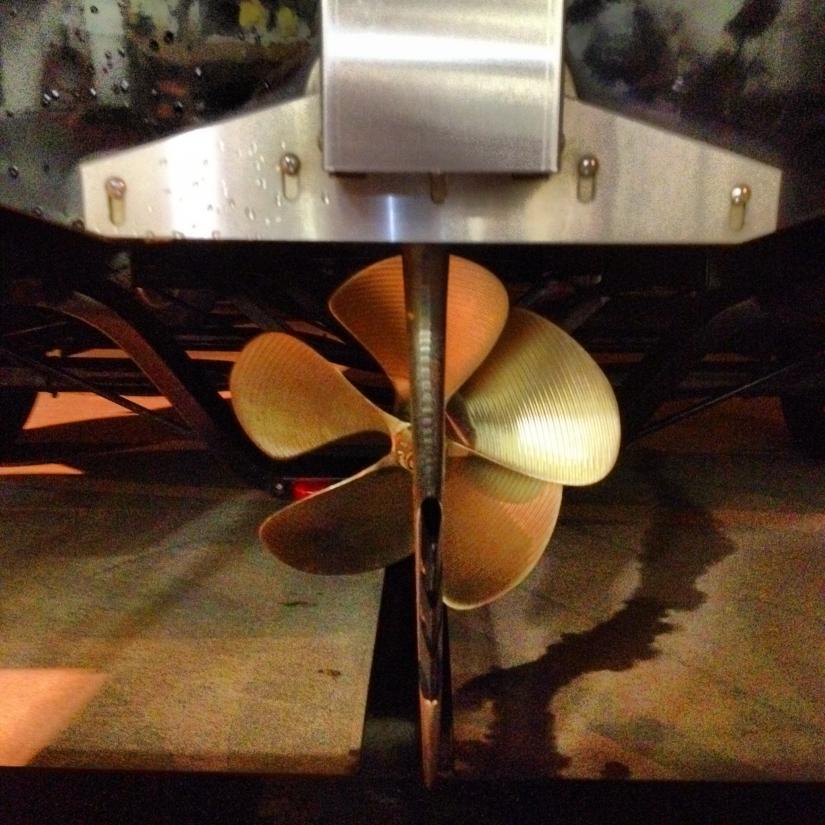

What are the dimensions of that prop? (Diamater, pitch, cup)Originally posted by RogueOne View PostI just put my OJ 1936 on Sunday. I plan to run it Wednesday. I needed something more to push my 3k ballasted 220
[ATTACH=CONFIG]18111[/ATTACH]Current: 2017 G23

OKWakebdr, Sorry for the delay.....I had my dealer call OJ and he spoke with Eric,the designer of the prop. Eric was very close to the chest with specs other than saying that "yes it would work on my boat". There are no spec markings on the prop other than the model 1936. I measured it on my boat, with a very precise tape measureOriginally posted by OKWAKEBDR View PostWhat are the dimensions of that prop? (Diamater, pitch, cup)
, and came up with 13.5" OD and 1 1/8" clearance into the dimple above my prop.
I only ran it for about two hours yesterday surfing and I will say that it is defiantly quicker out of the hole and on a surf plane loaded down with approximately 2400lbs of ballast. I had an anomaly in that it changed my surf wake to longer and slightly taller. I spoke with Eric at OJ briefly and he stated that the possible explanation for the longer is that it changed the angle of my hull by lifting the back up but he could not explain the slightly taller. I did not note the rpm's nor did I get a chance to get up to wakeboard speed with all of my ballast filled...more to come.

Thanks. 13.5" Diameter is the same as the stock Acme 1579, and the only 13.5" 5-blade out there that I'm aware of (although I know Acme is working on one). I'd be curious to know what the pitch is. Since this prop is the same diameter as the 1579, it will be a good apples to apples comparison.Originally posted by RogueOne View PostOKWakebdr, Sorry for the delay.....I had my dealer call OJ and he spoke with Eric,the designer of the prop. Eric was very close to the chest with specs other than saying that "yes it would work on my boat". There are no spec markings on the prop other than the model 1936. I measured it on my boat, with a very precise tape measure

So the OJ posted above is a 13.5" and we need to get RougeONE a 1579 so he can compare the 2 for us. Thinking this 5blade might be the ticket for surfing
