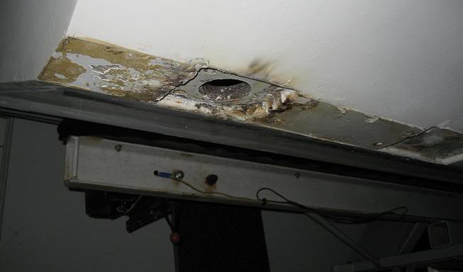

                  Prop burn doesnt happen instantly. It is very real, however.
                  Our BFN had a touch under 1/2" of clearance with the original prop:
                  The rudder and rudder port also took a huge beating.

                      The prop speed is higher on a 1:1, yes- so I could see the potential effects of that difference.
                      No idea about how the boat was used prior to us buying it though- the previous owner was certainly no barefooter! Not even sure if he skied- I sort of doubt it. I have no reason to believe that if we could pull the hrs vs. rpm range (as you can on new PCM's) that it would be atypical of other ski boats. IE, most time is spent below 2k RPM, by a very large margin.
                      I would still be very wary of running minimal (less than 3/4") clearance on any boat for an extended period of time.
