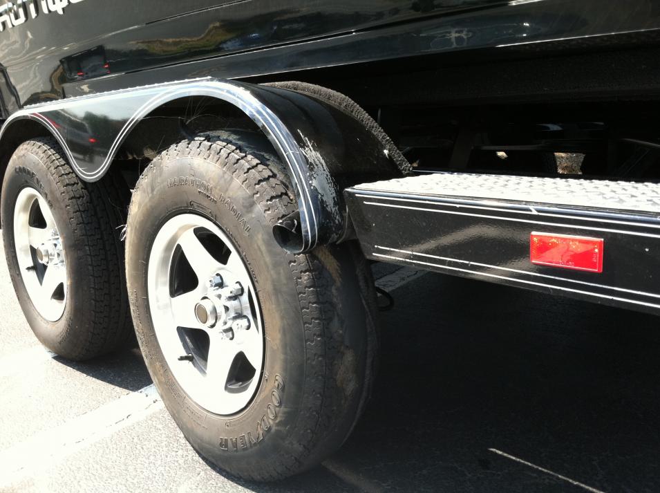

ID:	364089I, like many others on here, learned from experience. My trailer sits in a climate controlled garage all year and I trailer it probably 1000 miles per year. I had changed out the front two tires because of punctures and issues with holding air pressure when they were about 4 years old. I made it another 3 years before I lost both of the rear tires within 30 miles of each other. None of the tires showed any signs of wear - no cracking, no blistering, no wobbling, nothing. Also, when I lost the rear tires they both took out the fenders, I mean curled them up like tin cans ($200 per fender to replace). So my advice, put a date on them and change them on that date (kind of an expiration date) because they will expire and just when you least want it.
