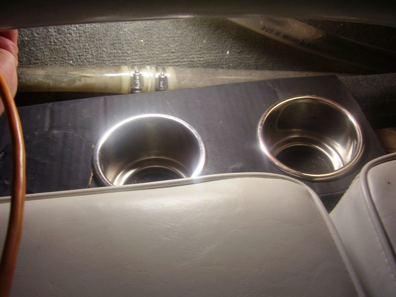

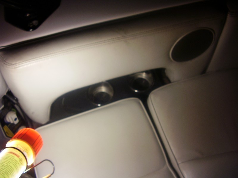

              I can't believe the other Python guys haven't been on here yet asking questions about your boat. Apparently the Pythons are rare enough that you can keep track of them and who owns them.
              Here are my attempts at pics after riding yesterday.

                Good news those white lakes stainless cup holders dropped right into the factory gunwales on my 99 and they look great. The only slight issue was that the one for the spotter seat had a real tight fit to clear the windshield before it popped into place. I was able get it to clear with a little force and now it sits in there perfectly and I didn't scratch the windshield or cup holder in the process.
                Thanks for the pics of your gunwale cup holders. I am defintely going to do something similar to my boat soon.
