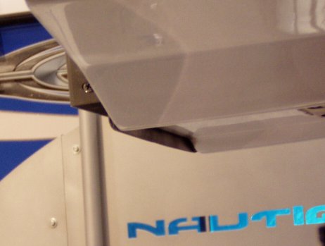

What you are calling the plate is really only the mechanism that moves the plate. The piece youre describing (at an angle vs. flush) has no effect on the wake whatsoever. It is nowhere near the water when the boat is on plane. The functional piece is the plate that slides up and down about 1/2" (or less). It is always flush to the transom, and either acts as a lip/hook at the trailing edge of the hull (slalom mode) or it gets out of the way (trick/jump).Originally posted by jmo View PostHey TRBenj - interesting as my plate is folded up flush against the transom in the slalom mode, and then in trick mode the push rod pushes the plate out at the top so its on an angle, but never extends below the lip of the hull? My observation was with the plate flush it won't affect the wake? I guess that's not the case?
This picture shows what Im talking about. Obviously closed=up and open=down.
Gate down, as viewed from the front:
On dad's '09 196, the effect of the gate at skiing speeds is quite obvious. Try changing the position of the gate at 30+mph. The change in the shape of the rooster is the most obvious visual change- it goes from a defined 3-pronged shape (gate up in trick/jump) to a mushy mess (gate down in slalom mode). It also changes the attitude (running angle) of the boat significantly. The location of where the spray breaks at the chine moves almost 3' aft when you pull the gate up. Both of these things (gate down) improve the slalom wake by 1)knocking the rooster tail down and 2)spreading the weight of the boat over a greater surface area. The latter will make the wake smaller.1990 Ski Nautique
