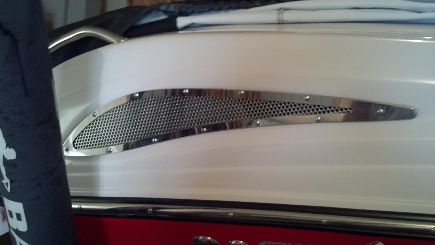

        Originally posted by lztat573 View Post
        On my 2007 211 I cut out a piece of plexiglass the shape of the vent and then cut a smaller hole in the front of it, and it is usually above where the water comes in at now. some times it gets to that point but doesn't fill the boat up as fast. I took the vent cover off and put it under the cover and you can't even see that it is there. I have my cover over it for winter, but if you would like a pic i could get one for you and let you see.
        i would very much like to see a pic of this. please sir.

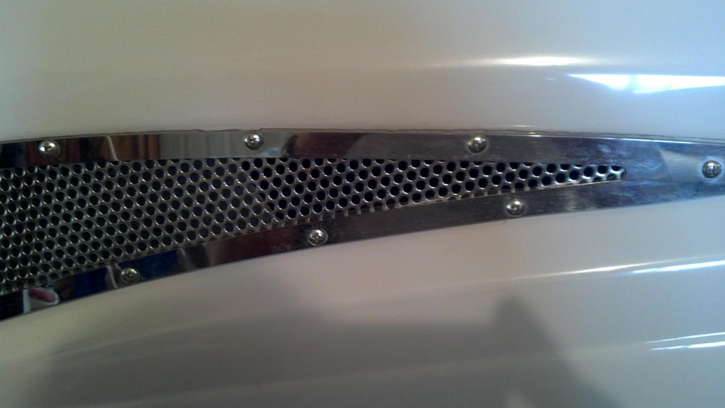

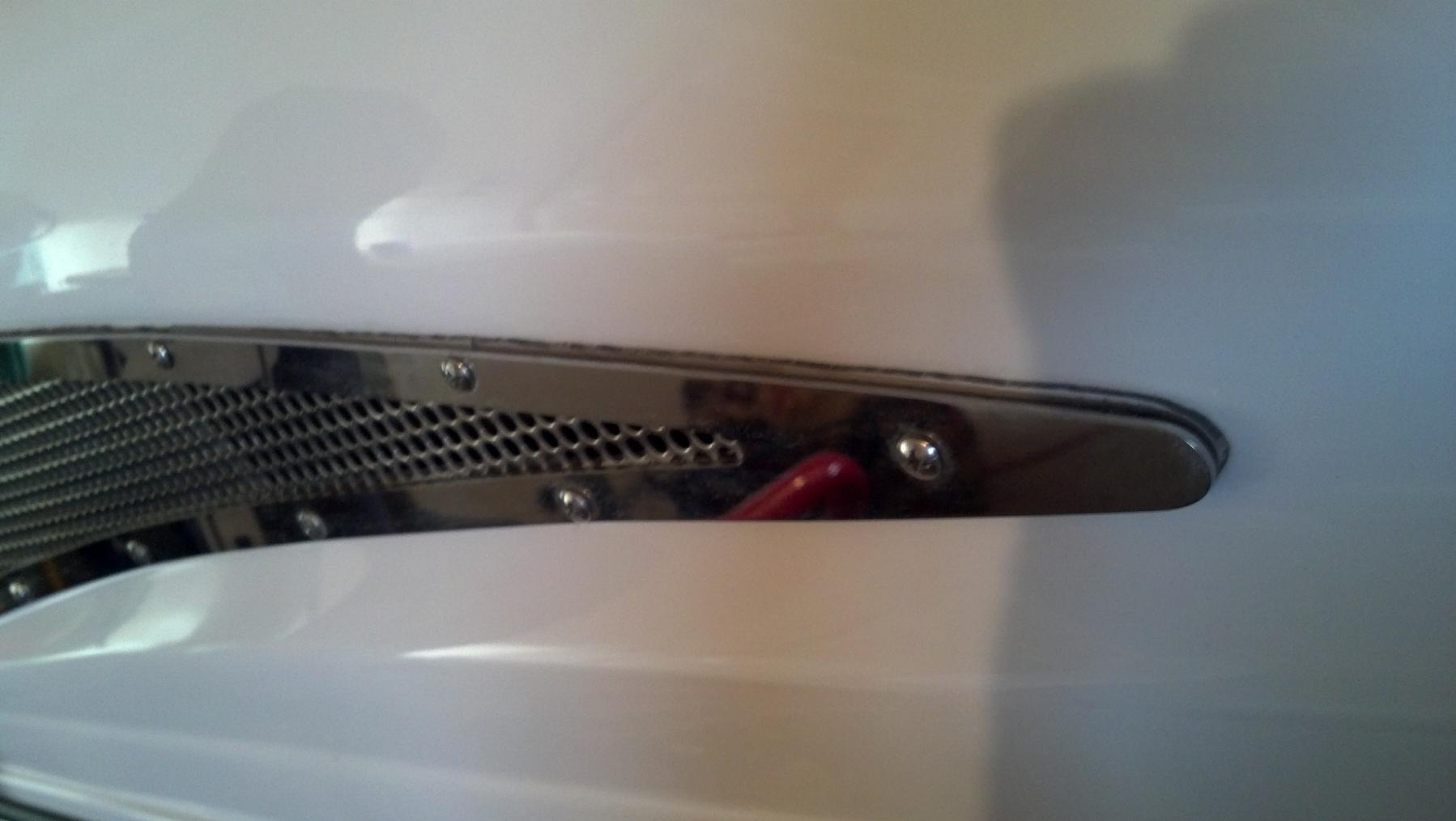

            Here is my vent with the Plexiglass behind. If you need or would like any other pics let me know

              #21
              IS that plexiglass permanent? Do you leave it on all the time? We only surf portside, so would that be enough air just by using the other side?
