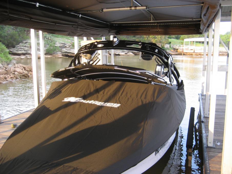

      Had the same issue when we bought our 2011 210. I made some wood wedges out of a 2 X 6 and glued carpet to them. They go in where the factory wedges are. That allows the tower to come down just enough to clear the top of the dock when lifted all the way up. This way we can leave the Z 5 bimini attached at the front. Only the two rear mounts have to be unhooked. Click image for larger version
