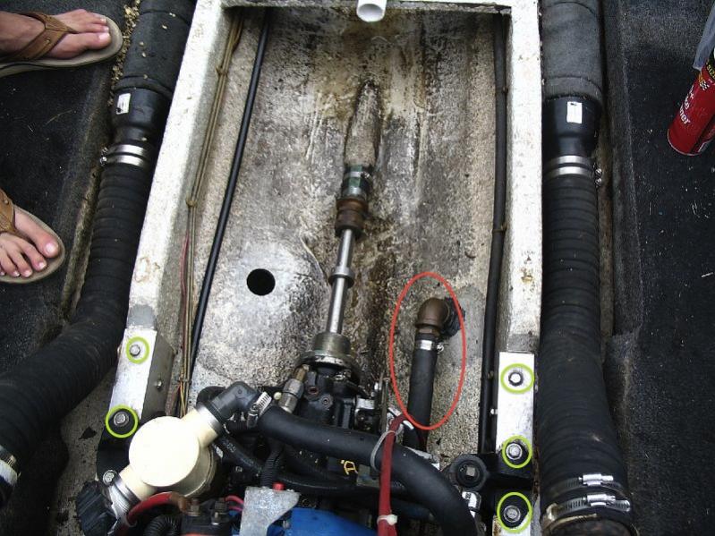

              Is the red circle to intake hose??? If so, it needs to be disconnected from the hull and inserted into a bucket of water???
              • LOOSEMOPAR
                • Oct 2011
                • 8
                • LYNN MASS
                • 1985 SKI NAUTIQUE 2001
                thats the hose
