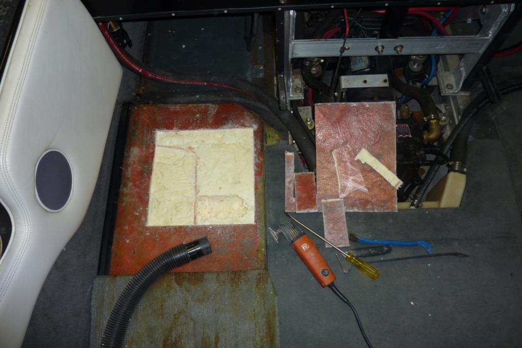

    Referring to this thread by RainDog... http://www.planetnautique.com/vb3/sh...-to-a-2002-SAN

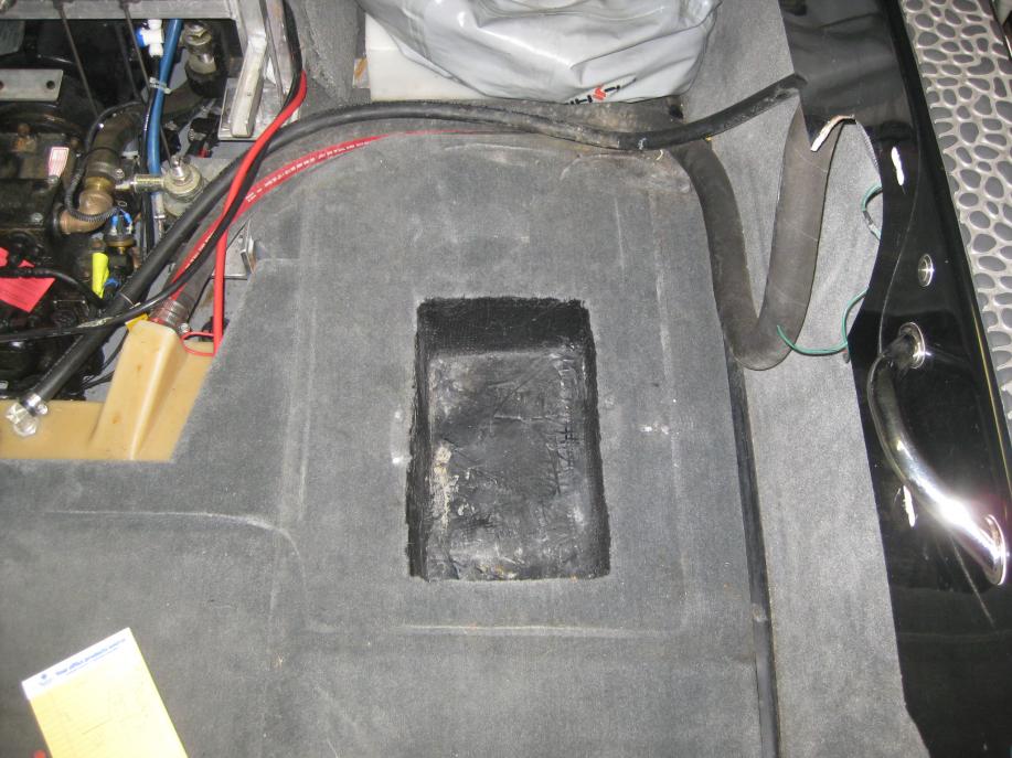

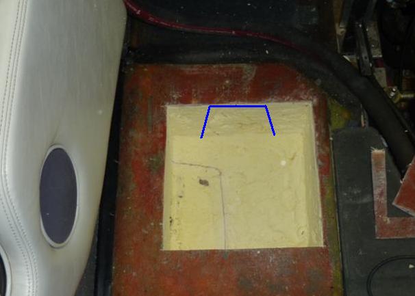

    Has anyone else tried this? I want to enlarge the port side battery compartment to fit 2 batteries and don't really see an issue with it based on RainDog's thread above, but CC's official answer is no because that is a "foam stringer". Since there is already a compartment there from the factory I really don't see any issue with making it larger, but was a bit discouraged when they didn't recommend it. Raindog seems to have disappeared from PN shortly after creating the above thread. Did anyone else ever try this?

    The question becomes what is underneath the floor, adjacent to the battery box that youre trying to expand. Cutting into the foam beneath the floor is no big deal if thats all there is... but if that box is up against a stringer, forget it. Thats not something you should be cutting into. You'll want to start slow with small cuts and poke around at whats under there, just like Steve did. If all you find is foam, youre golden. If you find a fiberglass stringer, then avoid it.

      Well the way the engineering dept. at CC put it, the foam is a stringer for that area becoming a structural part. I kinda call BS on this or else they would not have cut a cavity there for the battery to go in the first place. Based on RainDog's thread I don't think there is anything in that spot but foam, but I'm still a little worried because he cut the starboard side and not the port. That is why I called CC to make sure it was just foam. I think I will just go for it and fix whatever I find if it's something I don't like.

        Im wondering if something was lost in translation from the CC engineering department. The stringers are foam filled fiberglass, but based on Raindog's pictures, I dont see any in that area. The hull-foam-floor sandwich certainly lends some rigidity, but you wouldnt be losing much (if any) strength if you simply cut out the floor and build a nice glass box, as Raindog did. I wouldnt go cutting into any longitudinal structural members (stringers) though.

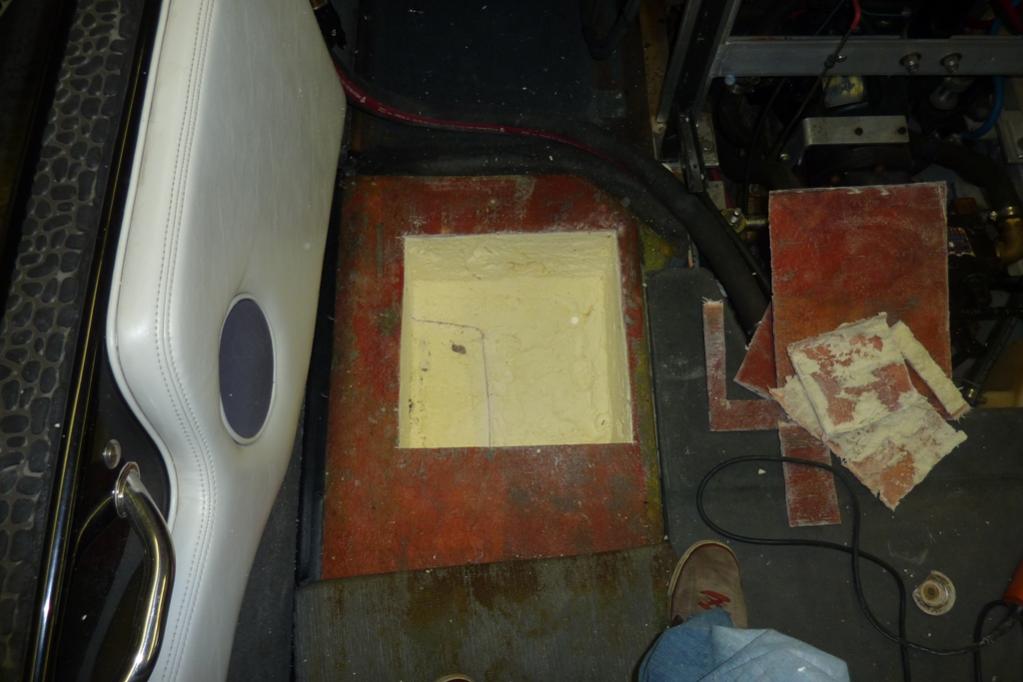

            I get what you're saying DanielC, and CC engineers saw RainDog's pics so I think they understand where I want to cut. The changes you talk about are what have me slightly worried. In the 2 pics below you can see what looks to be a thin fiberglass divider both before and after he removed the foam telling me it went from the finished floor level down to the bottom of the hull more than likely. Granted it could just be a divider because I don't think that one thin piece would serve as any real structure, but I don't really know what I will run into.
            The true stringer that runs the length of the boat is just to the right of where he cut holding the drivetrain assembly in place and on either side of the fuel tank/ballast tank, etc. Even CC told me this, but went on to say they didn't advise cutting into the area I want to. I really think they are just covering themselves, which is understandable. This is along with a Winter project stereo mod so I still have time to research and grow a pair before I start hacking away.

              Unless the pocket youre cutting into the floor is narrower than the stringer, then I dont see the risk in failing to recognize that you just cut into a stringer. Of course, you would only recognize this after the fact... but you'd know it. I would expect to see something like this once you were done cutting:

                Okay, finally found what I was looking for. It is done to an '02 model, but I think they will be close enough to one another.
                http://www.planetnautique.com/vb3/sh...ox-enlargement

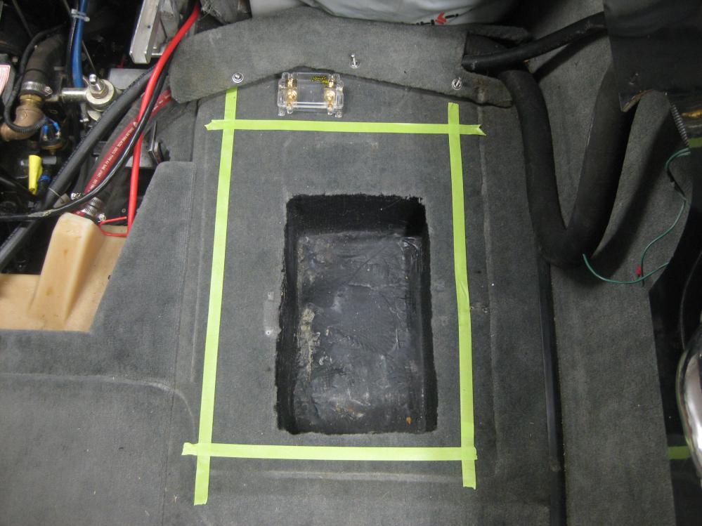

                    I get where you are coming from DanielC, but I'm not making a new cavity... I'm enlarging what is already there. I will not cut into the main stringers at all. With the exception of there being a little less foam I'm not changing anything about the overall construction of the area. I laid it out in tape last night to get a better idea of what it will look like. You can see in the pics below what I'm going to do. The inside of the tape lines will mark the edges of the new cavity. I made it large enough to hold 2 - Group 27 batteries. Is there a slight possibility I could completely ruin my boat? Sure, but I think I've do enough research and know what I'm getting myself into. If it does go wrong I only have myself to blame. If it goes right I get more battery capacity in an excellent location without any bad outcomes. I will take many pics and this will become part of my write up for my stereo project that caused all this in the first place.

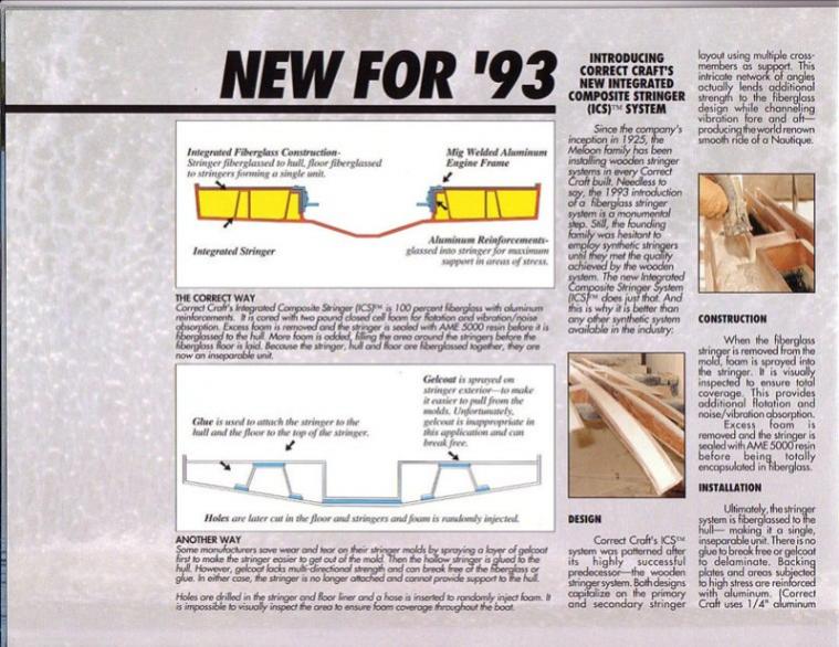

                      Looks like CC have revised how they do the ICS over the years in the early years they were more like the conventional stringers that TRBenj was indicating. These picture from the 98 brochure show the stringer more like the large box that DanielC was explaining. This design looks to be a much thinner section of fibreglass over a large area where the foam would be playing a huge part in its structural integrity.
