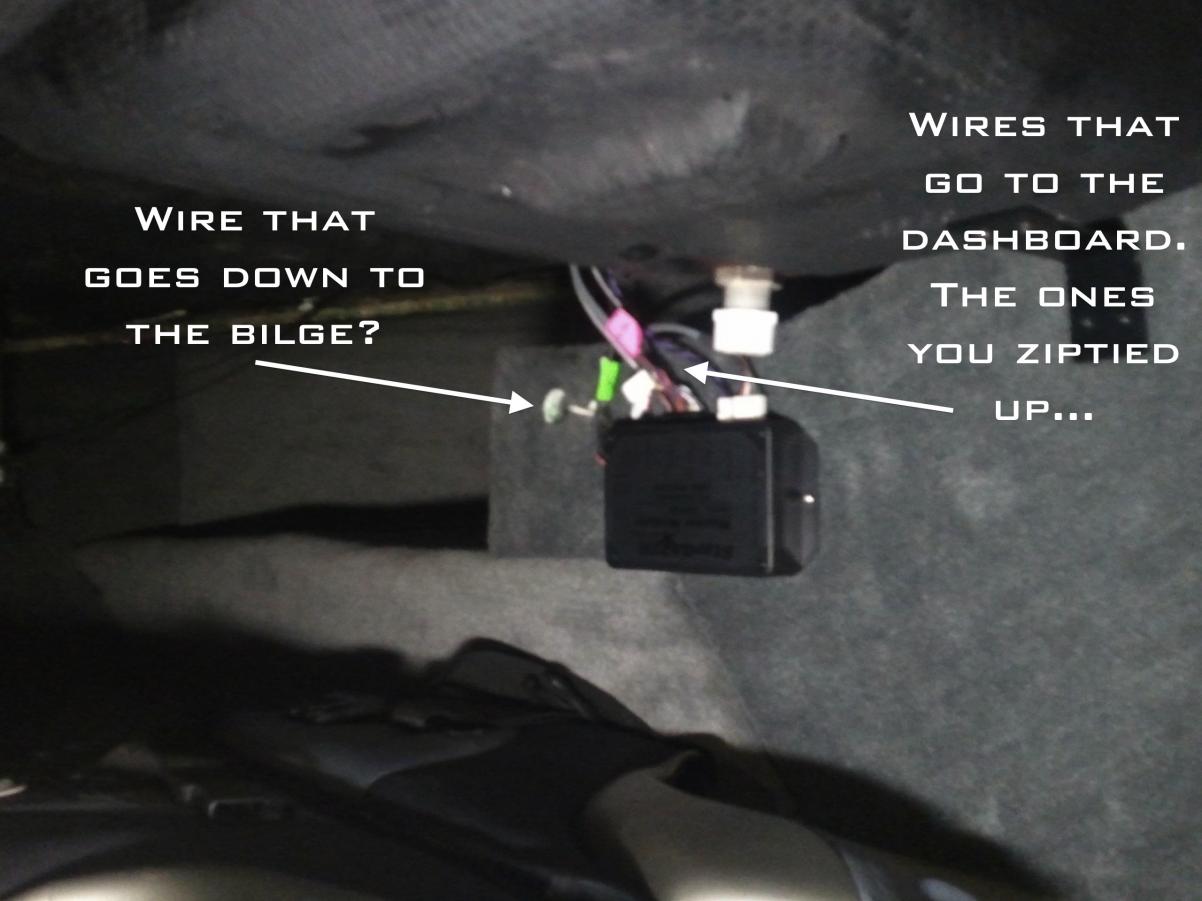

                      #25
                      Thank you so much! Yours looks very good. Do you like the Perfect Pass gauge on the right better then the left?
                      Also, can you verify i have the picture below right...

                        #26
                        The wire the goes down to the bilge is the furthest on the right. It actually just loops over and there is the hole that goes down. The holes that you see are where the pipes for the glove box drain used to be. I removed those and capped them. I have the pull rope tied through the holes. The rest of the wires, you are correct, just go in a bundle up to the dash.
                        Many people prefer the gauge on the right. I think it has to do with most people are right handed and that you can remove you hand from the throttle and press buttons while keeping a hand on the steering wheel. I think it is easier to access that way as well. I would have to reach my hand over the wheel to adjust if it was installed on the left. You can simply swtich you good speedometer to the other side during the install while keeping the left side pilot tube so it won't clog.

                          #27
                          Ok, now i understand. Because i was wondering where the drain tube was for a minute.
                          And thats what i was planning on doing. Switching them over. so Analog on the left and PP on the right

                            #28
                            Is it alot easer to feed the wires down the tube from the drain tube area like you did? Also, on the bottom of the floor, to the right of the engine, is were all the wires are running. They are all in tubes as well. Is it ok to just put the wires there??? Do you have a pic of were the wires run? This is the only part were im lost.

                              #29
                              You will need to feed the wires down the hold behind the driver kick panel. That is the only way. The will come out on the right side of the bilge right next to the other wires that run from the dash. Just crawl under the bow with a flash light a look around. That is how I learned. I removed the driver kick panel when I was running the fish wire for the servo wire, it gave me a lot my room and light. I have attached several pictures from under my bow of how all my components are laid out. Sorry for the blurry pictures, not much light under there...
