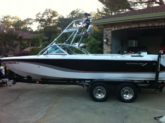

              How about some pics of the new ride?!

                Ill get some picks up next time i get it out, its garage kept and a tight fit to say the lest!

                  Heres the new ride

                    Sorry for the pic, ill get some better ones!

                      Congradulations on the new ride.
