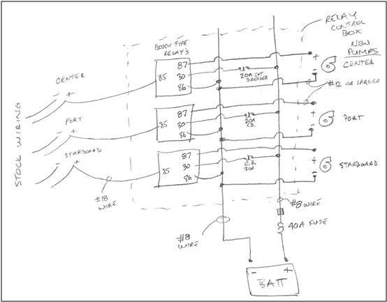

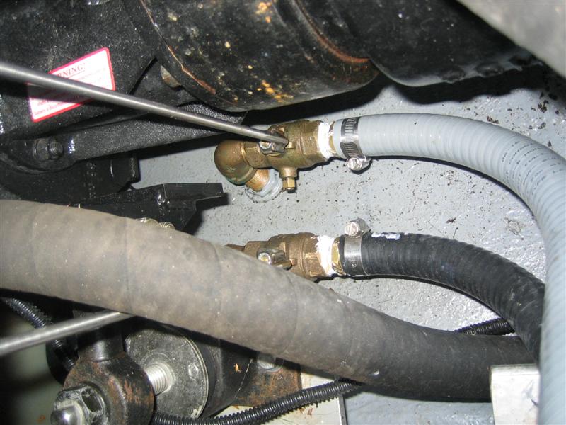

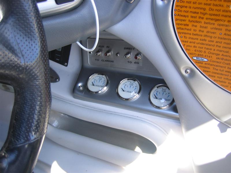

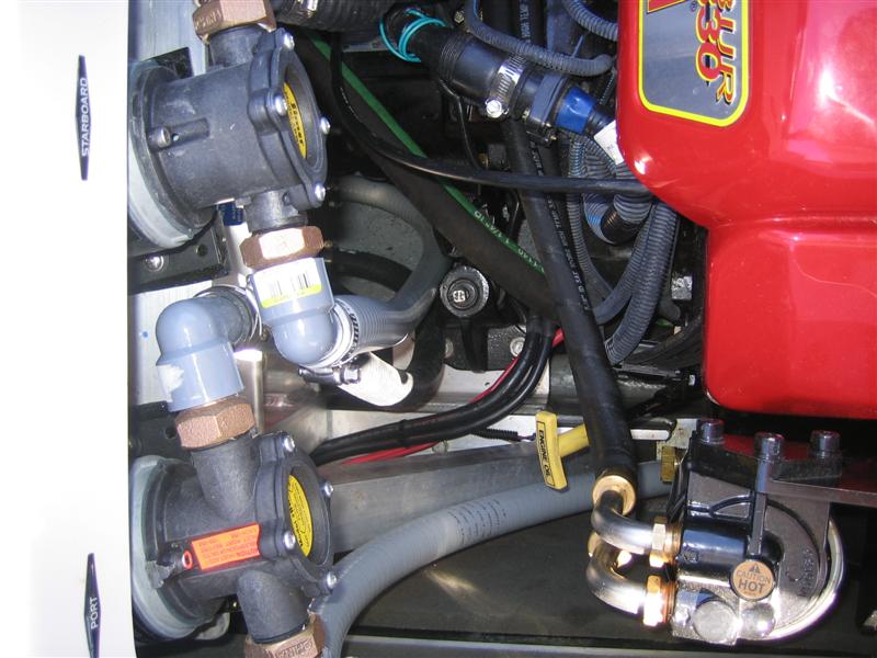

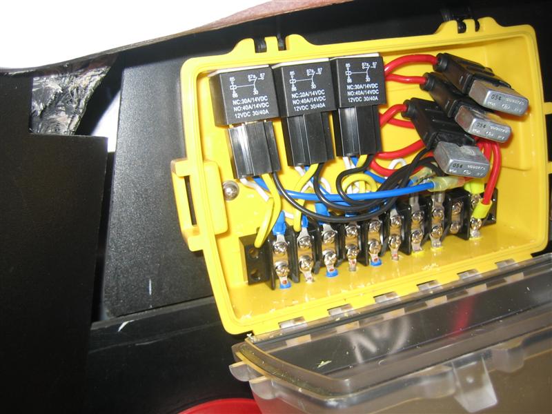

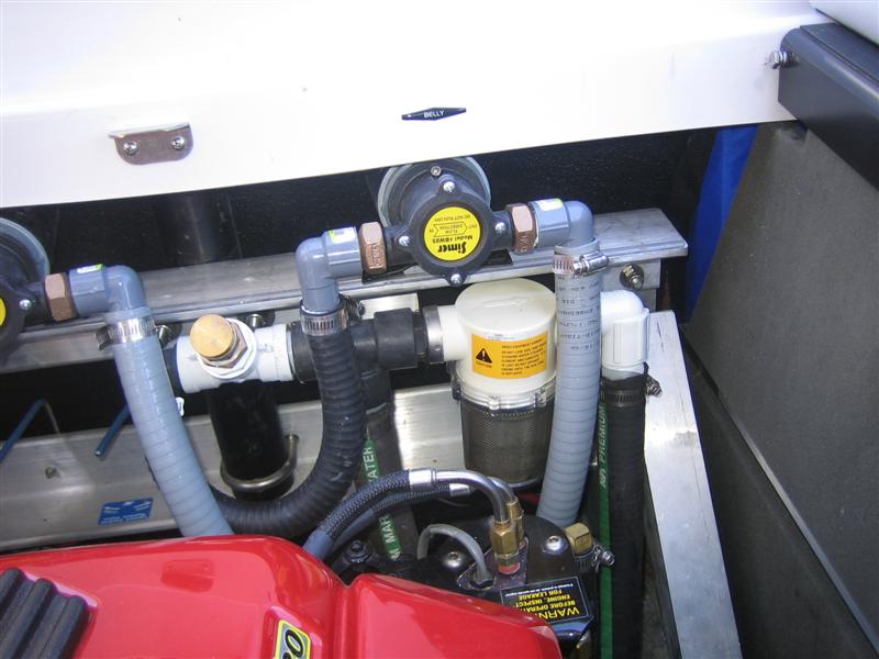

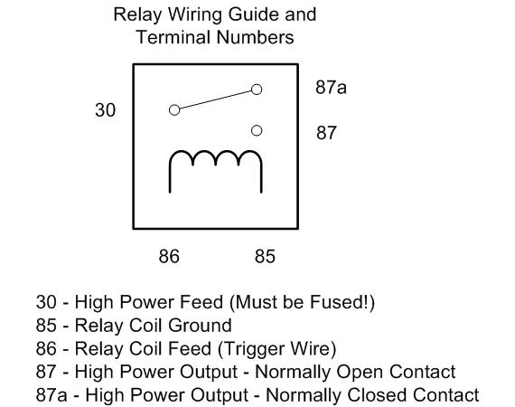

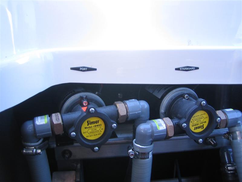

                  Warning! the following post contains pictures of pumps that are not ignition protected installed in the motor compartment. Do not do this unless you are willing to risk death and dismemberment as the boat will surely explode.
                  That said, I am comfortable with my installation and I recommend you duplicate what I have done except you use ignition protected pumps like the Jabsco Ballast Puppy or the Johnson Ultra Ballast pumps. I already have one Jabsco and one Johnson, once I get a third I will make the conversion over to ignition protected pumps. For now it works and I would rather spend my very limited free time boarding so it will stay like this for this summer.
                  The system is on the third summer and the impellers are leaking a bit due to the pressure from the scoops at slalom speeds. I have the new impellers in a bag ready to go in but back to that time issue... For now I just either turn those manual valves off or just run the empty pumps (they are aerators so they can run for the entire duration of my slalom run without issue, at least they have done so until now, I am still using the original empty pumps). My system is free of valves except for the manual ball valves. It still sprays water out of the side when emptying the tanks since I am using my factory drain systems. I replaced the stock valve handles with a audio system input/output access panel.
