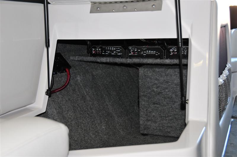

            See the attached photo for the location of my sub box.
            I put rubber feet on the bottom of the box to keep it off the carpet in case any water flowed through that area.
            I then bought two Simpson Tie-Down L-Brackets at Lowes or HD and painted them black. I placed them so that the vertical portion of the L was against the sub and the horizontal was against the floor. I put one bracket on the front of the sub and one on the rear. Each side of the L had 4 holes--I screwed #8 (IIRC) screws through those holes to hold the sub in place. The screws are probably only 3/4"...maybe 1".
            I've haven't had a problem with the sub coming loose...and, in fact, it was pretty difficult to drill into the floor.
