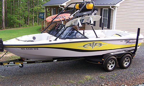

        If im not mistaken...after seeing that pic...it sure looks like that is for a V-Drive boat.
        Fenders are way to close to the back of the trailer for it to be the standard direct drive trailer.
        Yea...looking at more pics of others...I'm sure that trailer is for the V-Drive 216 Nautiques.
        EDIT: I may be wrong...still looking at other Nautiques on their trailers. It just seems that Ramlin had two options...V-Drive and D-Drive and that they were significantly different.
            Here's one I found...which negates my previous comment. This is just like your trailer with a direct drive 216 sitting on it...hmmm weird for sure.

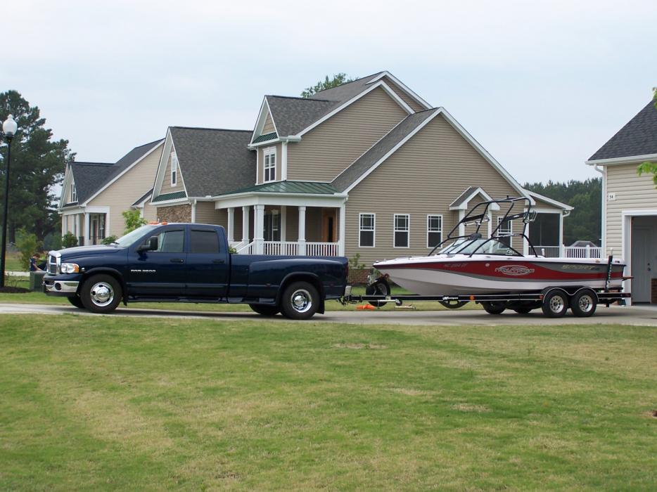

                          Agree with skiinxs. You need 9% - 15% of GVWR on a tandem axle trailer. 10% - 15% on a single axle. Also agree that minimum 18" hitch height hooked and loaded is right. Here's my 216 on a prestige.
