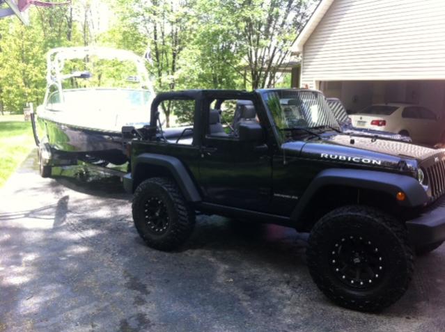

                              I was hoping to see the boat in pic 2.
