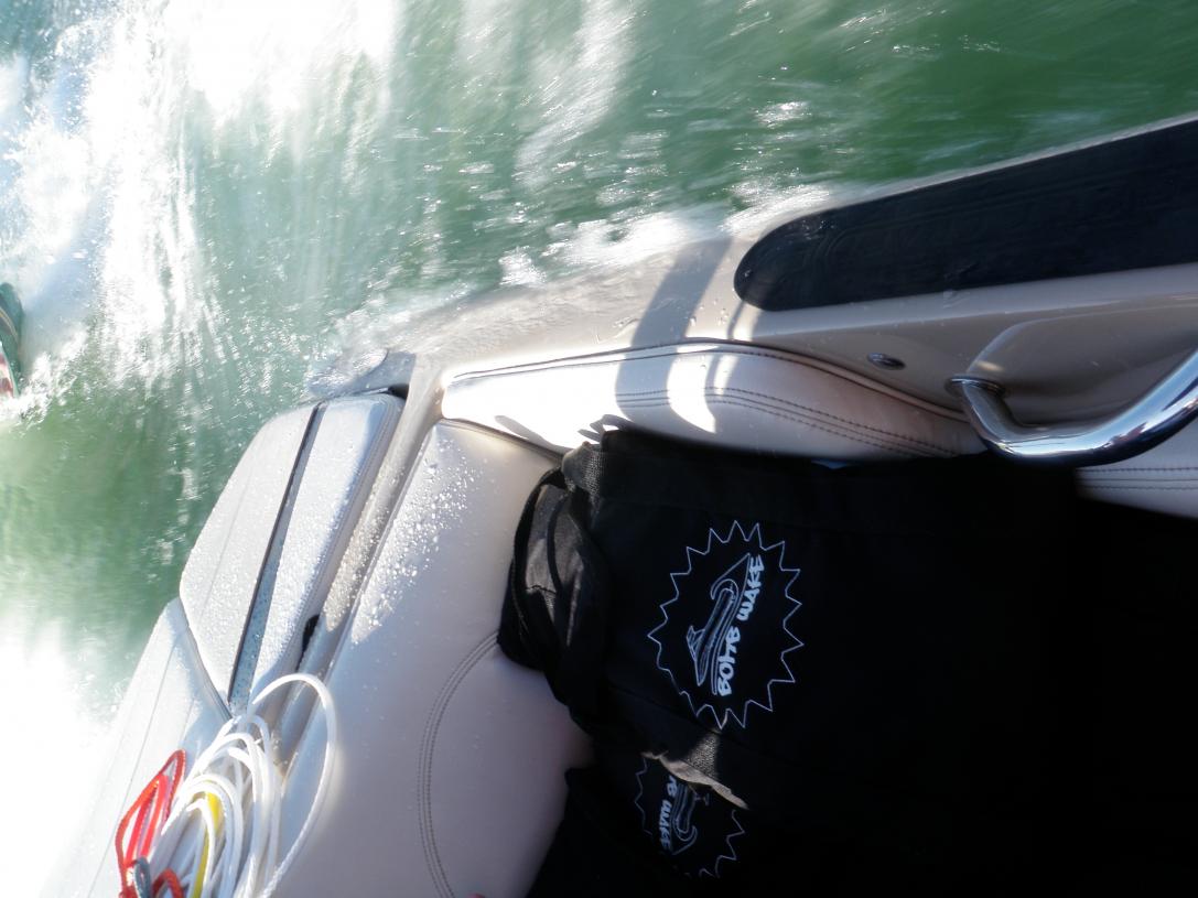

                I am trying to remember which pics correspond to which weights I was experimenting with at the time. This year I am going to keep a journal to keep it straight, plus also picked up a go pro video and still shot camera to mount directly to the transom, place on a pole to hold outside the wake, etc. for hopefully some interesting shots.
                Couple of things which I remember from the pictures: if you look at some of the larger waves, you will notice that the face is a bit more choppy and the rider has less room to maneuver on the face of hte wave, definitely not optimal. The best waves in this photo set are smaller, but the rider has a good ten to fifteen feet of maneuverability. I am pushing about 190-200, but can still ride a thin 4'5" fish with plenty of power to hit the lip and pull 360s. Airs so far have been my nemesis. The picture with the corner of the boat sunk deep enough to cover a portion of the V-drive compartment was also the session i got water into the fuel vent. Interesting picture, less that interesting result. I will look on my computer for any other pictures
