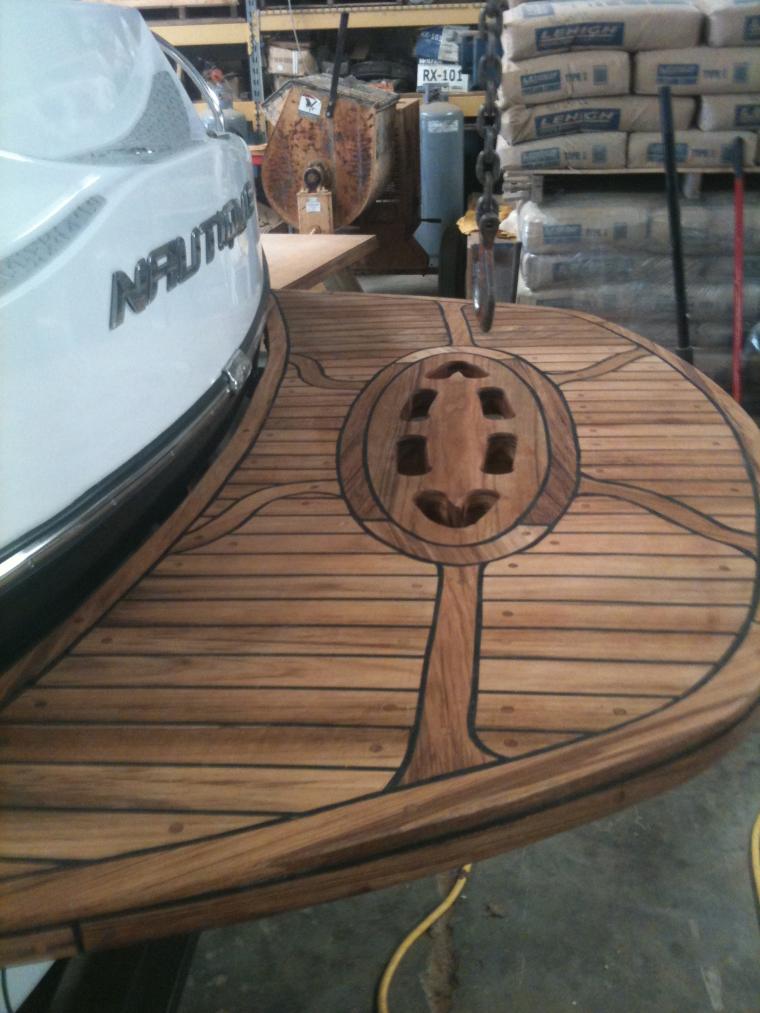

I say Teak it out!!! Maybe CC will take notice. Love it anywhere I can get it.Originally posted by 210GA View PostOk... So I've really gone bananas with the teak lately and now decided to do the other SANO pad areas.

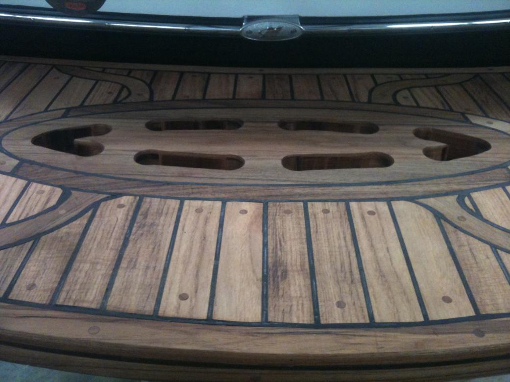

What do you think about this area? Of course it will have the black lines in the grooves and around the edges.2005 SV-211

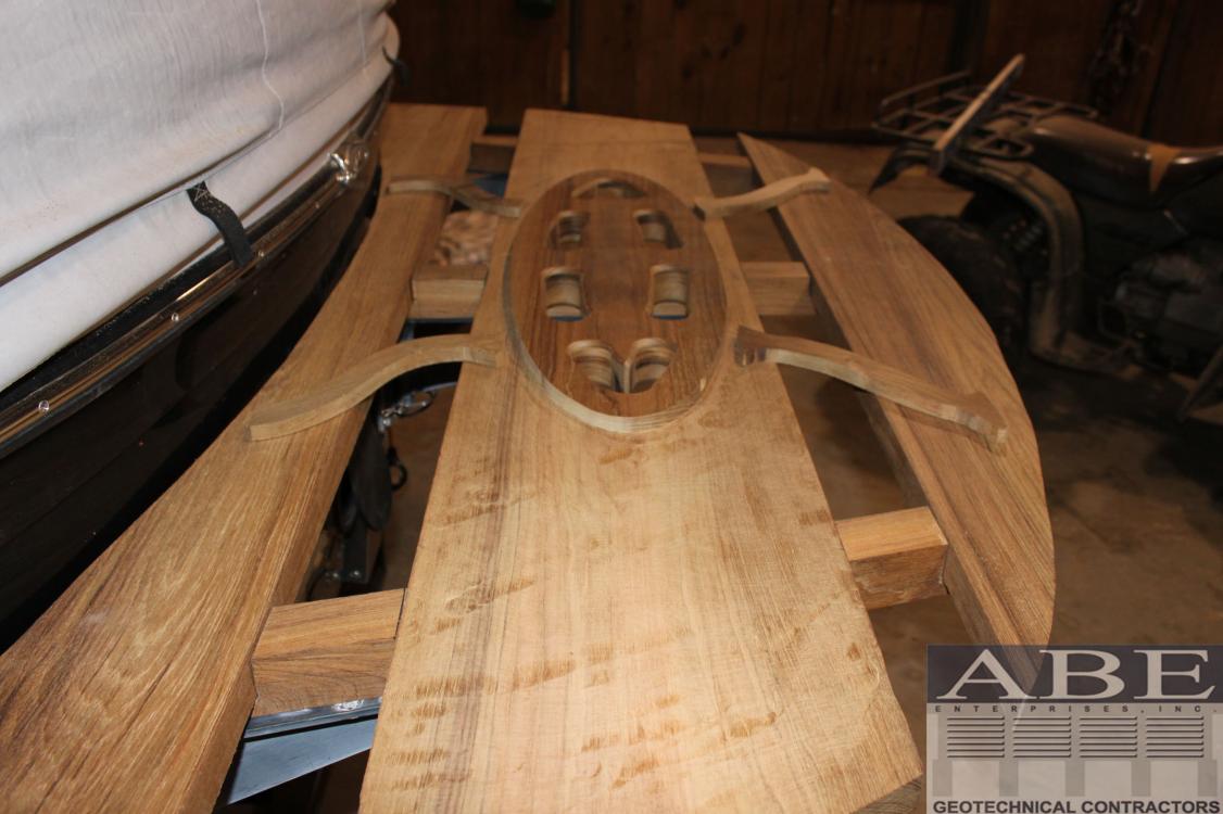

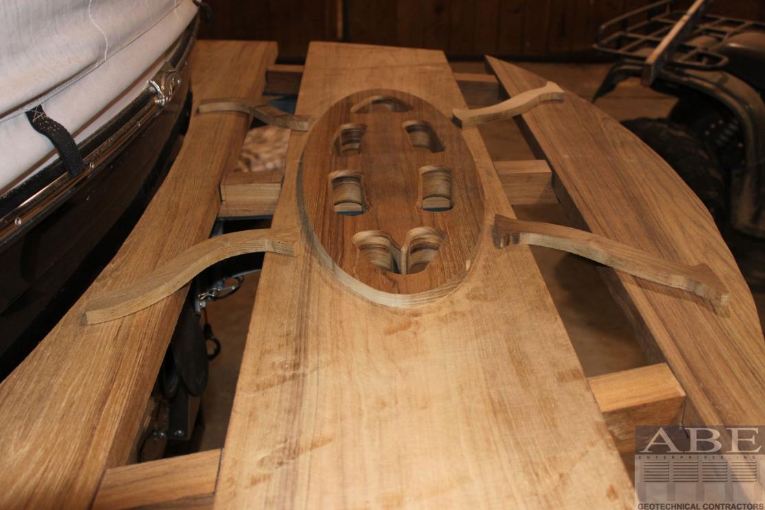

The bottom view is nothing and can't tell anything, it's just solid and flat and ugly where I had to patch. What we did was run a 3" thick (from top to bottom looking at it from the side) piece of solid teak from the back of the brace all the way out to about 2" from the tip of the platform. That piece of teak is only as wide as the bracket. Then we cut a grove in each one of the big pieces (from the first pictures) and enset them. This way in the open spaces we could secure the platfrom from two different angle, from the bottom side in the factory holds and from the side all the way down.
Sounds funky but I will get some more pictures Friday which may show how we did it.

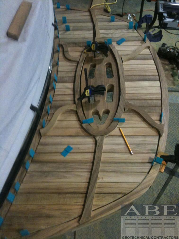

are most of those slats just grooves in the big chunk? or are they seperate slats you screwed to support underneath? not sure if that question makes sense. I see what you did to attach it to the brackets, very cool. i am wondering how you attached all those intricate pieces in the middle. is it a solid piece underneath that you screwed them to? sorry for all the questions, I love it.
It's an extra board, cut thin.Originally posted by swooddc View Postare most of those slats just grooves in the big chunk? or are they seperate slats you screwed to support underneath? not sure if that question makes sense. I see what you did to attach it to the brackets, very cool. i am wondering how you attached all those intricate pieces in the middle. is it a solid piece underneath that you screwed them to? sorry for all the questions, I love it.
Look at the picture attached, Platform-05 copy.jpg and Platform-03 copy.jpg2 ,that is how it was built with support. The center hole, the one with the design, is part of the original piece of wood. We made the design in the middle then planed the board down to the design area. Once that was done and everything was tied in, meaning all the edges were in place and nothing could no longer be changed as fair as length and width goes, we placed panels in between the boards.
We then cut 3/4" pieces, after they were planed down, to fit around each one of the cut out designs. See the picture named Platform-06 copy.jpg (maybe 4th picture) That is a flat piece, we just run a table saw down the board every inch or so wide about 1/4" deep so we could later lay in that black epoxy for ascetics.
We then cut 3/4" pieces, after they were plained down, to fit around each one of the cut out desgins. See the picture named Platform-06 copy.jpg (maybe 4th picture) That is a flat piece, we just run a table saw down the board every inch or so wide about 1/4" deep so we could later lay in that black epoxy for athetics.

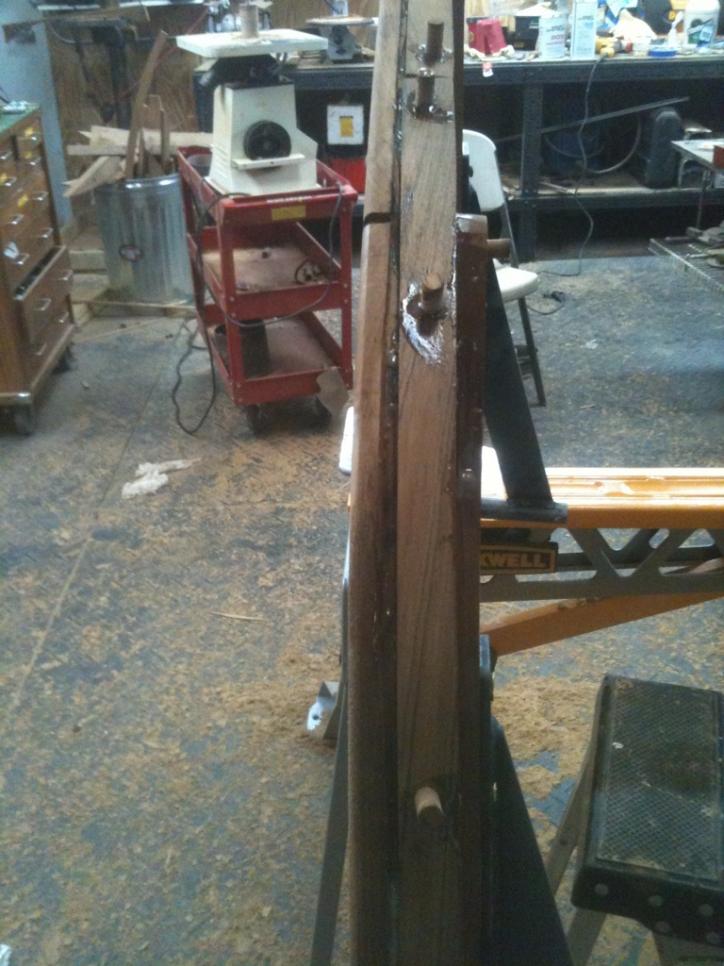

Looking at the final picture, do you see all those little holes in each section? Those are screw holes just covered up with little bungholes of wood and glued in.Last edited by 210GA; 04-20-2011, 10:20 AM.
