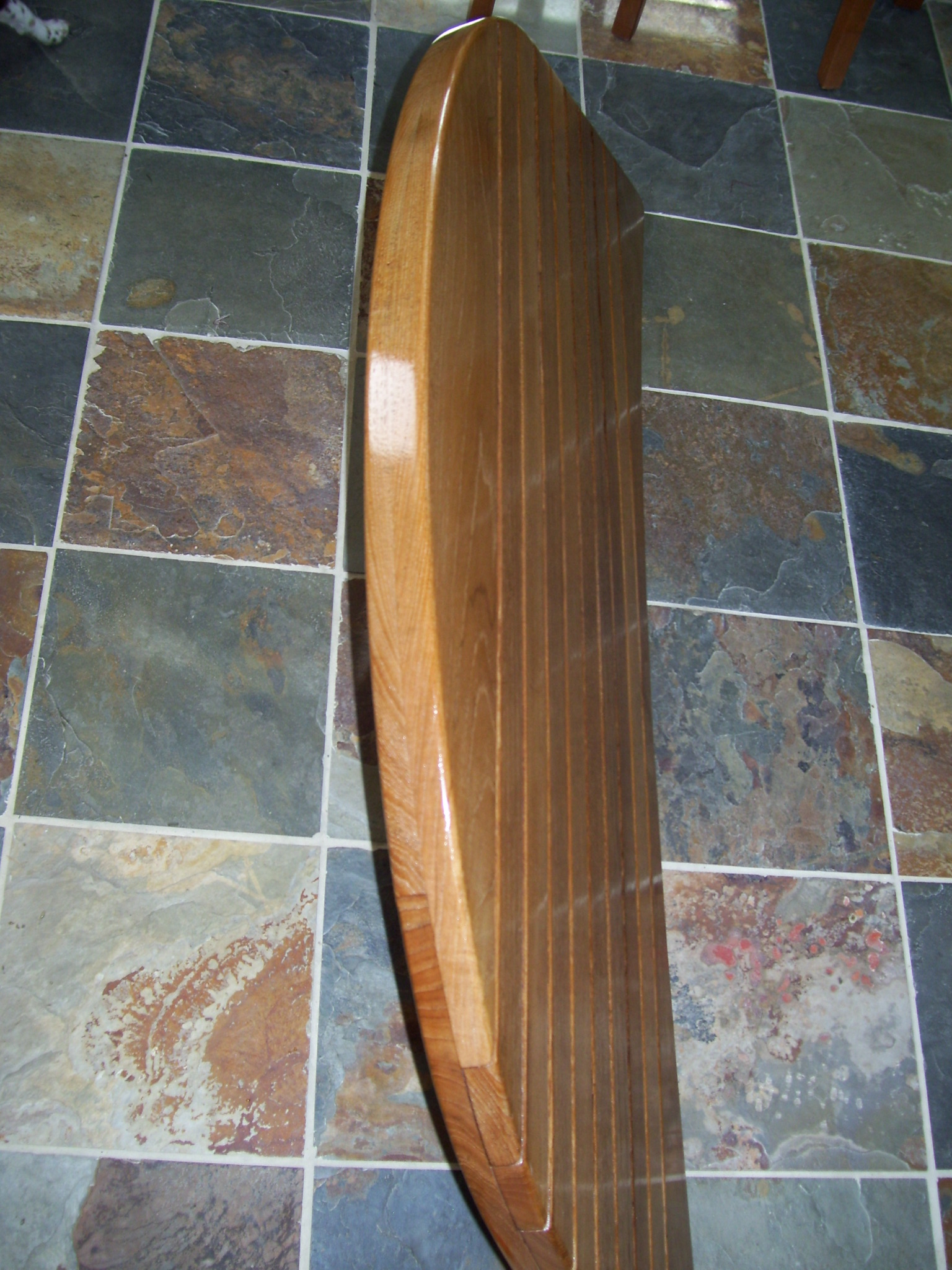

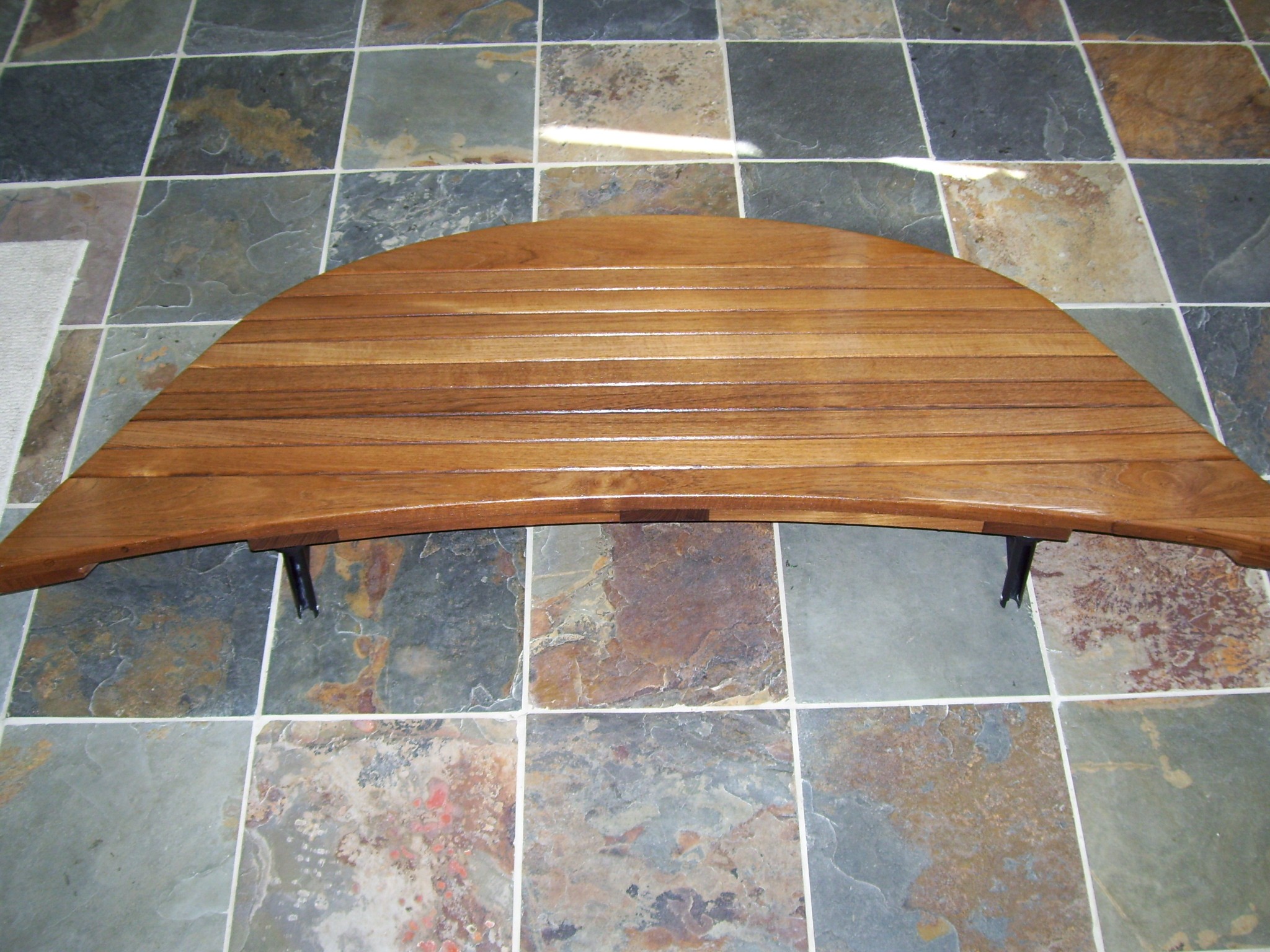

A light sanding and two coats of oil with about a week long drying period between coats is usually plenty to get me through the season. The platform will have a scuff or two on it from skiers putting their skis on on it, but there is no graying.
Just reinstalled mine after my once per year maintenance.
