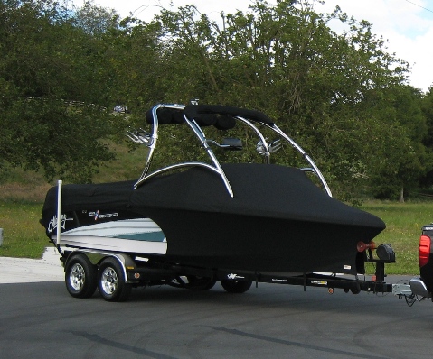

    Tow weight 08 210 on Ramlin trailer?
    Can anyone tell me what the total weight of this rig is? Looking at a new new tow wagon but want to make sure it will be suitable before pulling the trigger. Thanks!

    Fully equipped and full of fuel 5500-6000 lbs.

      Thanks, is this correct? my dealer today told me around 4700lb??

        My Ramlin tandem axle trailer weighs 1340 lbs, the dry weight of your 210 is around 3800 lbs, that's 5140 lbs already not counting fuel. With a full tank of gas and gear I'd say Nautiquehunter is dead on.
          That's an awesome tow cover you have. Where'd you get it? Was it custom made? I see a couple logos on it so I'm figuring it must be.

            I have an 05 SANTE with a Ram-lin Tandem axle trailer that I weighed at the end of the summer. Boat trailer and a 1/2 tank of gas was 5600lbs.
              Hey Brian, yes it's a custom tow cover made for my 210 down here in New Zealand. If you would like some more detailed pics let me know.
              And thanks all for you feedback on the weight of my rig..looks like I will have to re-think my next vehicle purchase.
