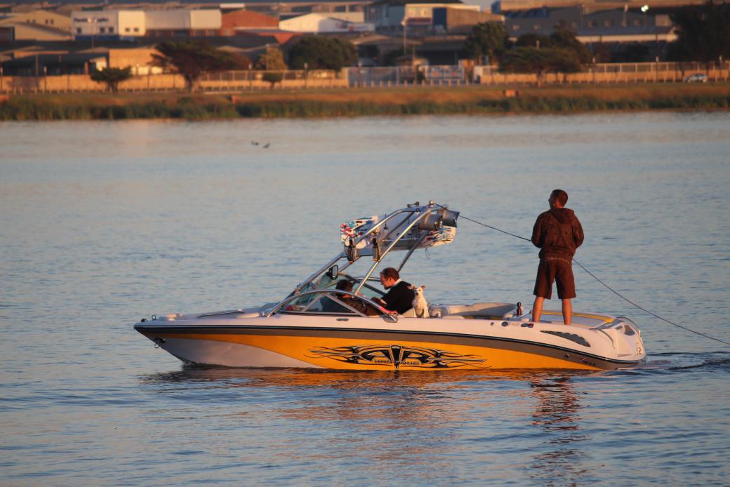

                I Just recently purchased a 2008 SV 211 team edition, and I Love It!!! Amazing boat!
                But we also have blower issues. it keeps tripping the circuit breaker. It hasn't stopped us from using the boat, but i would like to sort is out. where would you reckon i should start looking?
                The problems with my rig is definitely as a result of the previous owner. it was used in salt water and not looked after(mechanically and electrically at least) very well.
                She's running sweet but needs a good clean!
                So far i have replaced the docking lights and I'm busy with the Zero Off GPS module but other than that she's a beaut of a boat!
                Heres a Pic.

                  Nice looking boat, congrats! You might get better luck solving your blower problem by starting a new thread in the Maintenance and Technical Discussion or trying a site search. It's probably a wiring issue or maybe there is a lot of corrosion in the blower motor and it can't spin freely enough. When the blower is working does it sound like it is spinning smooth or is it squeaky and rough? If the latter you can try spraying some WD40 in there to free it up but more than likely it will need to be replaced shortly. Good luck!
