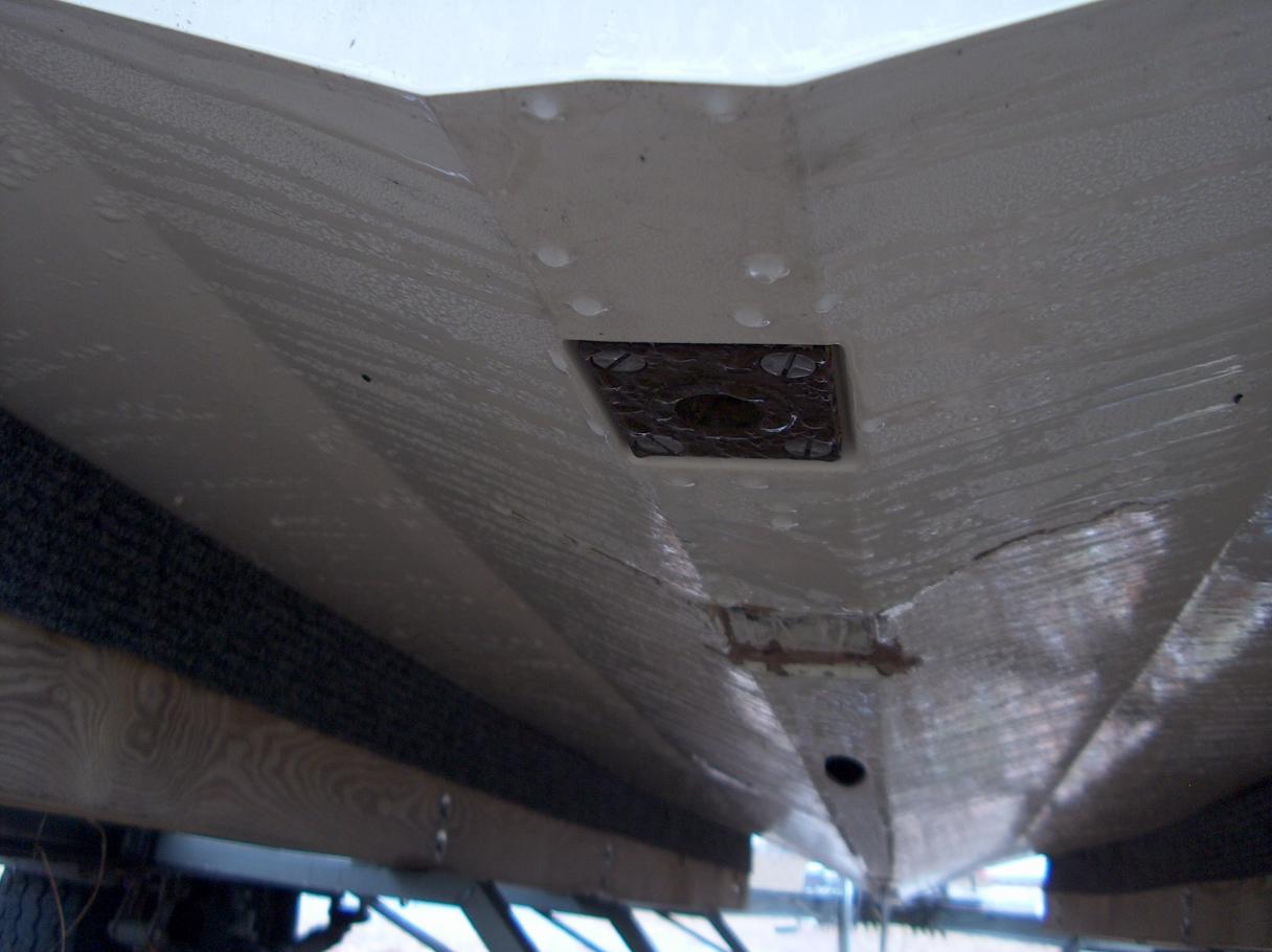

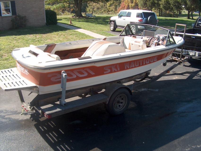

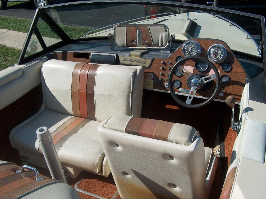

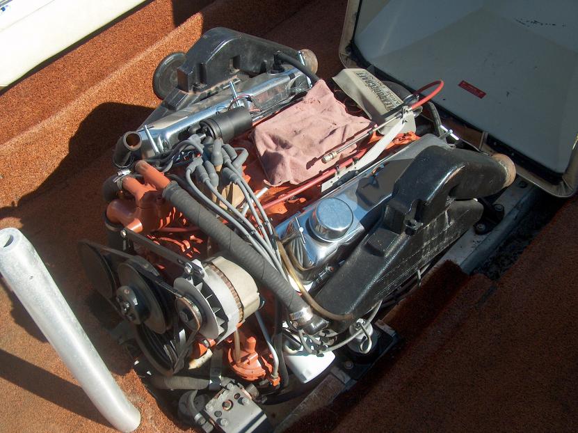

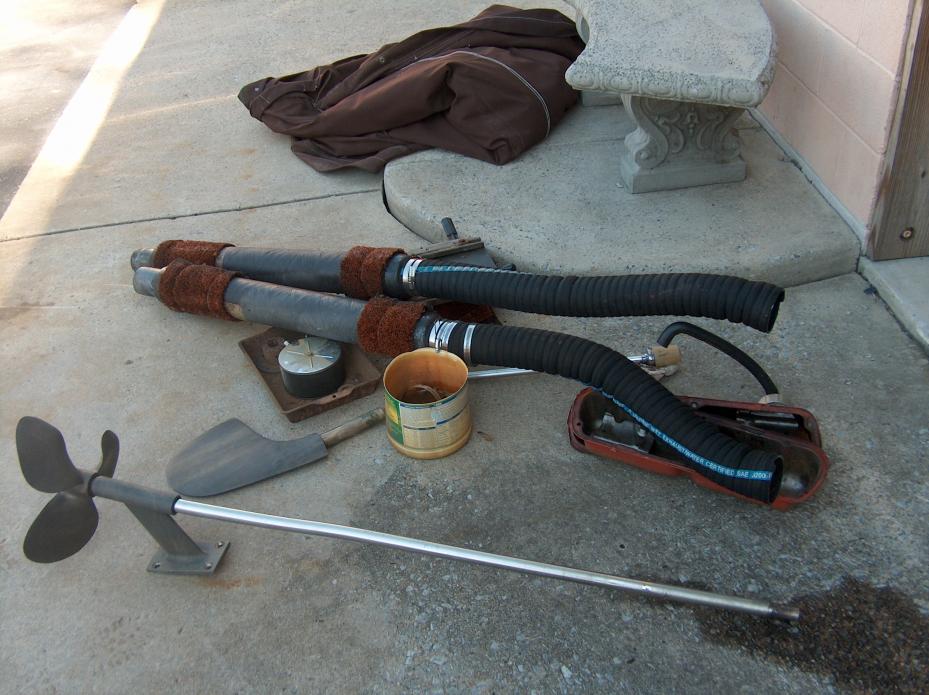

                ok i talked to him more about the boat, has good compression, floor is good, here are some pics

                  Is that a crack in the hull where the strut mounts?? Eeek!
                  • illvizions80
                    • Oct 2010
                    • 4
                    is that a bad thing?

                      Yes. I would walk away, especially if you are unfamiliar with fixing/working on boats.
                      • swc5150
                        • 2240
                        • Eau Claire, WI
                        • MasterCraft Prostar
                        I think PN member had an insurance company total out his brand new 2010 SAN230 for a smaller crack than that by the strut or rudder mount. Don't walk away, run!

                          If I were going to part out this boat, I would offer maybe $900.00. If that is a crack, which appears to transverse the bottom, that hull is no good..... There might be some places that would specialize in fixing, but I doubt it.

                            That hull can be fixed but there is no way I would touch this boat. Keep looking, you will find a good one.
