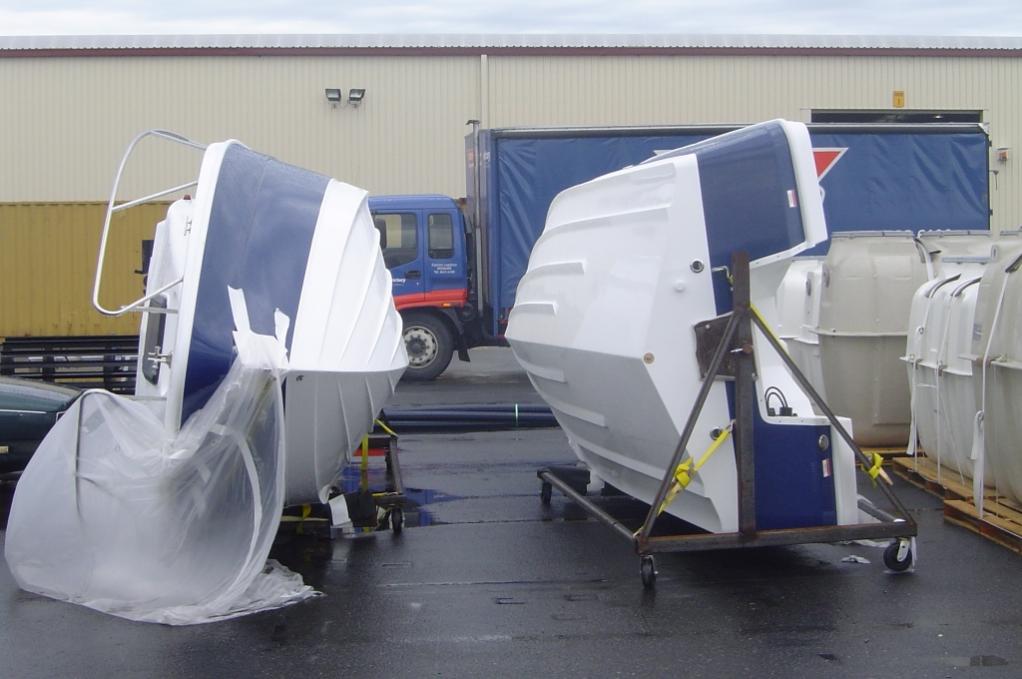

                Containers are 7'8 ½" internally 92.5" so the 91" beam is fine. The trouble is the trailer will not fit. They need to have the wheels, axles and guards removed. You will also need to cut the side steps off the trailer. How this is done makes are big difference in how easy they are to weld back on. They drag and push the trailer in the container using the springs as sleds on timber work. I seen a couple of boats being pulled out of a container at the port of Brisbane the port workers are not that careful.
                You could put the boat on a cradle and load the trailer sideways in the container but it may need a seperate container. I have heard the old Aussie importer used to get 4 boats in a 40' container without trailers. Have attached a couple of pics of other boats that had a beam wider than the container on their cradles.
