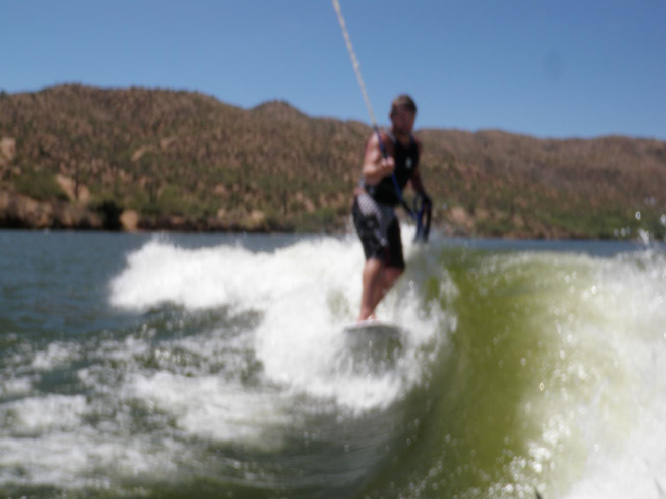

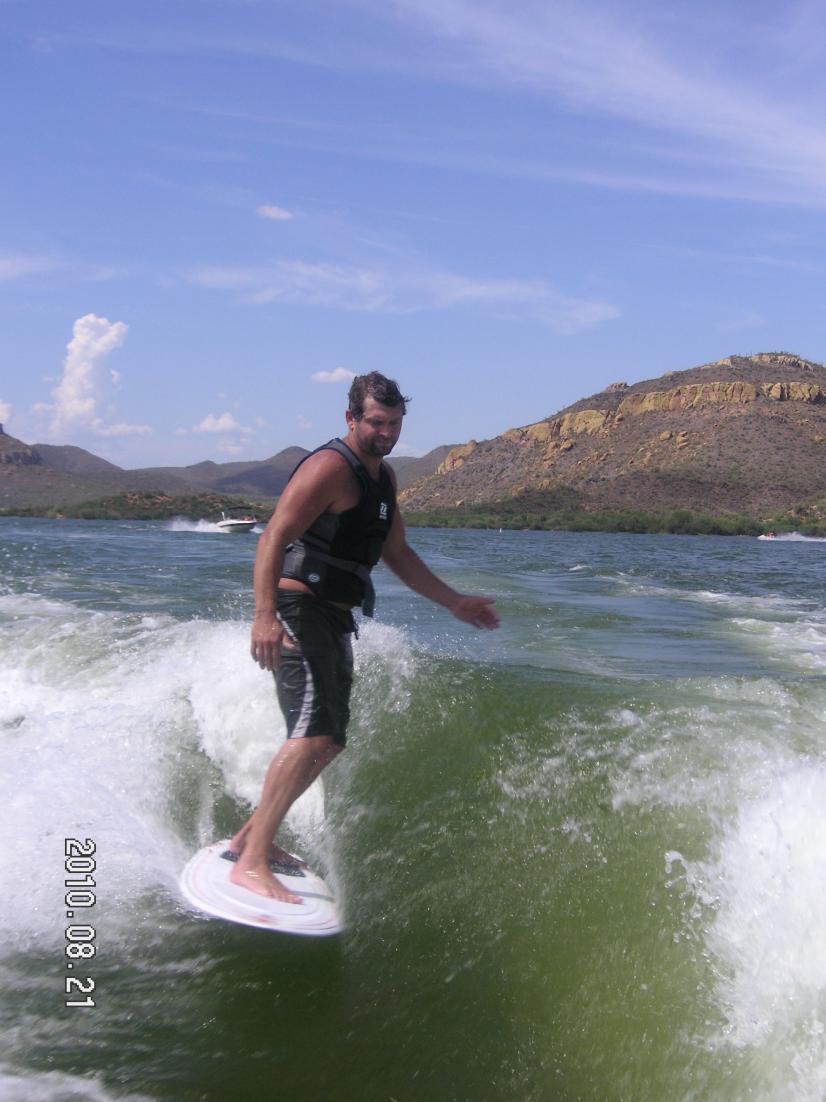

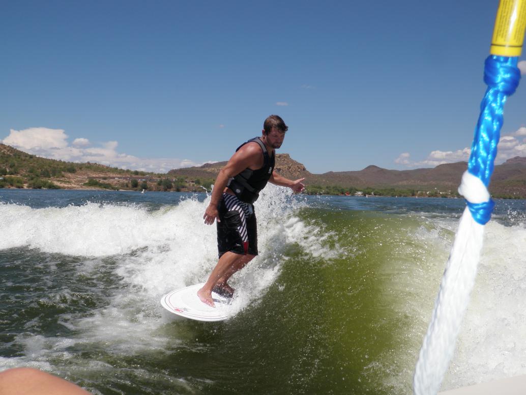

      Best wave I have had between my 02 SAN today, Longish pocket, riding 15 minute serious at a time.
      Four people in the boat: total weight 550#
      1100# Surf sac filled to capacity along my starbord V drive locker
      350# sac in the ski locker
      In the bow: 650# intergrated under the cushions, with a 750# bag filled in to about 70% cpacity.
      About 200# under the surfside gunnel
      and the surf wave sac shaped like and L (1150#) behind the driver and extending across the back seat
      I HAVE THE ABILITY TO GET MORE WEIGHT SO THE SKY IS THE LIMIT...will somebody show me the perfect SAN 02 WAVE!!!!
      I have 1 thousand pound of lead weight available, another 750 sac, amd can pic up some others. MY QUESTON IS HOW MUCH BETTER OF A WAVE WILL I be able to design
      Wave looks great man! How does it handle with all that weight in there? Ever feel like its going to tip when other boat wakes come through?

            I have never had the feel like it is going to roll from another boats wake. And even with that much weight I rarely take water over the bow. I slowly let off the throttle when a surfer falls, allowing the boat to slow without taking wave over the stern. Then I reverse the boat to slow momentum without abruptly turning to stbd. Then slowly turn and pick up the surfer. it is not easy to get used to, and having run a rescue boat for several years it goes against every ounce of logic in my body, but that is what it takes I guess to get the right wave. I keep reading where less is more in a SAN concerning wave size but that is not my experience. I may try to empty the V-drive sac a bit and empty the belly sac, but I have had much more luck running several thousand pounds on the surf side and it just gets better when people move to that side as well. Does anyone have any pics of a better wave (Starbord or port?) with a surfer on it?
