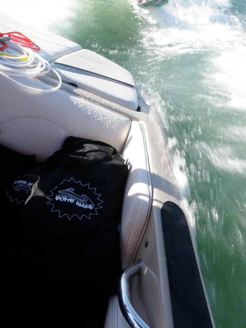

Eric, Nice pic of your gunnel.
Have you tried putting the extra couple people in the bow in the cockpit opposite the rider's side towards the front on the side seat? Or one there and one in the jump seat? I do this when I am really pushing the weight with extra people like you are, and find it improves the shape of the wake quite a bitthe WakeSlayer
