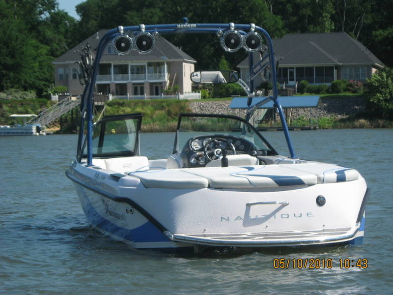

    Hey guys,,, and girls if we have some
    I am fairly new to the wakeboard boat ownership. I have a 2003 super air 210 TE in perfect condition. I am having a problem with getting the wake right. i have 2 very good wake-boarders that ride with me and we cannot get the wake to be clean. all ballast are full and doing about 22.2 MPH we have played with the speed and thats the speed that seams to be the best. i have PP and upgraded to the 2008 Double Line Display and software to V6.5. When we wakeboarding and cut out hard it seams to clean up, however the PP drops to about 19MPH (cant figure that out either) but right before we hit the wake it washes out. it is doing this on starboard and port side. any ideas on how to fix this.Click image for larger version

                      OK guys, i need help. i am having a tough time with the wake. we just cannot get it right. very wash at times move people around then it's ok but halfway through the pull it becomes washy. i did have a pro and a CC sponsored ridder with me friday and he thinks it's the PP, he thinks the pp solenoid that is attached to the throttle cable on the engine has seized.
                      my rope is 75-Ft all 3 tanks are fill and 200lbs up front. also 8 people(1400lbs)
                      Any ideas if it is the pp, pp solenoid or what.
                      p.s.. the wake looks washy pulling and just ridding
