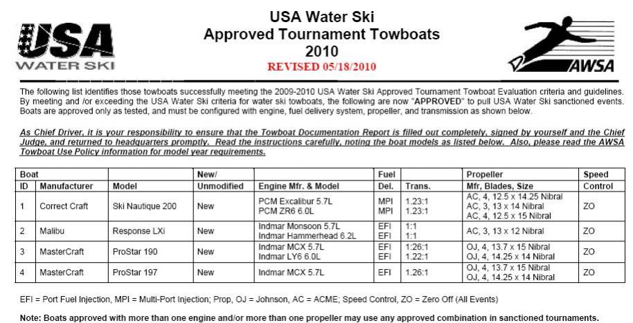

          Looks like I get to correct myself! On USAWS's website, there is a list of approved boats. It lists 3 props for the 200, but not sure which prop goes with which motor.
          http://www.usawaterski.org/pages/Tou...ntTowboats.pdf

          • teamseal
            • Dec 2006
            • 416
            • Panama city, Florida.
            • 2008 196, 1992 Shamrock 20' center console, 1965 Rickshaw race boat, 2017 ski 200 H6.
            AC, 4, 12.5 x 14.25 Nibral: 5.7 motor
            AC, 3, 13 x 14 Nibral : Jump prop 5.7 or 6.0 motors
            AC, 4, 12.5 x 15 Nibra:l 6.0 liter motor.
            Dont have the ACME number for these wheels

                  Approved Towboats
                  Remember that the prop must also be on the approved list for tournament use.

                    Ski 200 props
                    Thats for last years testing, As this years test has not occured yet. Dont know if CC will come back and re-test a different prop configuration for 2011 but their are many of us that are utilizing other than AWSA approved wheels for other than tournament skiing on the ski 200. One popular prop is the 654 on a 5.7 at lower elevations (tho it is a tested configuration)..
