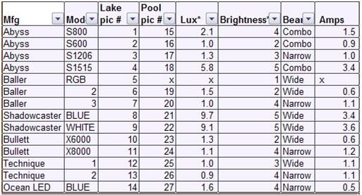

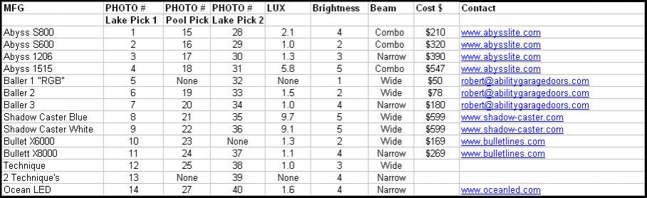

          Grant and I did quite an extensive LED test about a year ago. Here is the summary table:

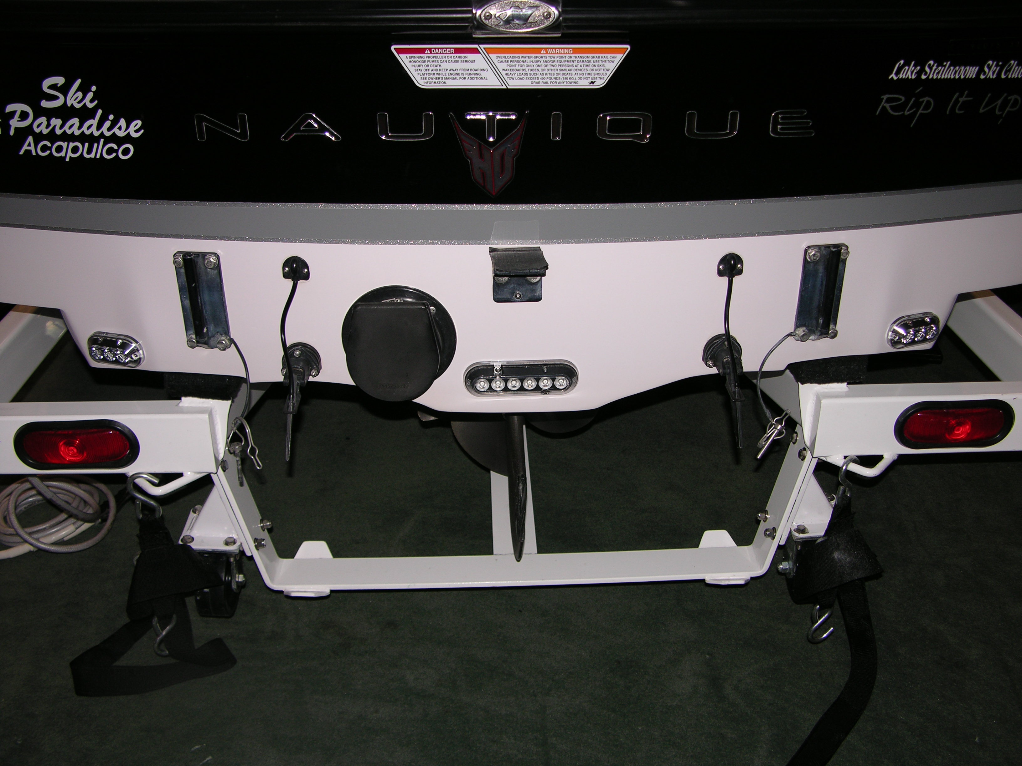

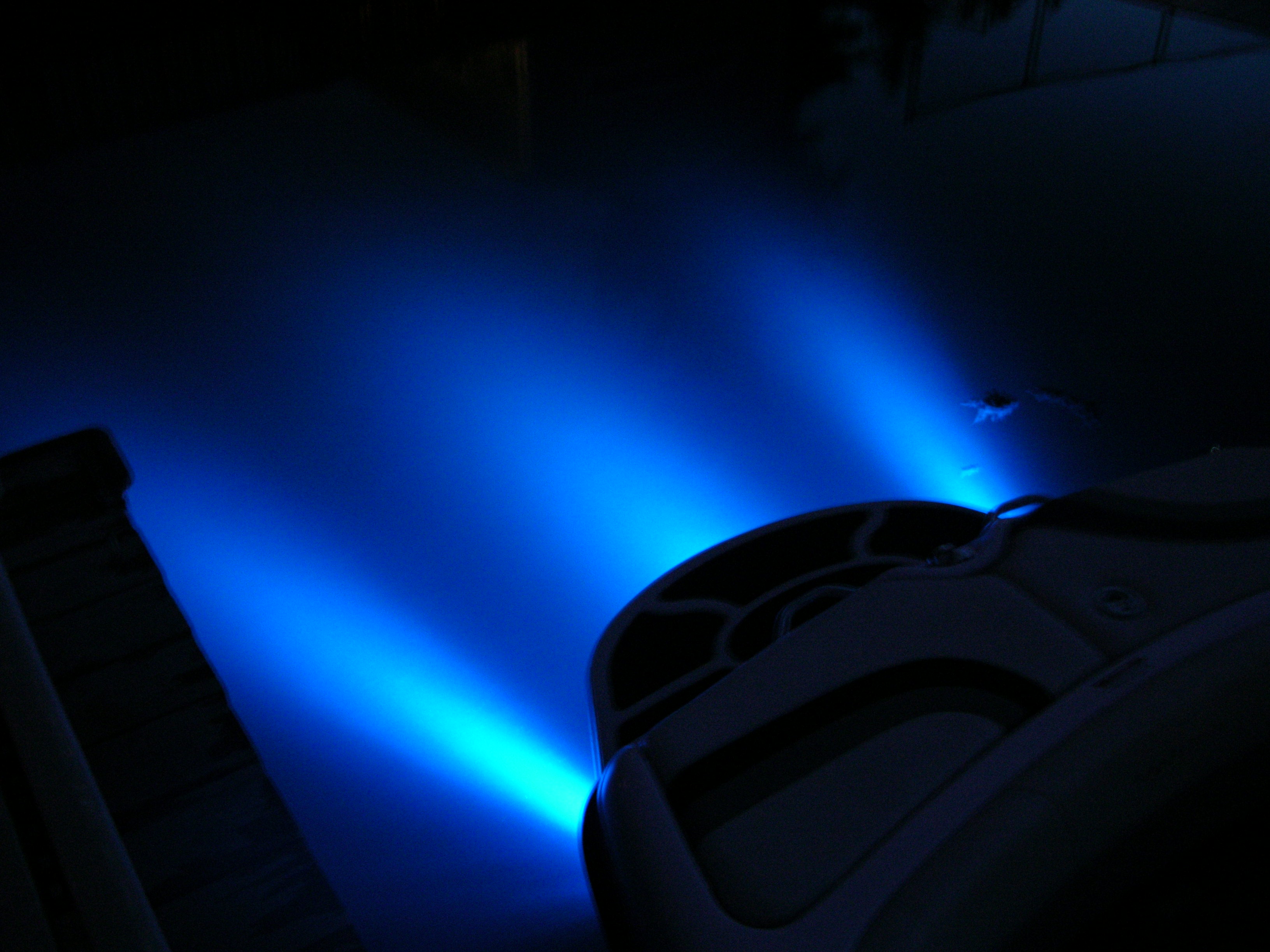

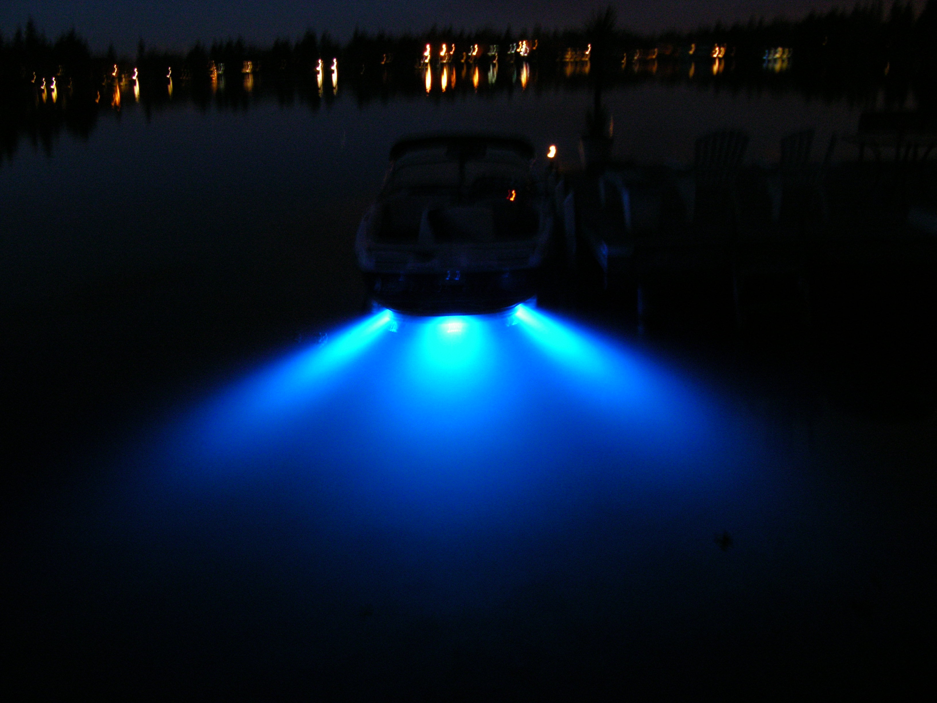

              Ocean Amphibians
              I have two A3's and one A6 on my 196 - very high quality and bright lights. May not be the cheapest or brightest but I think they are worth the $$. I am in the process of ordering two more A6's.
