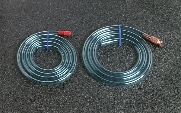

Along the same lines as Dave's suggestion, for about $4 more pick up a "Super Siphon", they sell them at Bass Pro and Overton's among many other outlets, put the brass end in the gas can, cycle it up and down 3-4 times, flow will start and it will transfer with no mess. If you go this route get the largest diameter hose they have available, 1/2" IIRC.

Major +1 for Quinner's idea for using an automatic siphon hose - "The Giggler". $5.99 at Harbor Freight. I give one to my friends when they buy a boat. I also keep one for draining the kid's fish tank.1962 Classic
