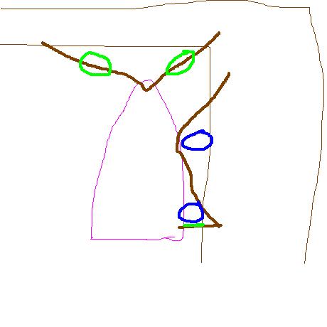

    We dock in downtown Pittsburgh and see heavy boat traffic daily. We leave the boat in for the majority of the summer and had zero issues.
    We have LARGE bumpers. Our we park in sort of an L configured dock. Yours would follow the same method but not use the bow/port rope.
    Brown would be the rope.
    Blue is bumpers.
    Green are shock absorbers. Basically prevents the lines from going taunt. They are pieces of rubber that have eyes on either side and you just wrap the rope around them a few times.
    The lines connecting to the middle cleat on starboard side are 2 separate spring lines that just keep the boat in place.
