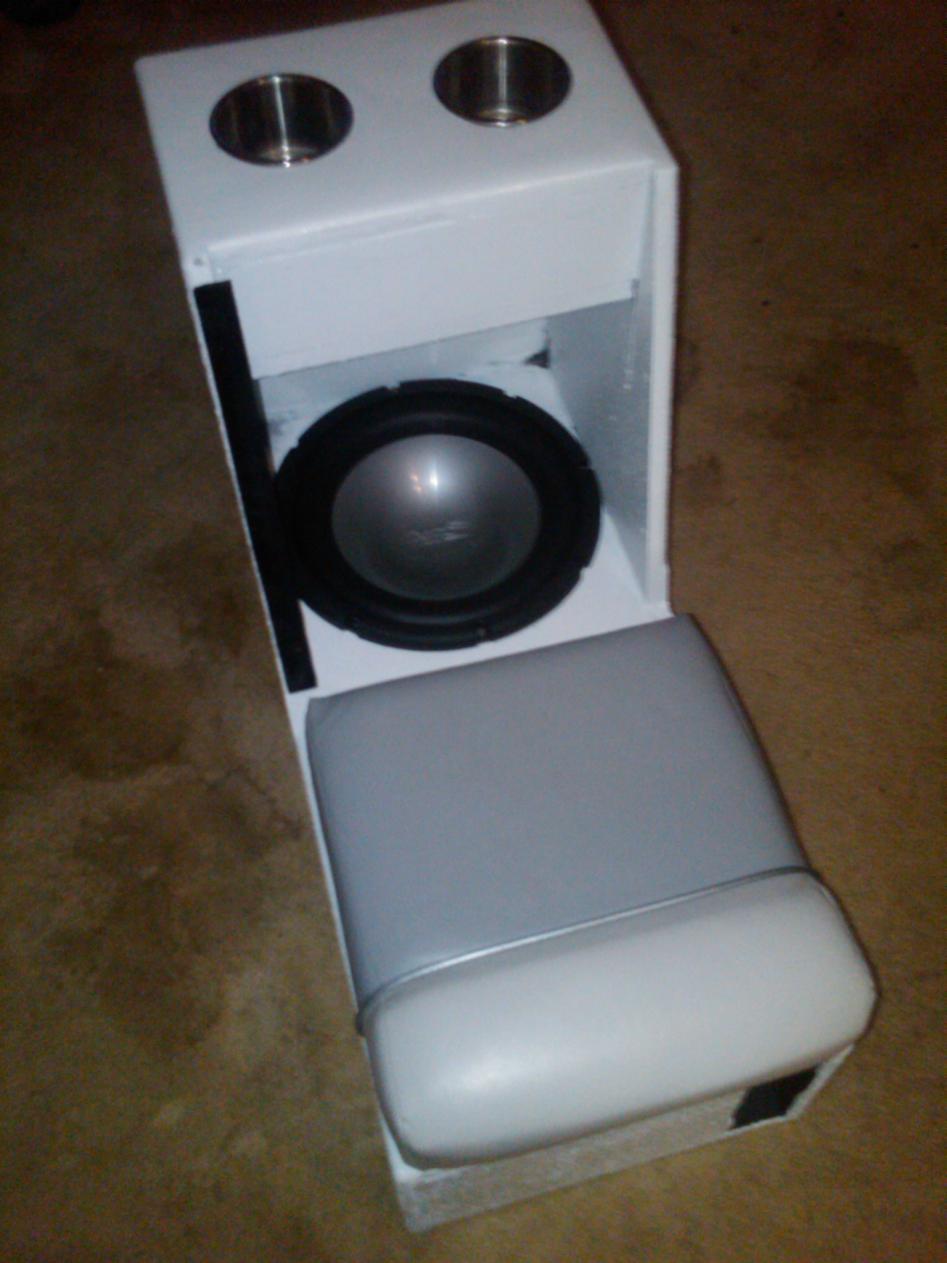

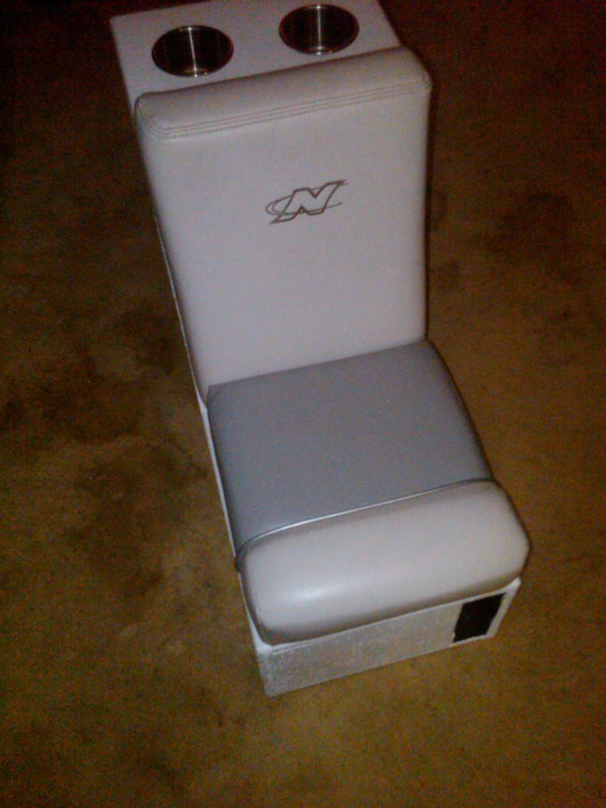

Here's my prototype sub seat box. Just wanted to see if anybody had any thoughts on this. Box is made to Wetsounds reccomended specs, but a different shape. Material is MDF, sealed inside and out with truck bed liner, and then painted with white enamel. It solved several problems that I had. I did not want to cut holes in my passenger compartment to vent it, so I decided I needed to just get the sub out of that compartment altogether. I used cushions from an existing jumpseat. The seat actually fits better than the original jumpseat did. I haven't actually finalized my design yet, but its ready to put some water time on it.
It sounds WAY better than the stock sub. I'm still running it off the stock amp until I get my new SYN1 installed. Haven't had it out of the garage so I haven't had it turned up over half volume. Yeah, it will definately give you a massage...
All the girls will want to sit in that seat..Originally posted by Rick View PostI'll bet when you crank it up it makes a great massage chair was wellLife is Short, Live it!
