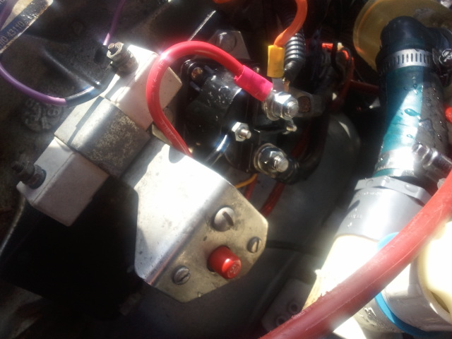

Just want to make sure.... Starter decided to stay on today. I took off the yellow exciter wire and the starter stayed engaged. It is late so I did not get to check if the starter exciter wire stays hot. I did take off the wire from the ignition so I assume my starter relay is stuck on. It is 20 years old with 1200 hours on it so I guess it is probably done and needs to be replaced. Anything else I should check?

If starter stays engaged, it is an indication of a low amperage problem. Check both ends of the battery cables and main grounds.
