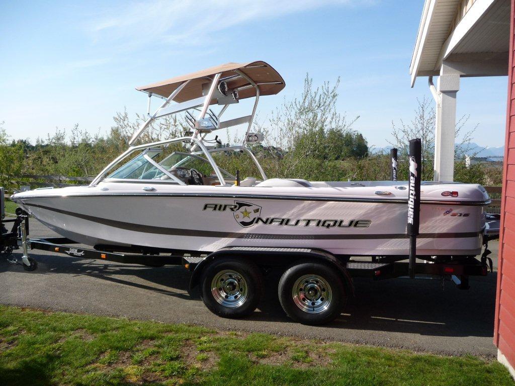

        here is a pic of my trailer, the frame is boxed and torsion bar suspension, which really improves the ride.
