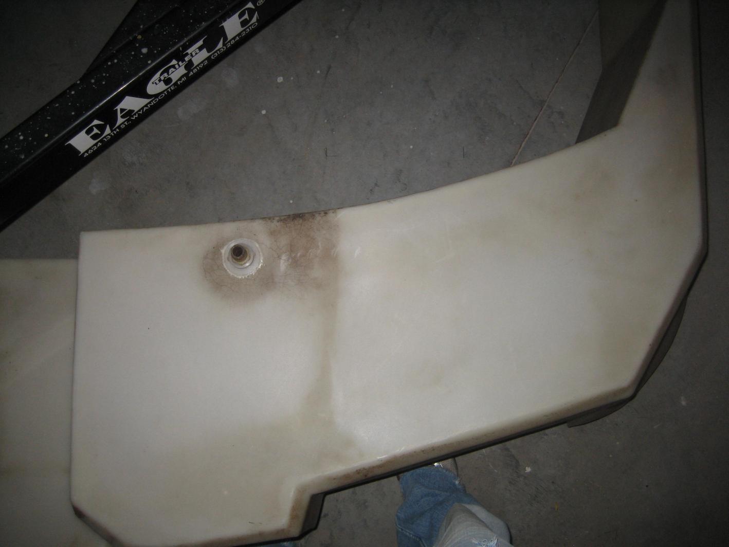

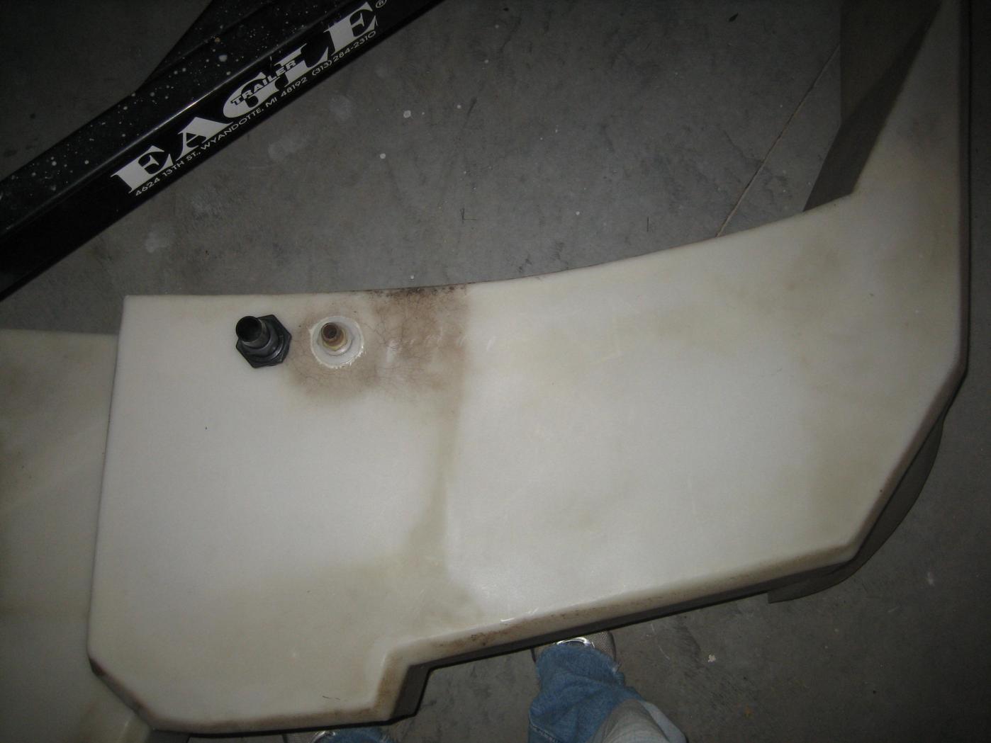

          I need some opinions on my ballast system.
          1. I'm using the hard tanks but the inlet fitting is only 1/2". So I'm planning on one of two things.
          a. cut off the thread insert and bore out the existing hole so my 1-1/2" to 1" thread insert will fit and epoxy it in?
          b. cap off the original inlet and drill and hole next to it and epoxy my 1-1/2" to 1" insert?
          See attached pictures below.

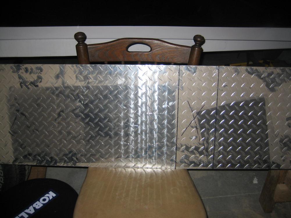

          2. I got a sheet of stamped aluminum from work to mount my ballast puppies on and one side of it is stamped. I'm mounting this in my rear locker so it will be visible. Do I.
          a. Let the aluminum sheet show?
          b. cover it with carpet?
          See attached picture below.
