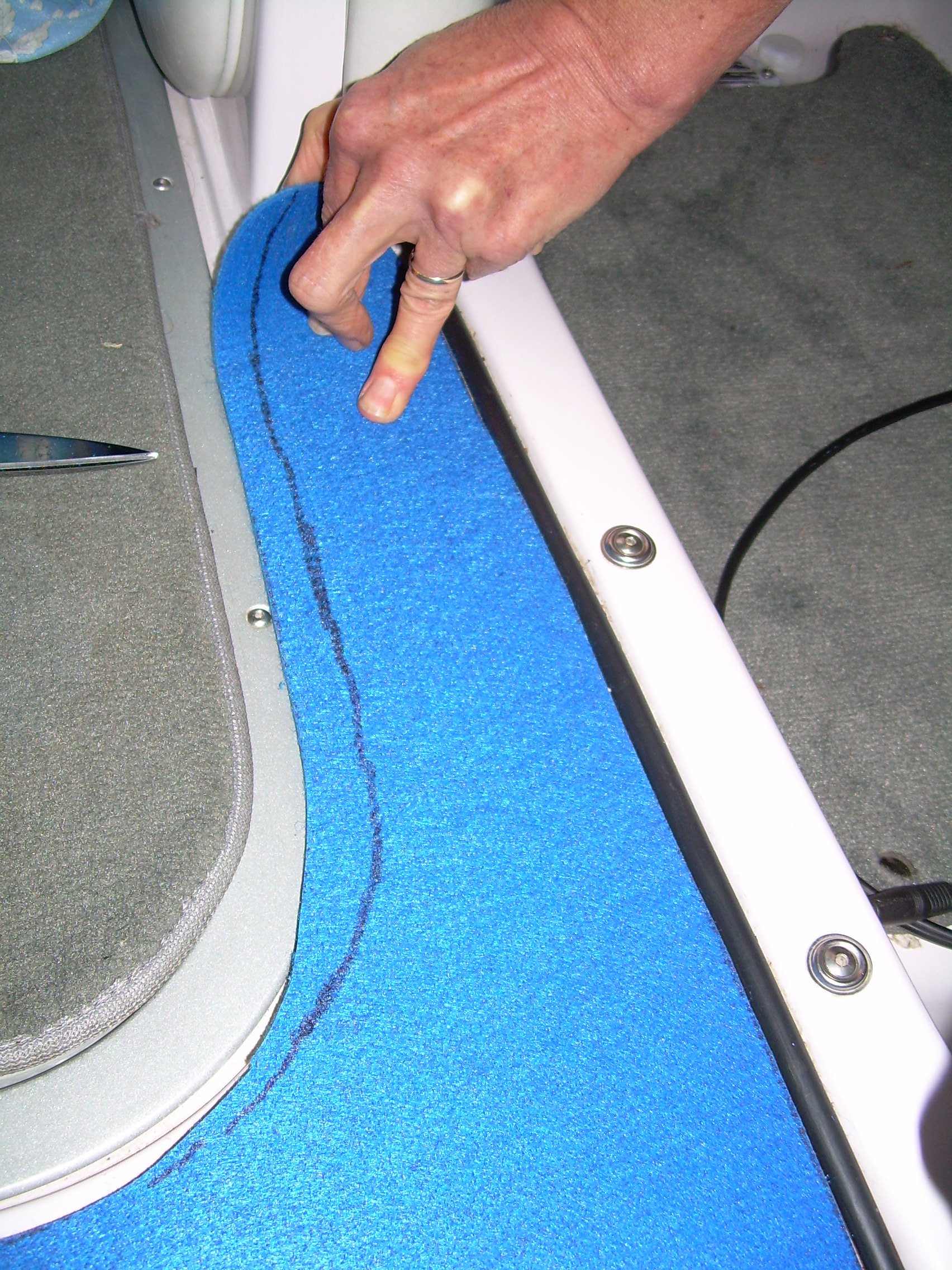

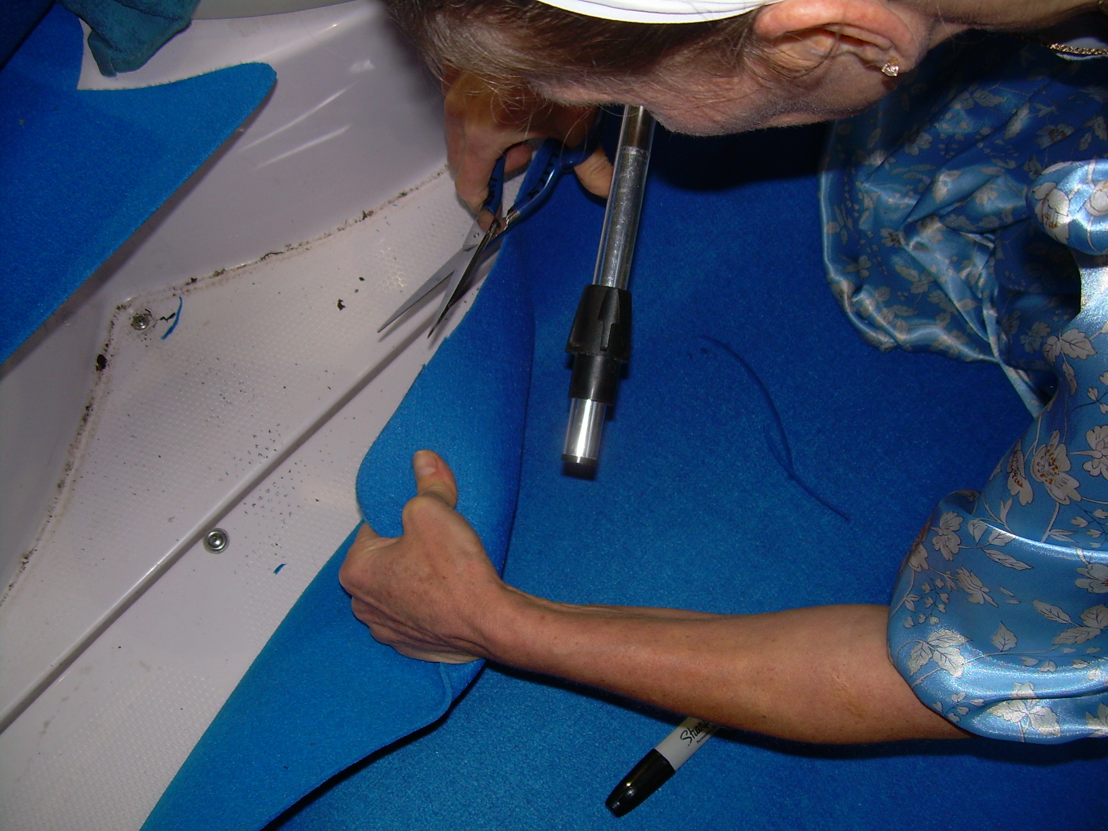

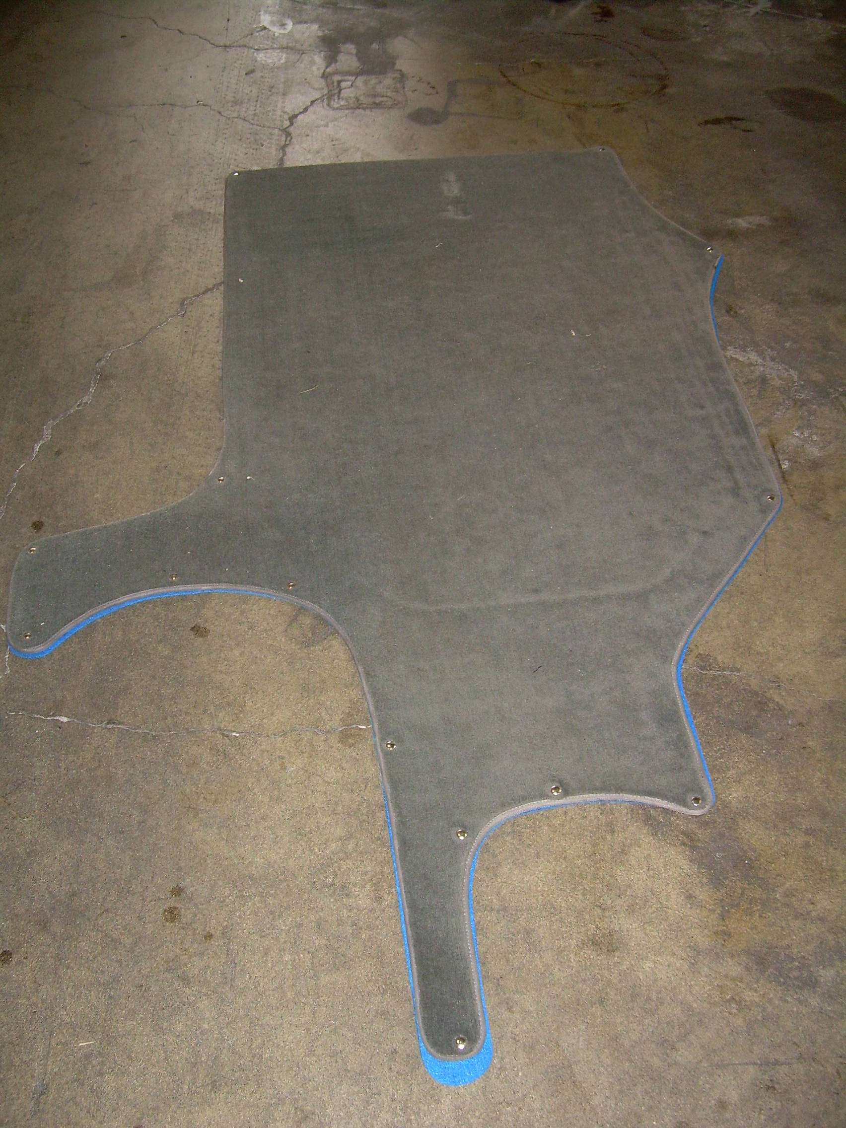

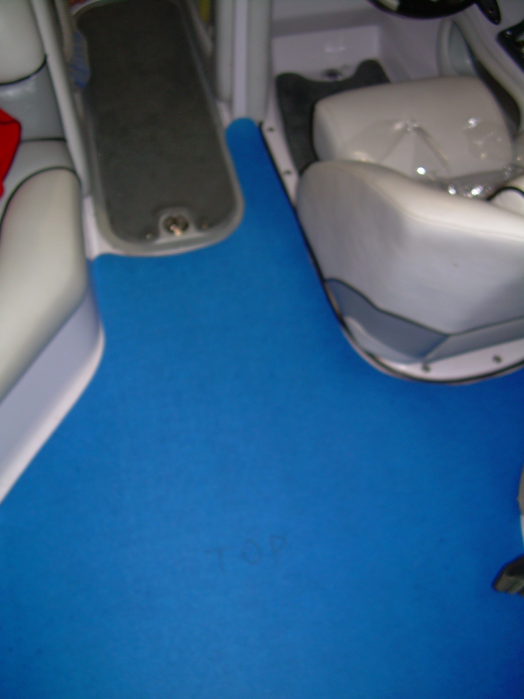

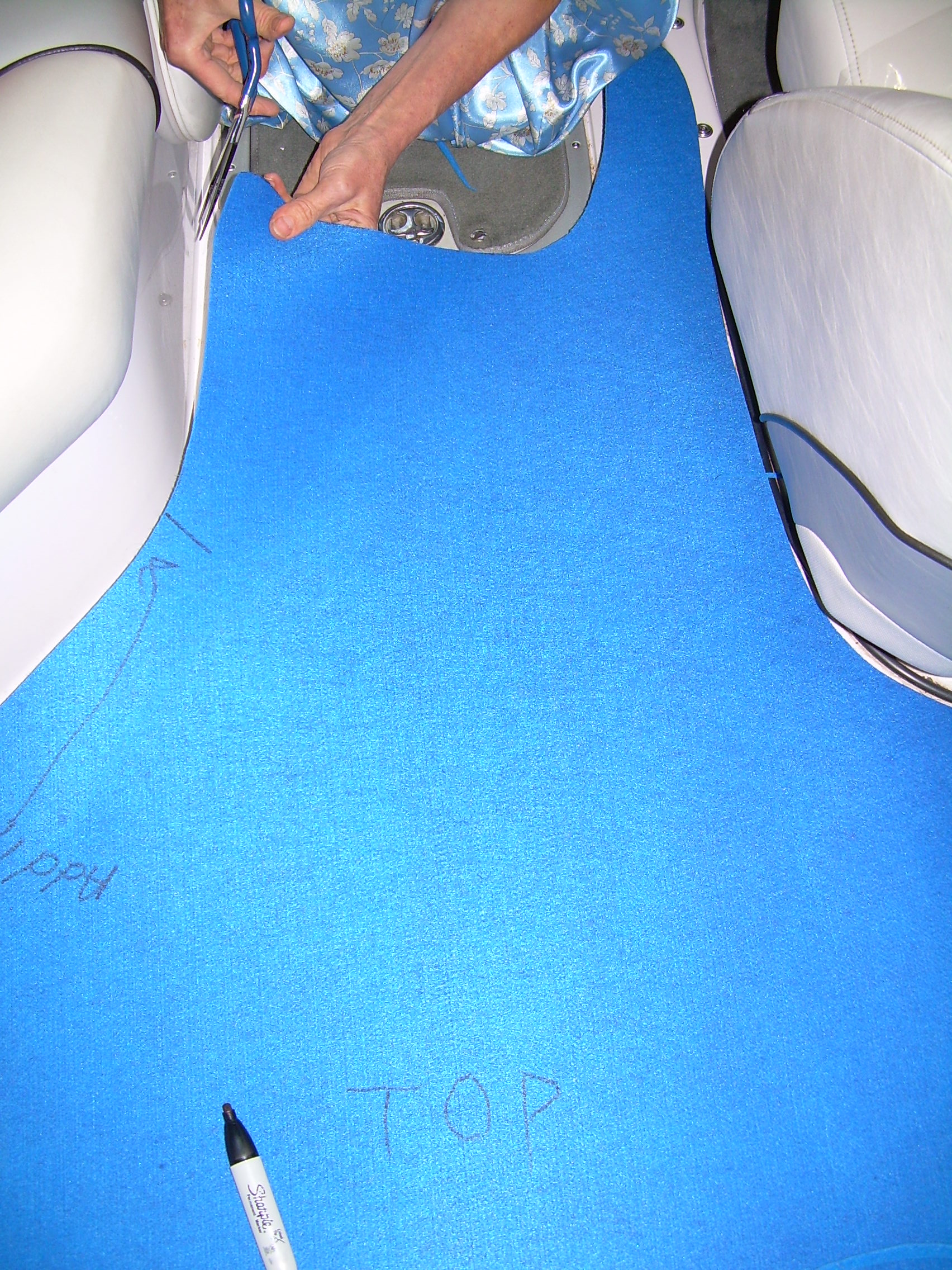

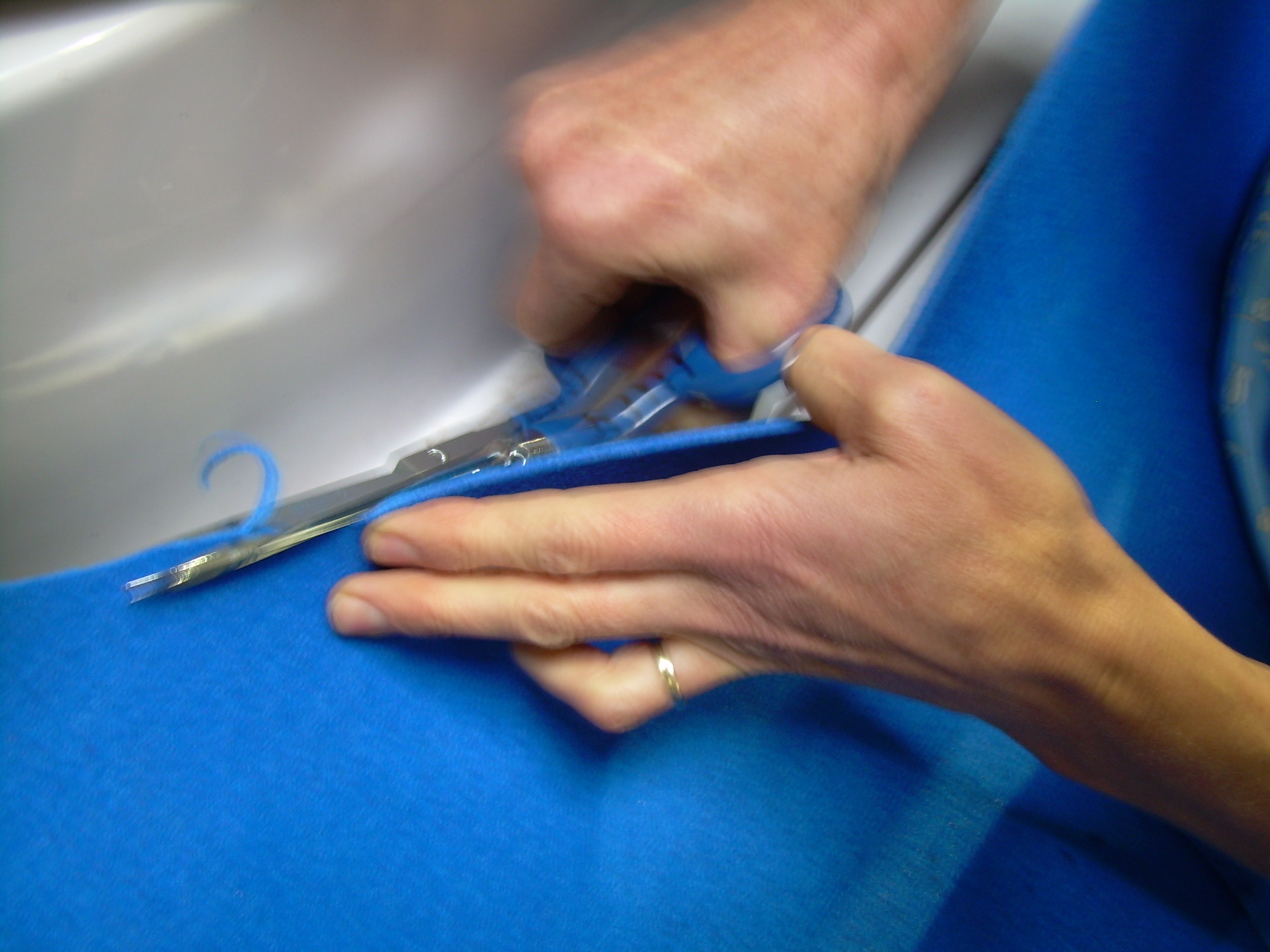

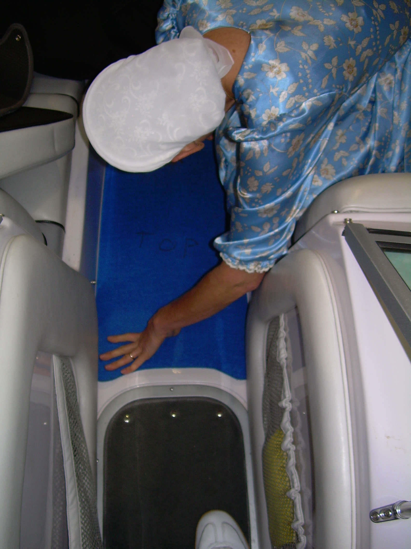

    After all the inquiries I've been getting on here for Aquamats, I figured I'd share some photos with everyone on tracing a template for custom fit snap-in carpeting. A lot of boats we actually have templates for on file; however, the Nautique SV211 '04 to '08 model happens to be one we don't--So, I figured this would make the best example for sharing on here. I'd like to give a special thanks to fellow planetnautique members paleotm and madboater2 for their time and patience with their old carpets, as well as Bruce @ Northwest Ski and Watersports in Tigard, Oregon for letting us use his facilities. As always, if you have any questions feel free to hit me up on the forums or via a PM!
    P.S. Sorry about the pictures being in reverse sequence, hopefully it gives a rough idea though!

        After receiving two seperate carpet sets and photos from two '04 SV211's, I can tell you that CC is not entirely consistent with their snap placement. I'm sure they have some tolerances they can abide by, but there definitelty seems to be some differences. That is why we prefer to ship the new carpet with the snaps loose, for the owner to install. If the snap placement is just slightly off, the carpet will 'buckle' and not fit properly. Now that we have made a template from hand-tracing the outline in an '04, the carpet itself should fit properly.
