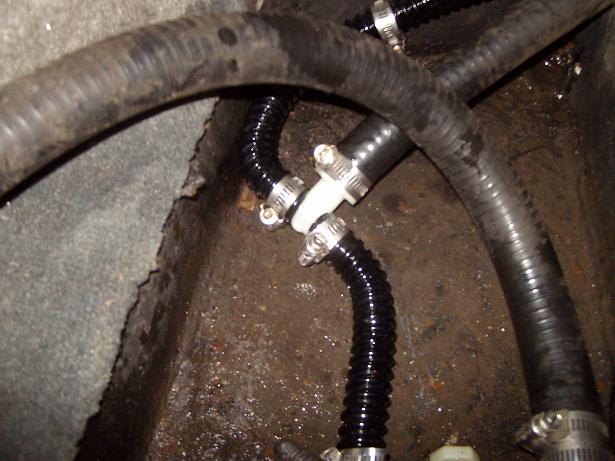

          Alright, for those of you always looking to save a buck like me, here is how I did this by using the aerator pumps instead of buying high dollar ballast puppies:
          Gut the hard tanks, but leave your hoses in place.
          From the fill hose connect a "T" fitting so that the water has to go right or left when it comes out of the hose.

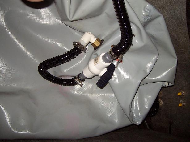

          Connect a short hose to one side of the T- connect that hose to the bottom fitting of your sac. This will now fill the sac.
          Connect a short hose to the other side of the T -connect this hose to your empty pump - connect your factory hose to the empty pump so now the water can pump out the side of the boat.
          All thats left is to connect your overflow hose to the top of the sac. You need to put a shut-off valve in that hose.

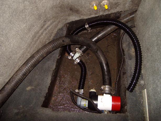

          What I did with the empty pump.

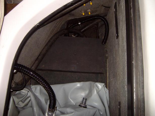

          When you take out your tanks you will see a small area where the empty pumps are when attached to the hard tanks. Kinda like a box with no top on it. I Mounted my pumps in there. I didn't want the sacs to put any pressure on them so I cut a piece of treated 2X12 to cover the pumps. Painted them black for now, may get matching carpet later. Leave 6" or so for all of the hoses to come up from the pump.
          For this to work, you kinda have to run it like the piggy back method. Open your valves on the overflow, and plug the empty holes on the side of the boat. fill the sacs, close your valves on the overflow. Smile while you stand in ankle deap water on your swim step. Ride till you can't anymore. Then take out your plugs, drain water and go get a massage from the lady friend.

                Had a few request for pics so here you go.
