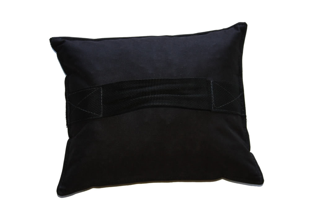

                    I use lead weight in my 08 210. I was on the fence about getting water bags or lead weight but someone sold their boat and I bought it from them. They paid about $250 for 400lbs. I bought it for $125. Each bag weighs 40 lbs. The lead is sealed in a plastic bag then place in a canvas bag with a velcro closure across the top and then a handle that is triple stitched to the side of the bag. If you are interested I can find out where they bought it but my wife and I love it.

                      Those are the Pop Bags and they use punched steel pellets.
