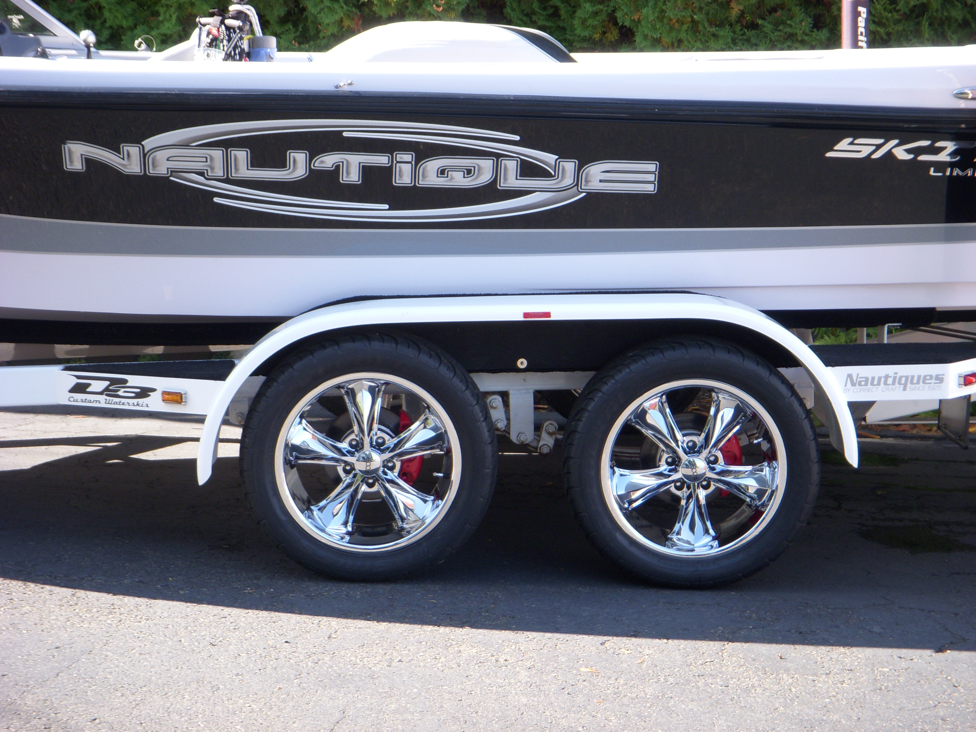

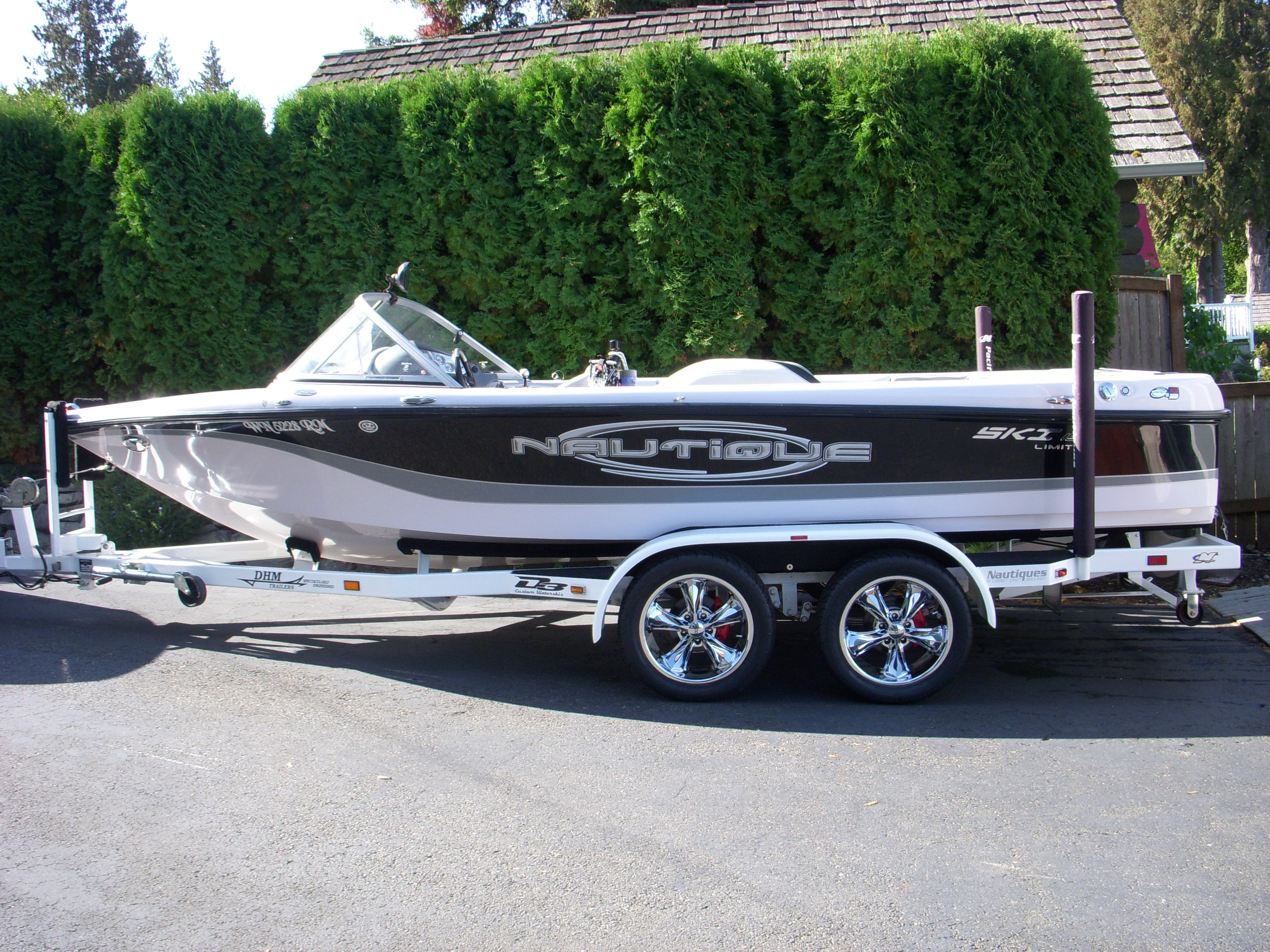

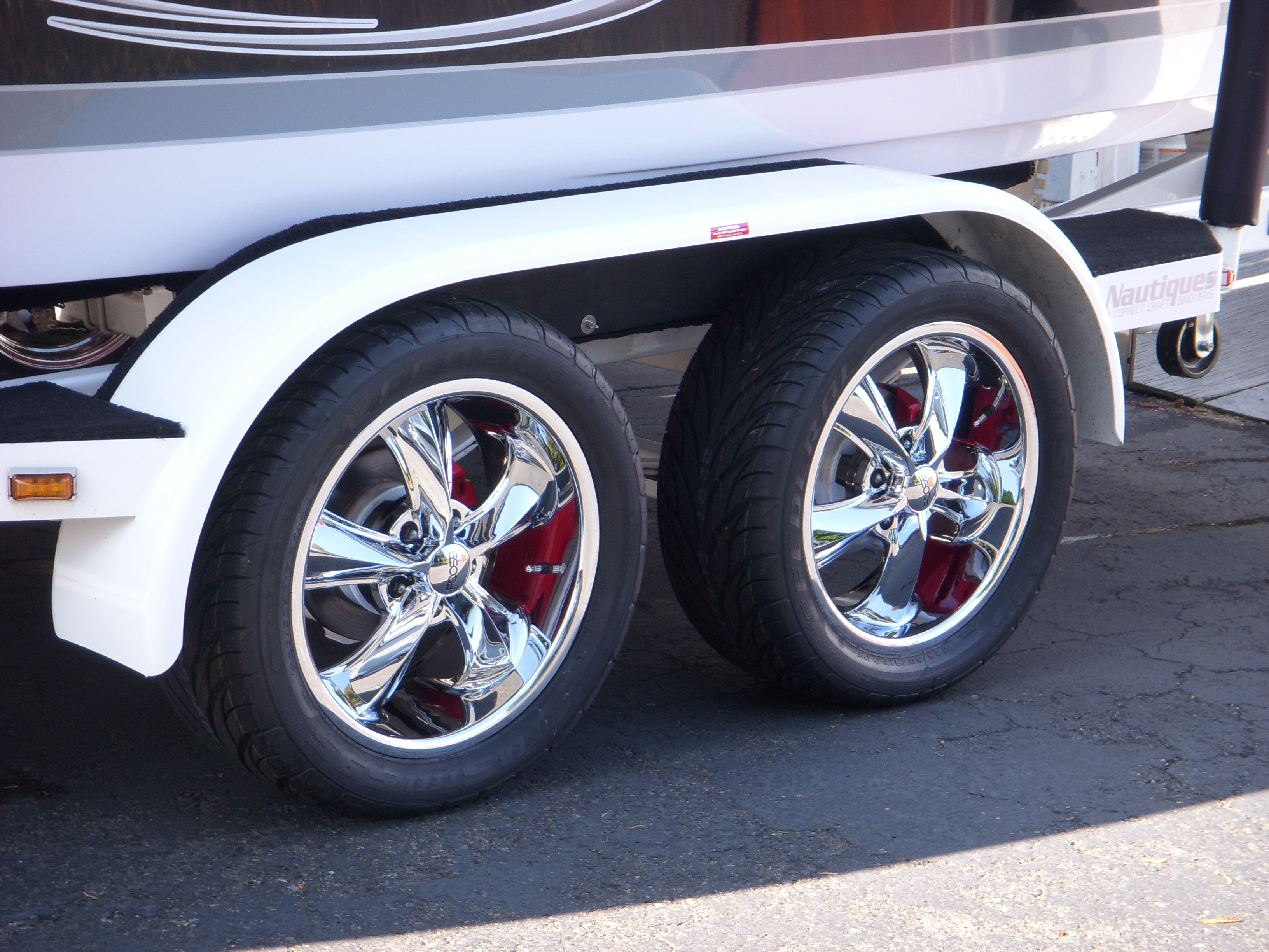

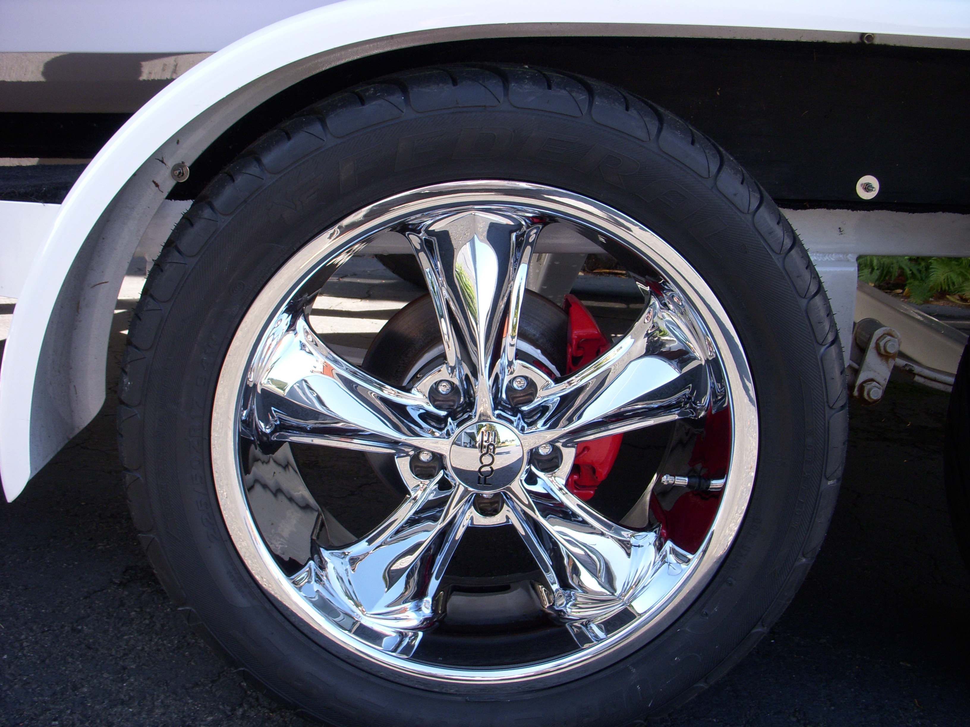

                    Went with Foose Legends - 17 x 7 w/ 225 x 50 x 17 Federal Tires. Will post a couple of pics maybe tomorrow but fit is nice, may have been able to go with a 55 series tire but 50 leaves some cushion. Package was $1600 for anyone interested. Tried some 17 x 8 wheels but the 8's were too wide without doing some modifications to the inner wood/carpet fender liner. Slight mod needed for the 7's but minor.

                      Here's a couple pics

                        Looks great! Here in SoCal I would be worried someone would jack the wheels/tires while I was in the water.
