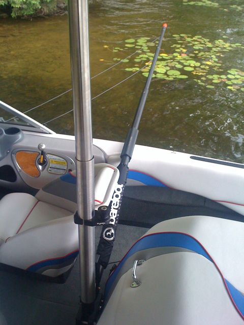

I use the Barefoot International contour boom with height adjuster and extension. I find the contour allows me to install the boom in a way that lets the mounting bracket sit low enough to the floor and keep the fly high in place. It also provides a little more room for the seat to move back. I have an 2004 196 and the extension is a must on this boat imo to keep the rider out of the spray. I have dealt with Mike from BI and Lane from Footers Edge and they have always steered me in the right direction.

I also use the contour boom...........which also allows me to keep my Fly-High pole on.2008 Super Air 210 Team

I too can use the boom and a fly high pole together.
