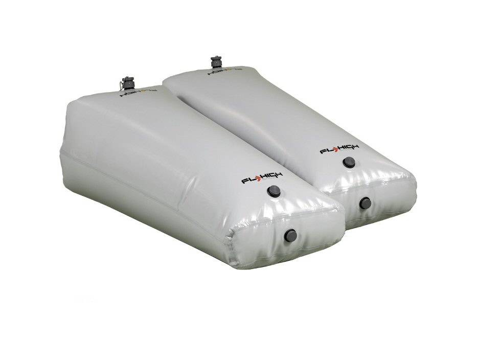

    I want to plumb Fly High wedge sacs to the stock ballast overflow in my ski lockers. I know there is a lot of information about this, but I still have a few questions befoe I pull the pin.
    I'm planning my install based on Core-Riders thread with the "quick connect" modification that Gride300 did (See first link). Will I need to put PVC pipe in the Fly High sacs to keep them from collapsing when draining? I would think that if the bags collapse, it will block the vent causing air-lock when attempting to drain the hard tanks. Is this not an issue with these bags?
    I noticed these bags have 3 fill stems, does it matter which lines go to which stems?

    On my 07 220 I run from the factory tank overflow into the bottom hole of the bag, then from the top hole right above it i run the vent out. I dont use the front hole at all, and that is what you would need the PVC for. This way when the factory tank empties and creates a vacuum which pulls either water or air from the sac on top of it to keep it from collapsing. Since my pumps on my 220 have timers on them that stay on for about one tank emptying, I always wait a few minutes between when they stop and i turn them back on, just to give some time for some air or water to catch up getting into the hard tanks from the sacs. I used to just keep turning them on to drain but i collapsed both hard tanks that way at some point which caused the guages to stop working when the pickups bent. I got new pickups for the tanks and have been real careful since then when emptying and havent had any problems. I use the exact same system for the floor tank, just a different Fly High ProX sac.

      I have the same setup. The second link goes to my setup. My pumps are not on timers they shutoff when the gauge reads empty so there is no issue with collapsing the hard tanks unless I do not open the valves when I empty (which I've done once or twice). Definitely use the PVC. I know a few others using this method. No issues.

        What I did was place a hose from the top plug on the back to the top plug on the front of the bag. All the fill and drain hoses go from the bottom plugs. This stops the bag from sucking closed. I have 3 sacs and the factory on my belly pump and it takes 9 minutes to drain and fill them all. A custom sack on top of the gas tank, an arrow in the locker and a intergrated under seat bow sac. I love it SANTE220
