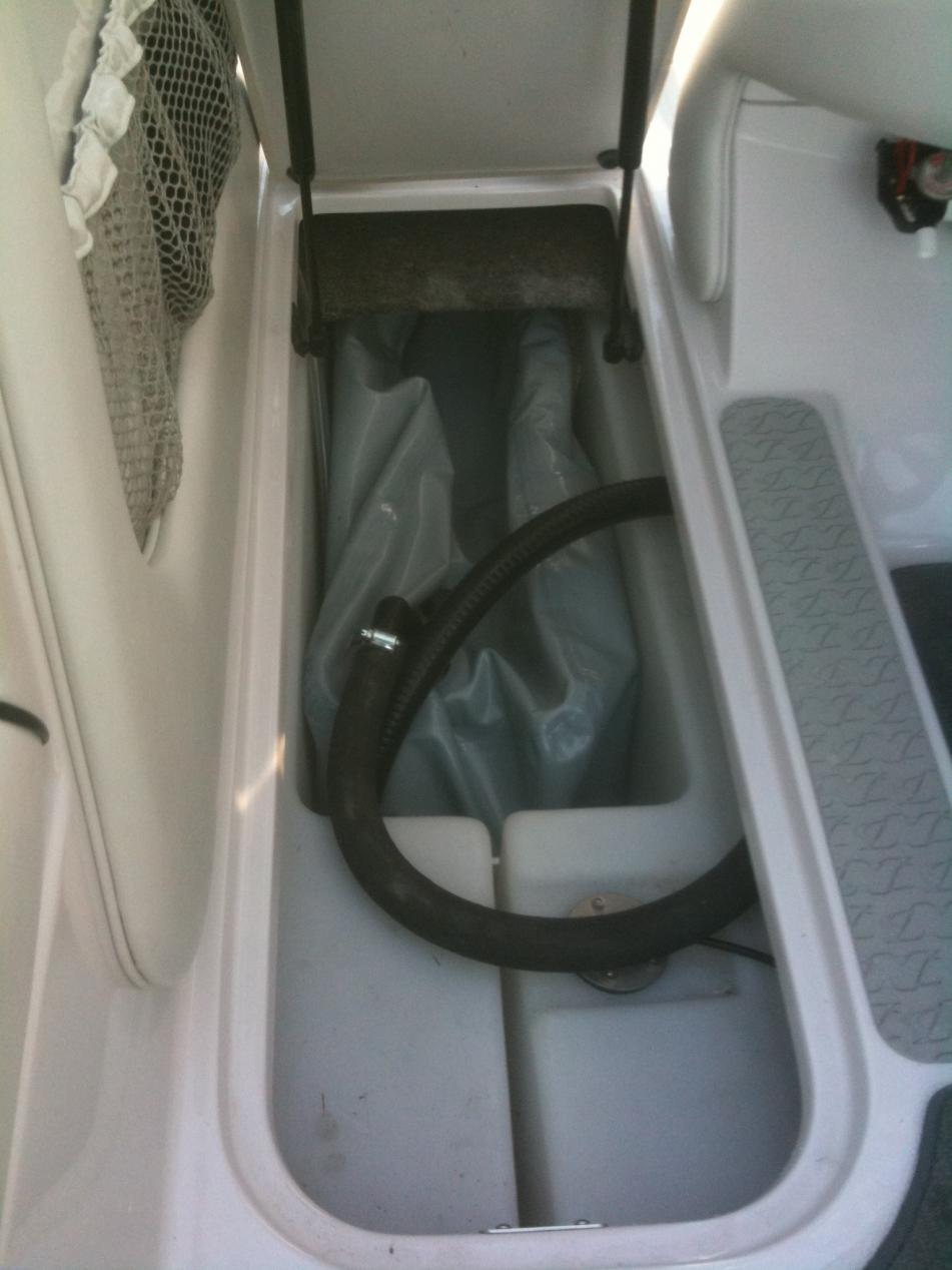

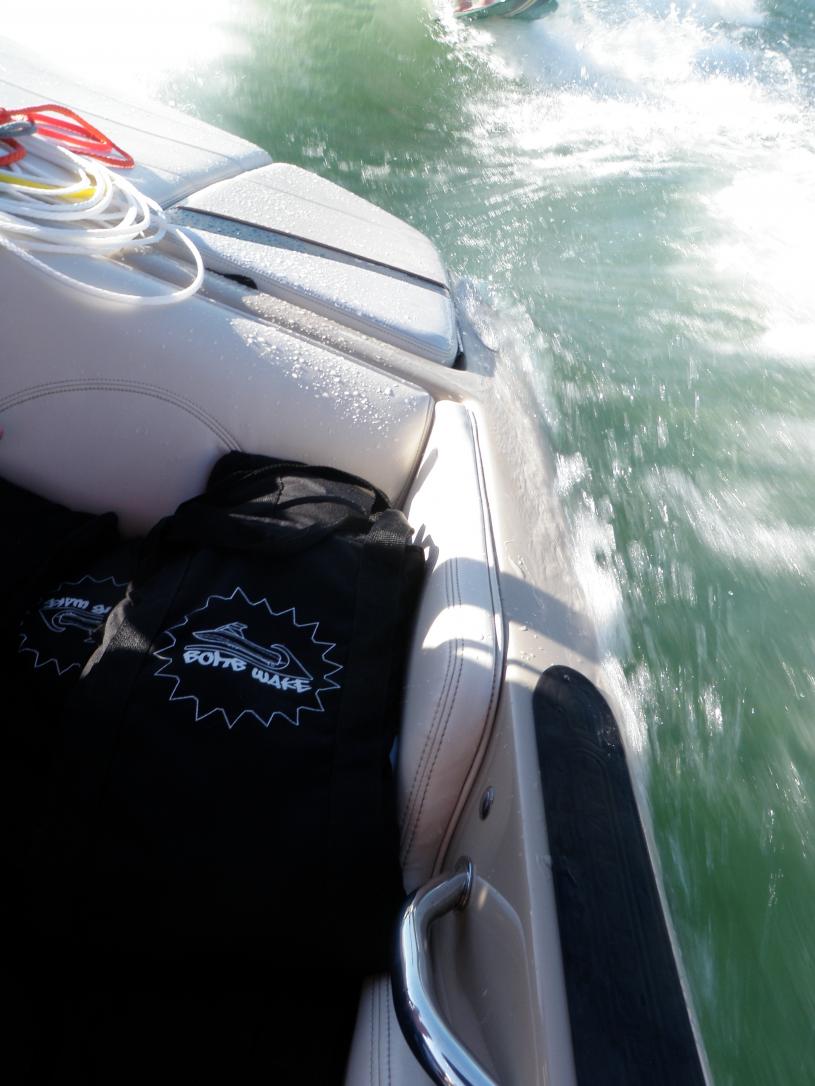

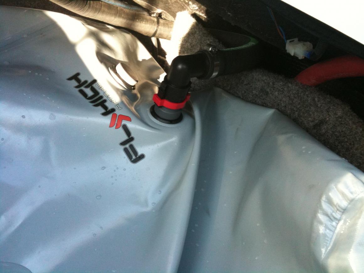

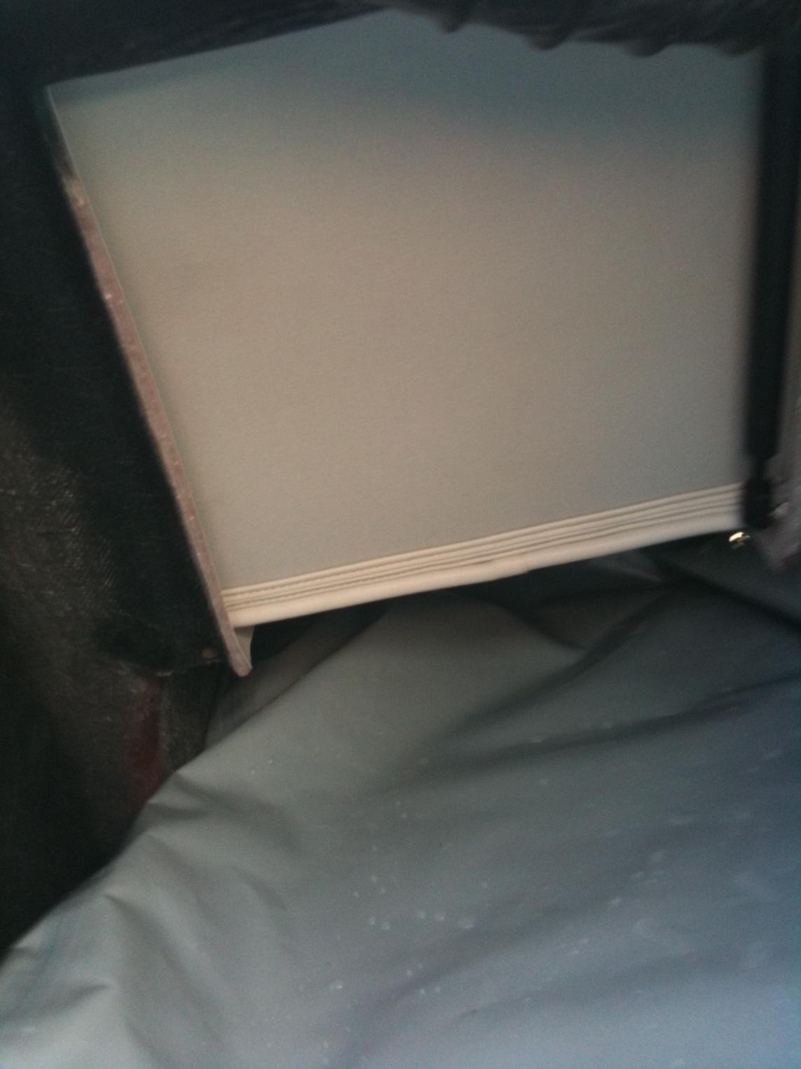

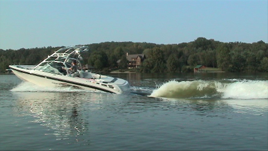

                      This is the set up which I found works the best for my 2002 SAN with right handed prop rotation (important in nautiques to determine which side wake will end up being better)
                      On each side of the V-drive I have 1100# Surf sacs. I fill the surfside as much as I can, probably close to 950-1000#, and the opposite side about 1/3 or less full. I have about 300 pounds of lead I use (in 50# sacks) to fine tune areas of the wake while wakeboarding, and I usually lay those on the surf side as well. I have a 750# sac I place on the surfside seat against the gunnel (but I think I am going to upgrade to the 1000#+ L shaped bllast that goes on the seats from FlyHigh). I fill the 350# ski Locker, and the 650# bow sac. This set up throws a waist high wave, that allows me to ride without the rope on most stock boards (liquid force fish,and venture, ronix koal and their longer noseriding board). The pocket is probably anywhere 8-15 feet behind the swimstep.
                      This wave was without much of the weight, but shows that you definitely can get a decent pocket and wave which you can ride for thousands of yards without a rope. (I think this pic was taken with approximately 1450#s less than my current set up)

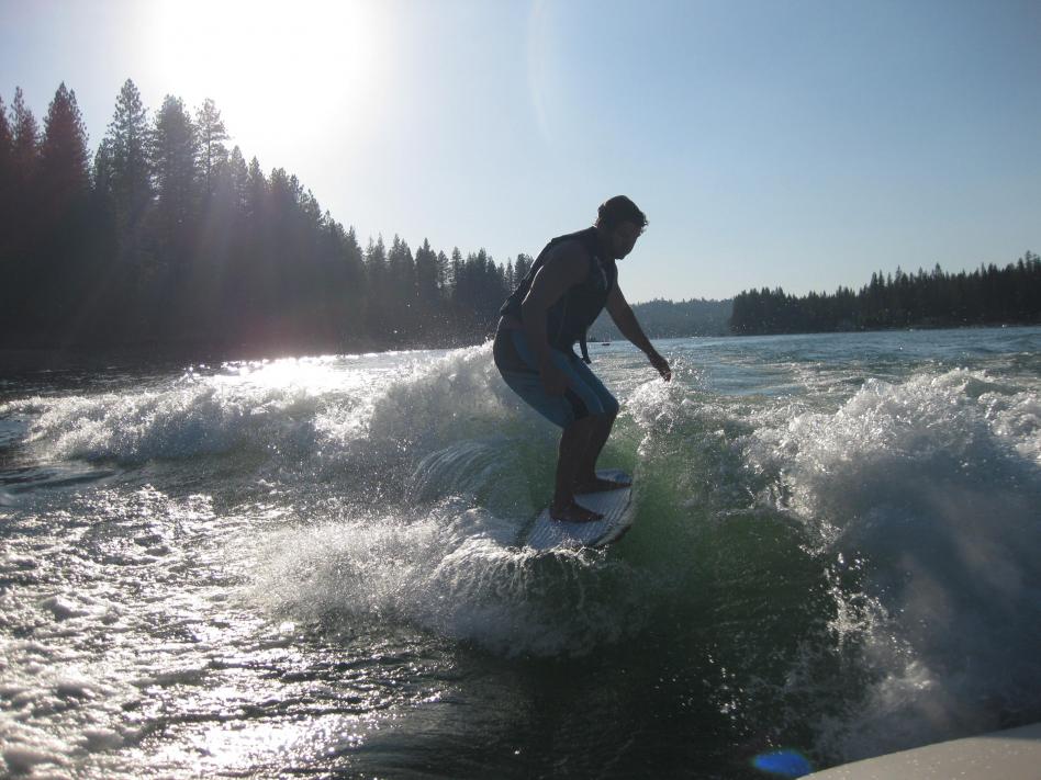

                          We have an 07' 210 and this is our wake with full port tank, 2x 350lb sacs, one on the rear seat on the port side and one in the port locker. We don't fill the belly tank but I want to try that to lengthen the wave a bit. This picture is with just the driver. The more people there are the bigger it gets.Click image for larger version
