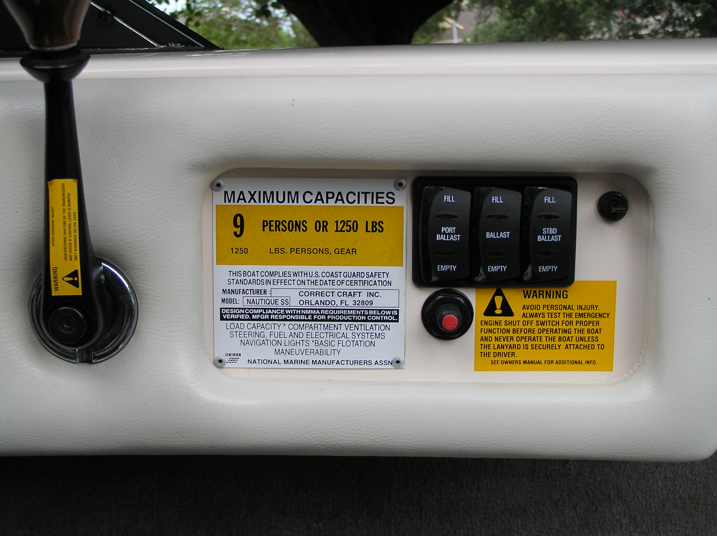

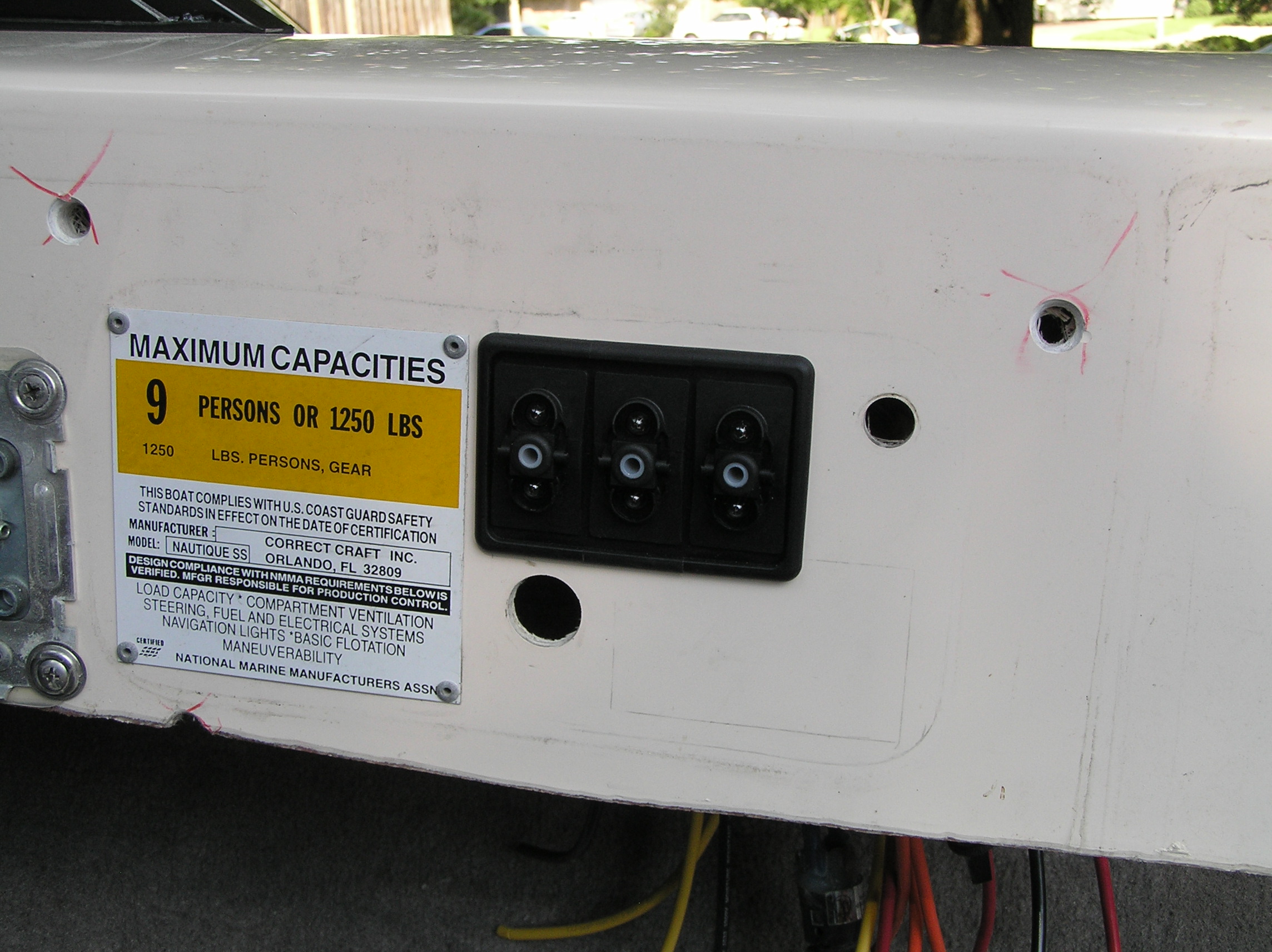

I figured I would post my install even though it incorporates many ideas that were copied from other installs on this site. Maybe something I did will help someone else considering an install. Plus, "wake_fun" asked me to post almost every time we spoke.
I want to thank all that helped answering my questions and especially wake_fun, bchesley, and davidf. Without their help this would have been a much more difficult task.

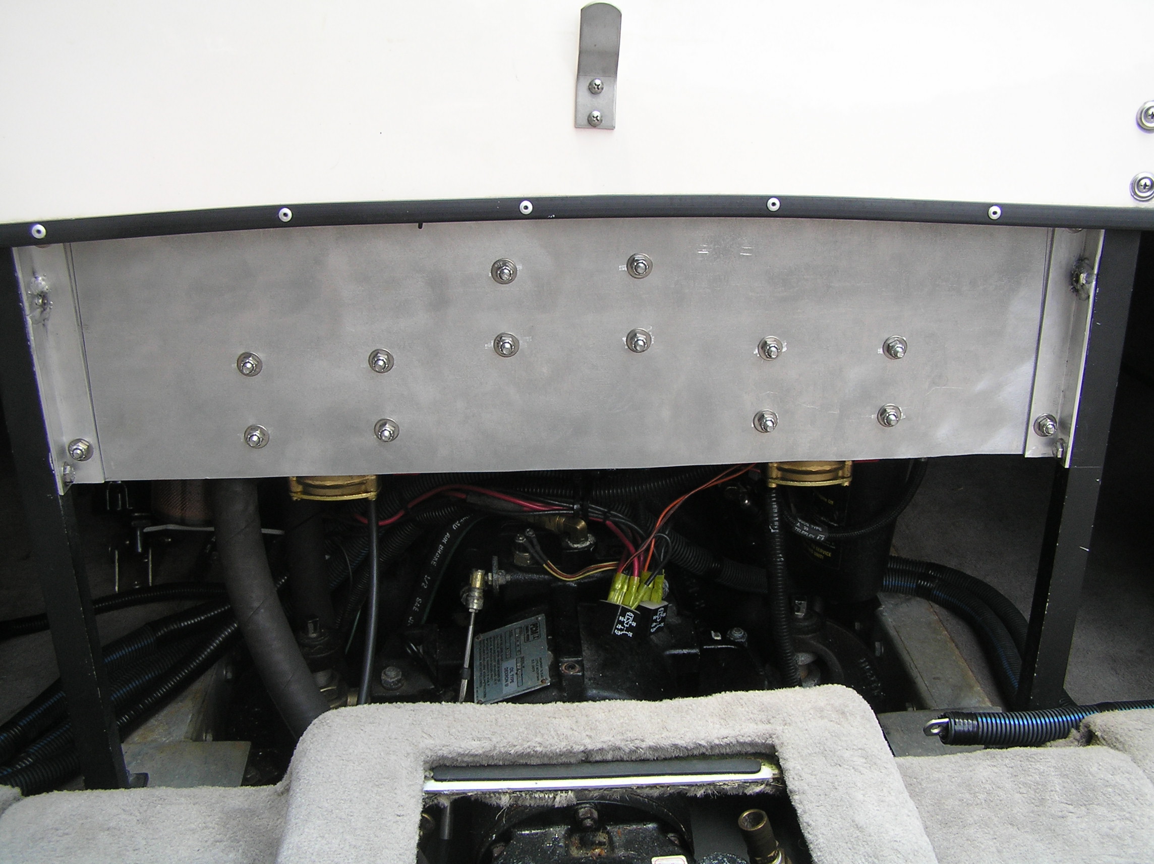

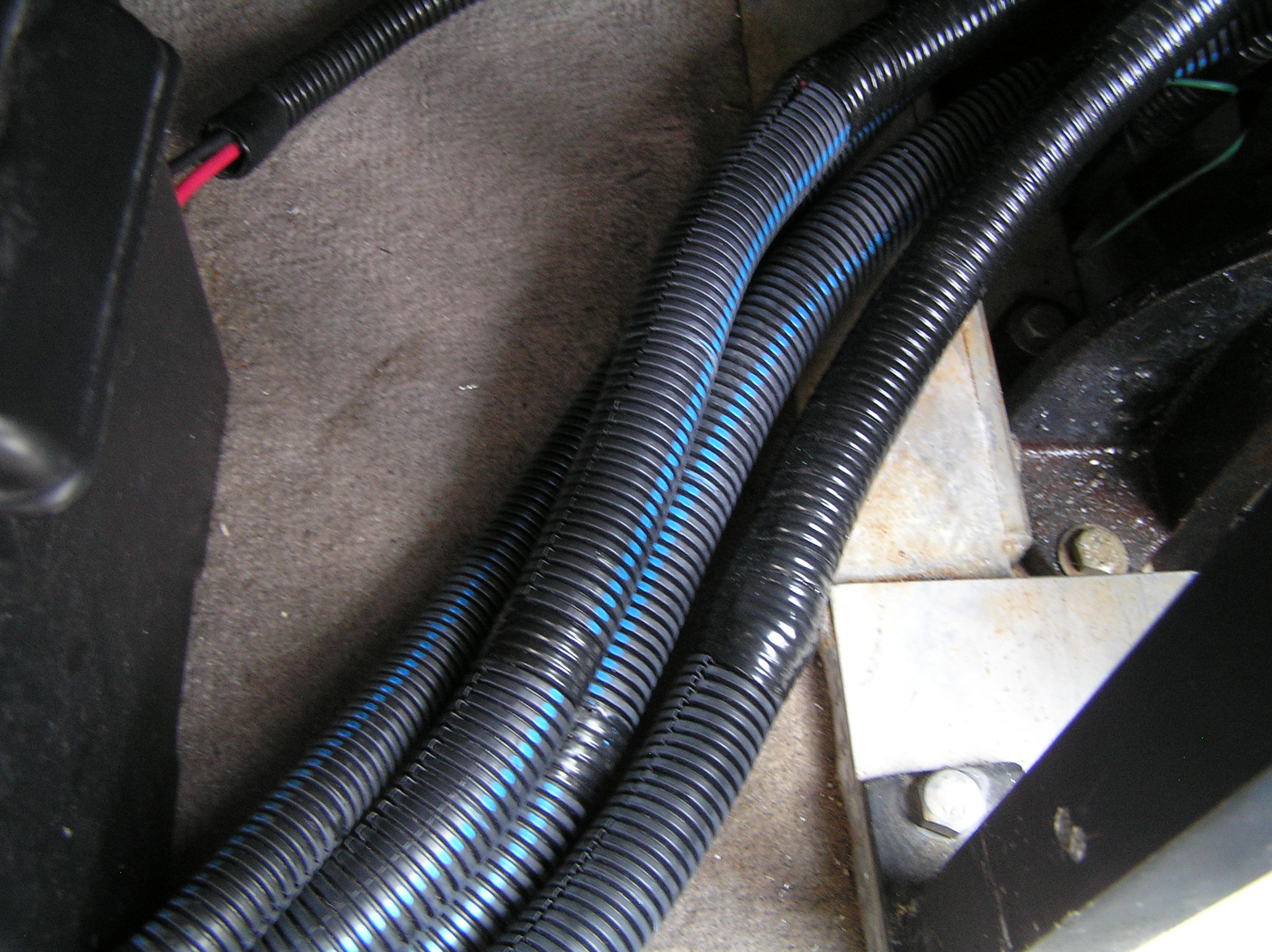

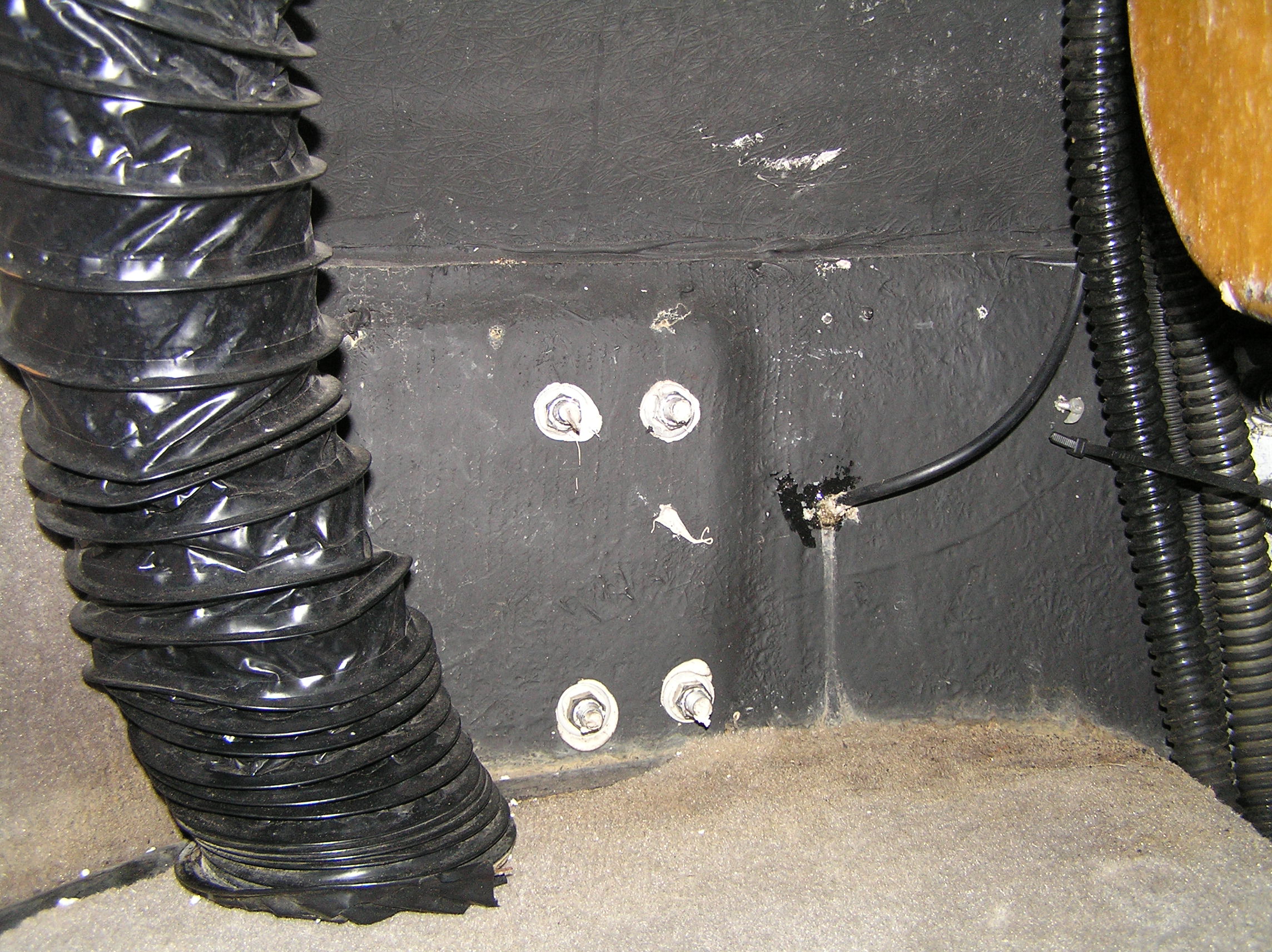

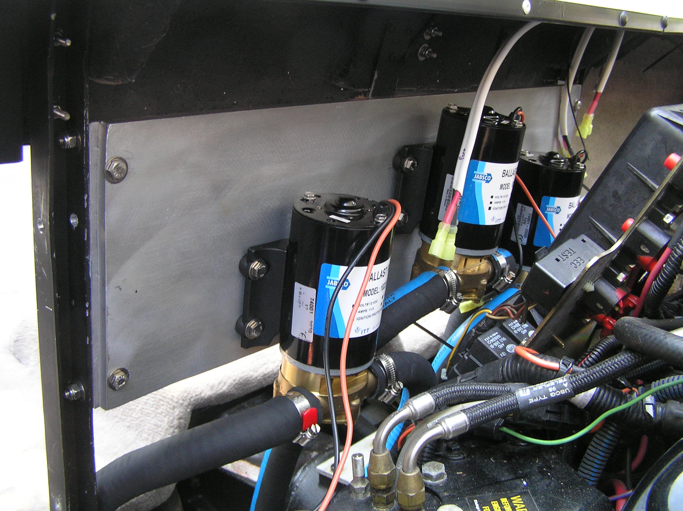

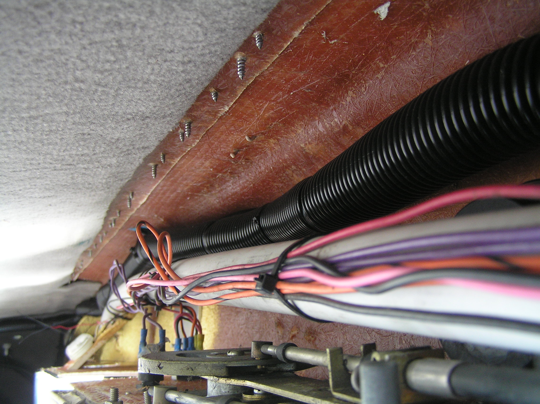

I have been planning this upgrade for years and finally got around to getting it all done. I chose to go with three pumps and a two rear bags and one center bag in the ski locker. Here is a list of the parts I used in my upgrade.

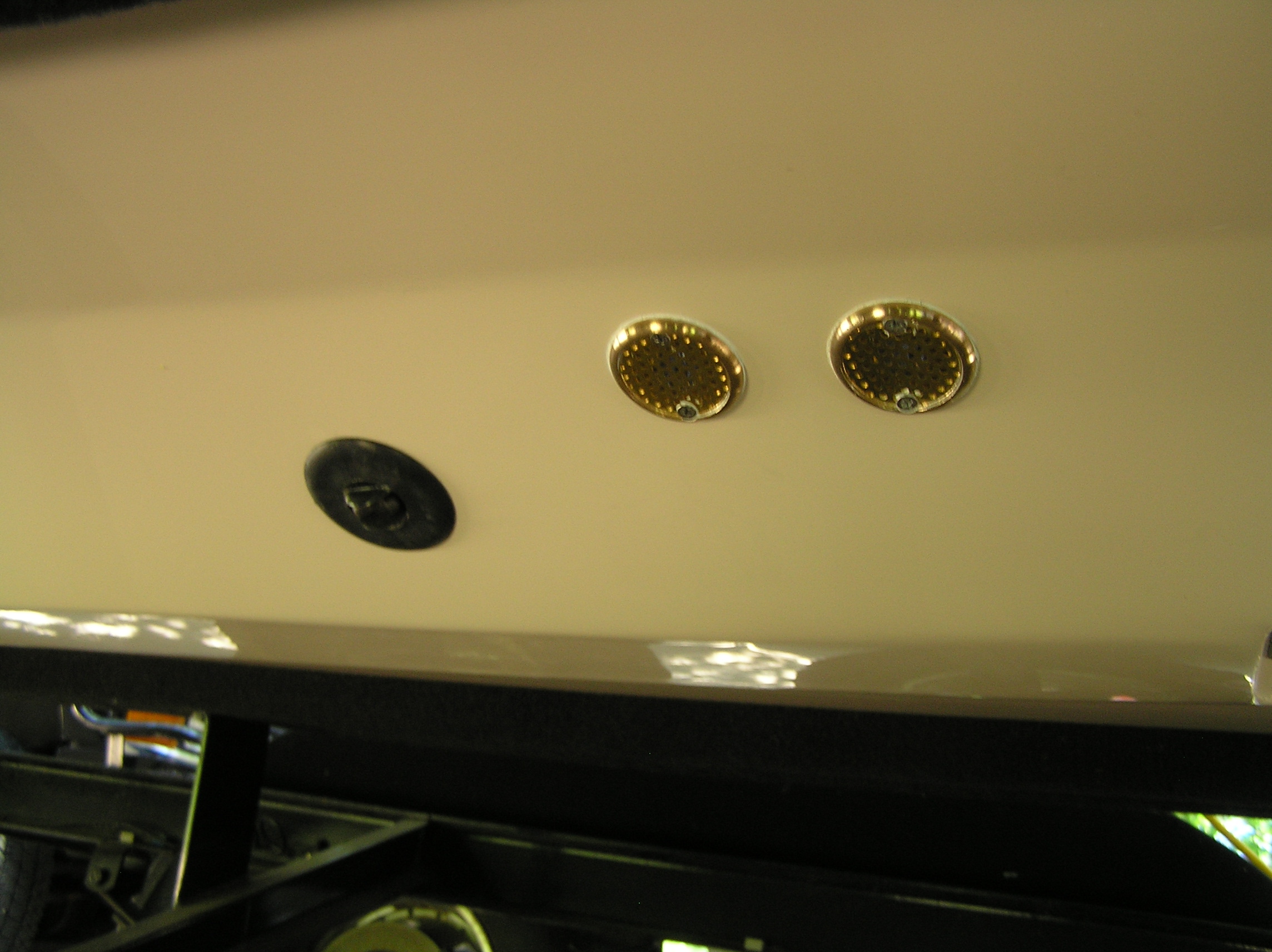

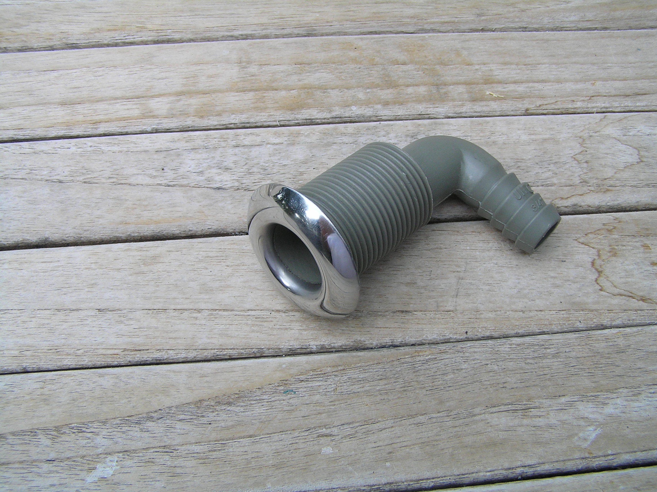

Fill and Empty Thru Hull Strainers Factory Nautique one offs made by Buck Algonquin P/N 3430

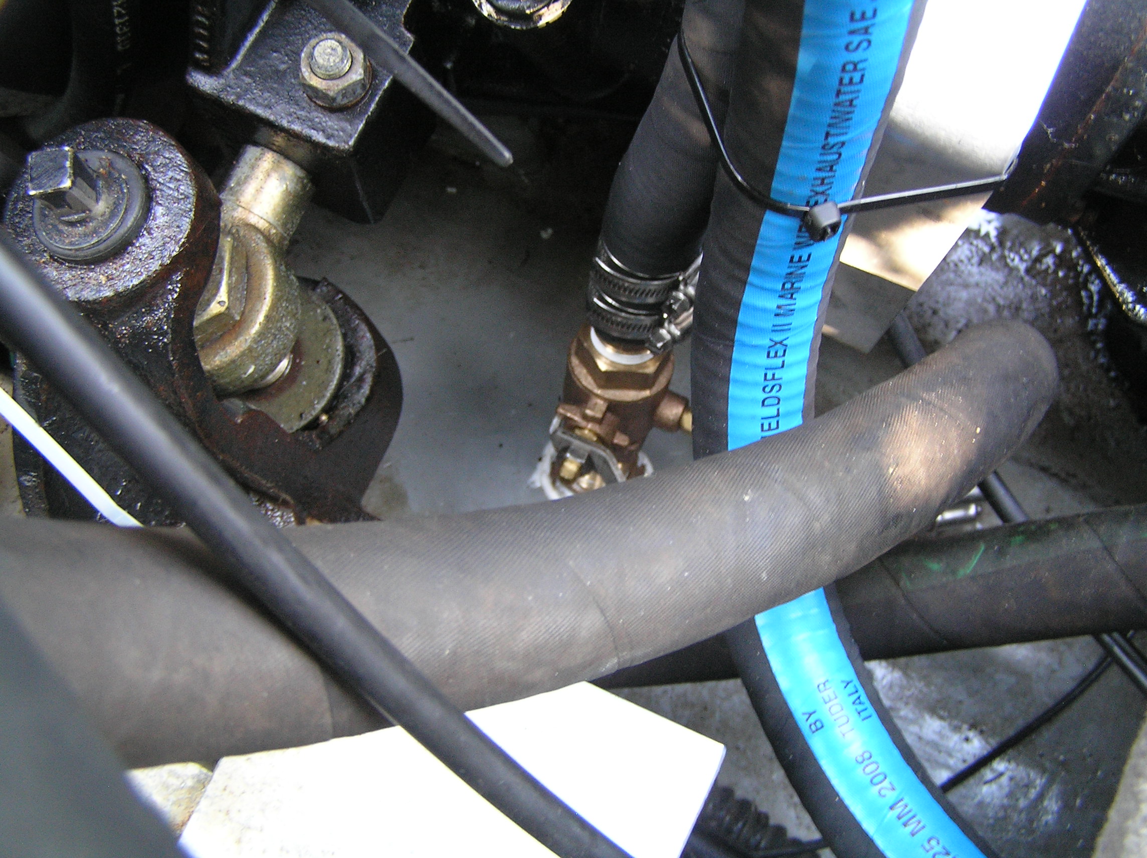

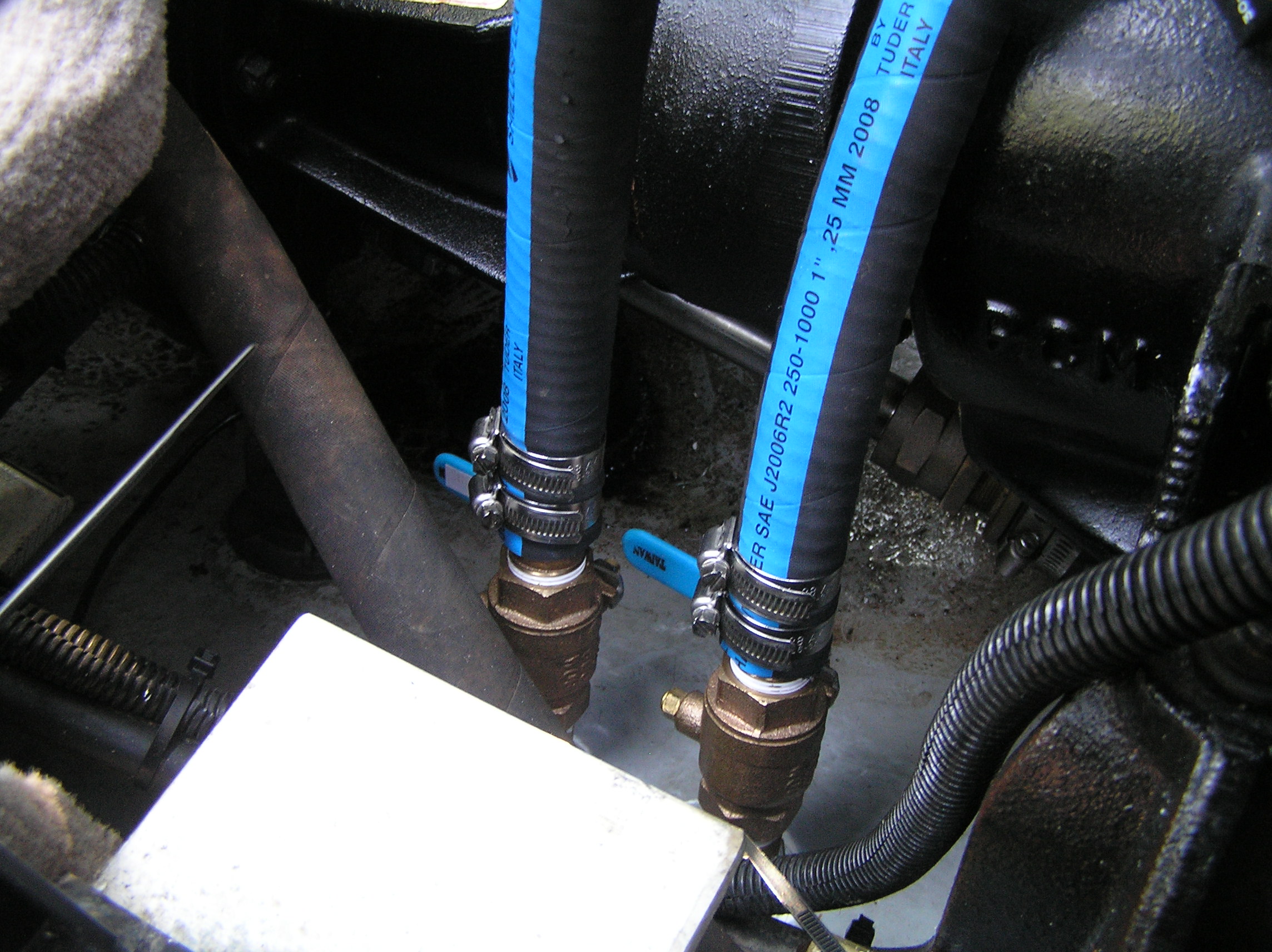

Ball Valves - Buck Algonquin P/N 00BBV75LP
Hose Barbs Groco Ύ to 1 inch full flow

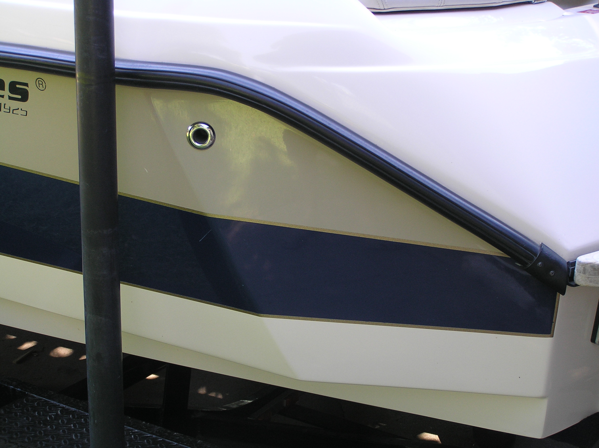

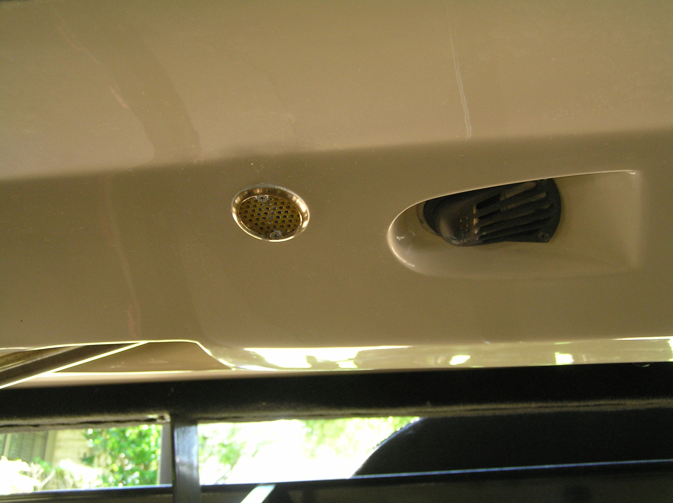

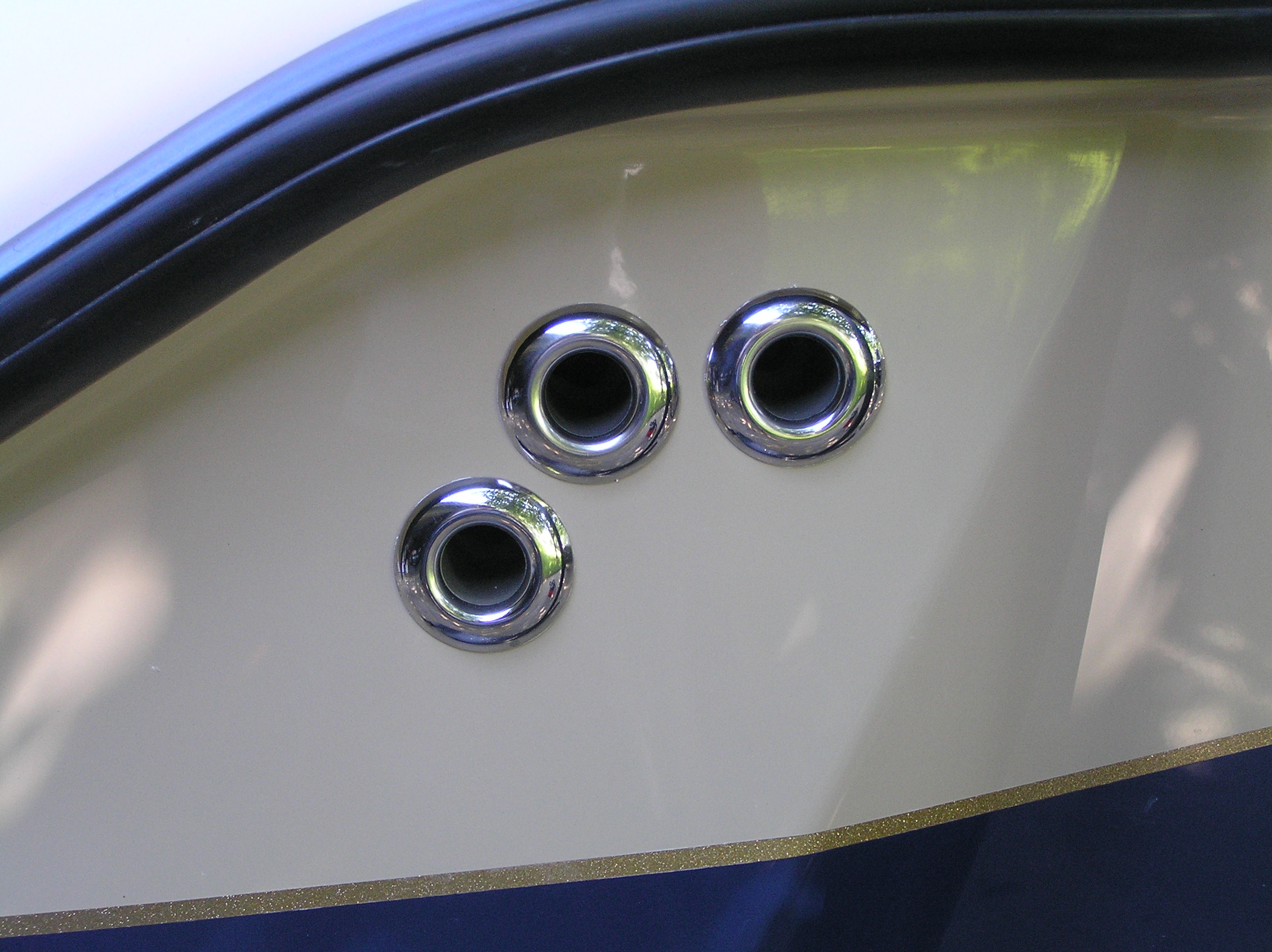

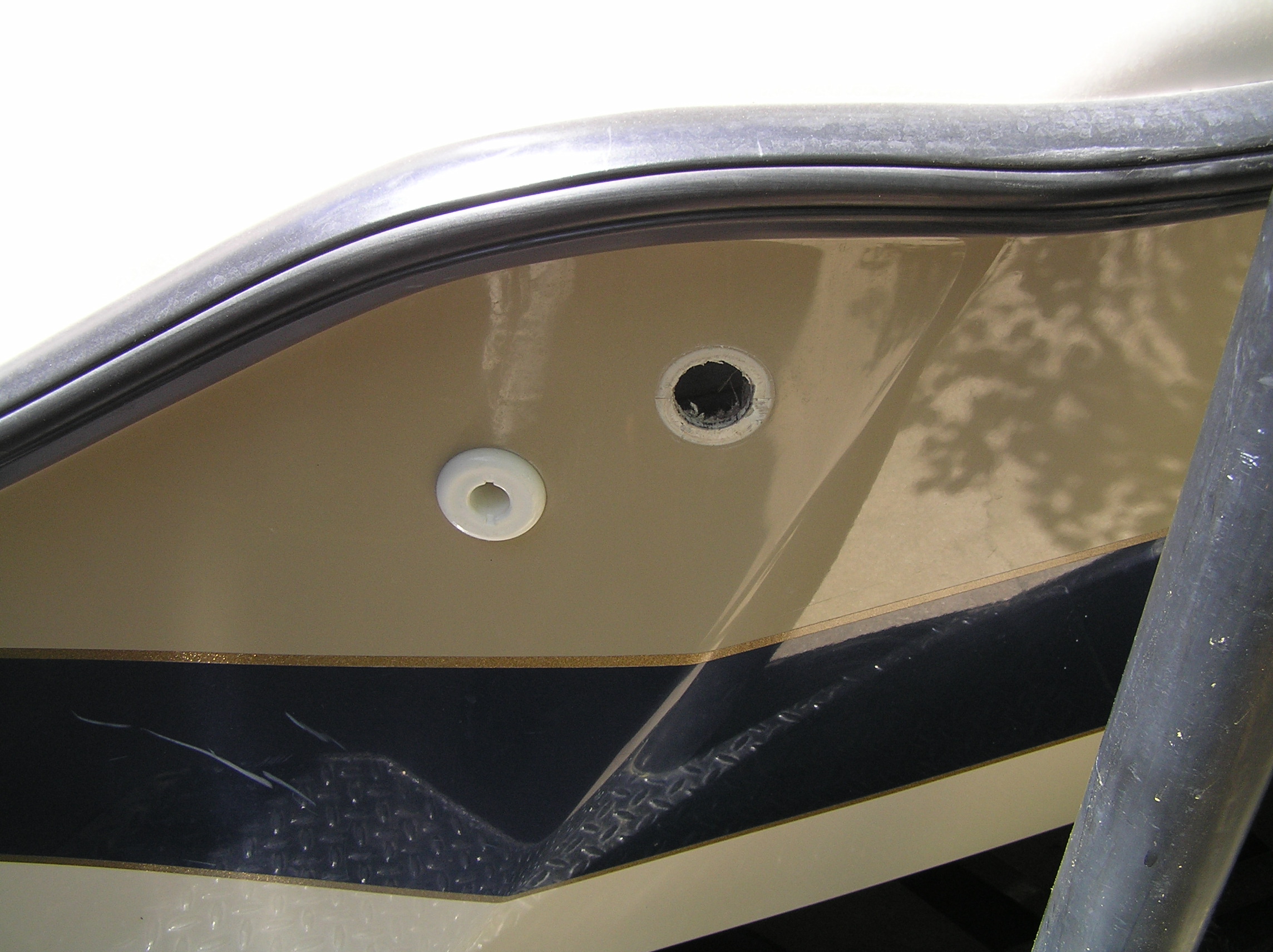

Above Water Thru Hulls Factory Nautique Ύ inch stainless capped
Pumps Three Jabsco Ballast Puppy pumps P/N 18220-1121

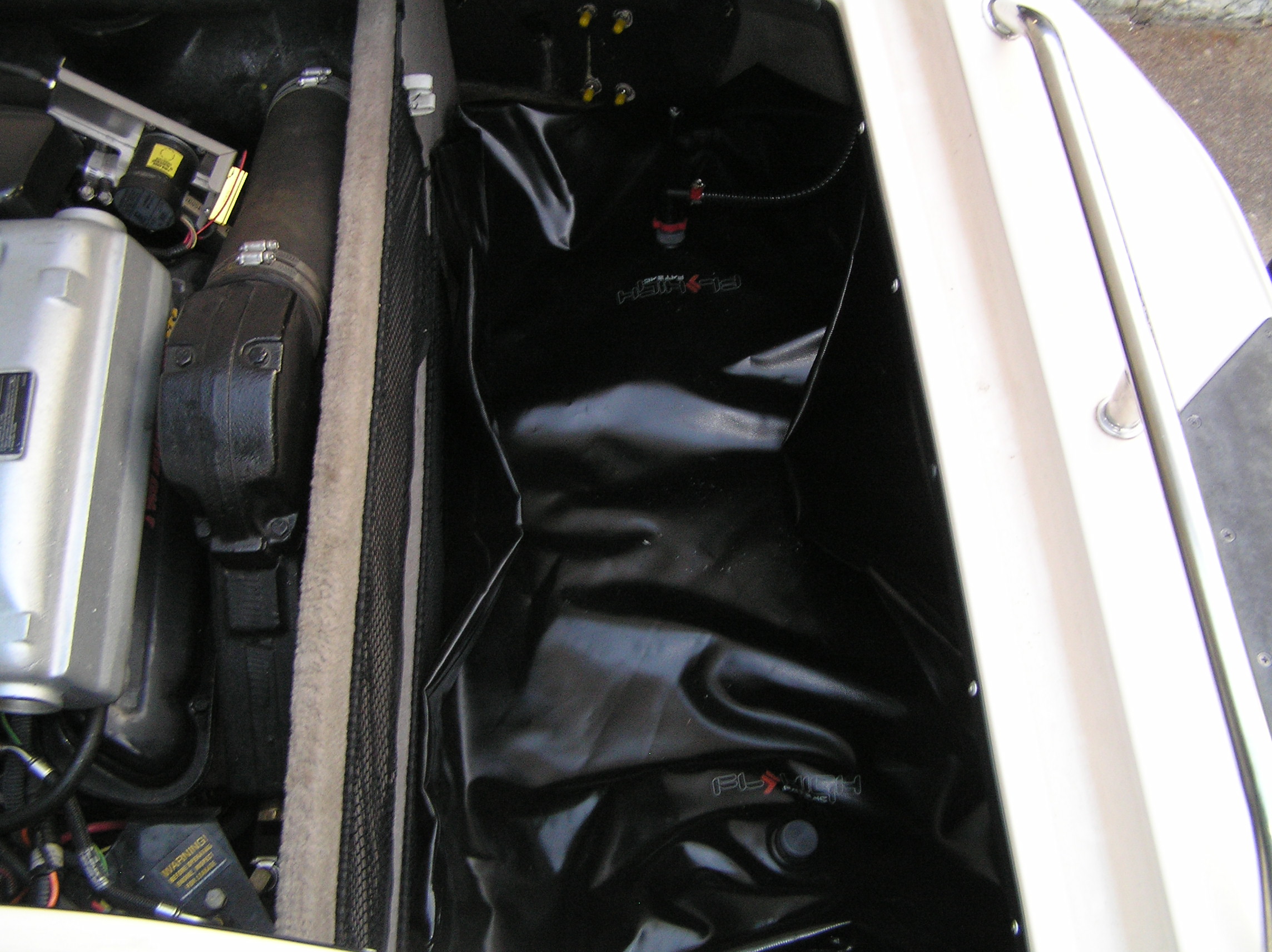

Rear Sacs - Fly High Fat Sacs W707 on both sides of engine
Center Sac Fly High Rear Seat Sac W705

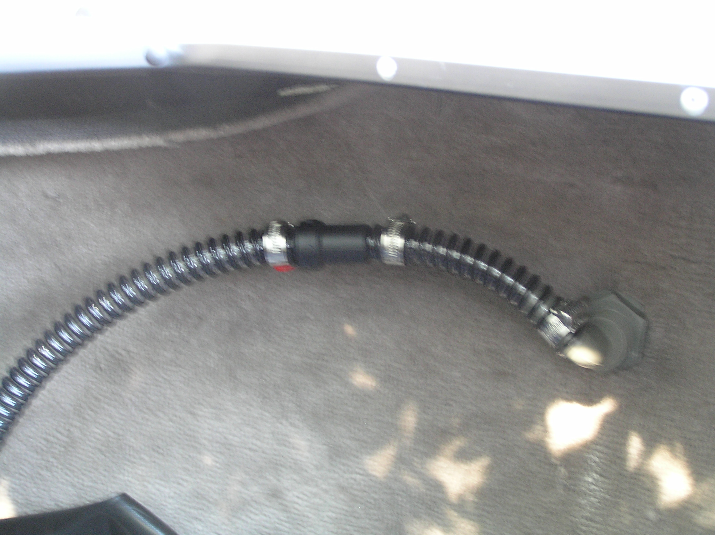

Hose Connections Fly High W743 and W746 for input hoses from pumps, and W737 and W742 for overflow hoses
Hose Clamps AWAB 316 Stainless Steel Hose Clamps
Fill and Empty Hose - 1inch Shieldsflex II Water Exhaust Hose
Vent Hose Shields 141 Ύinch HD bilge hose

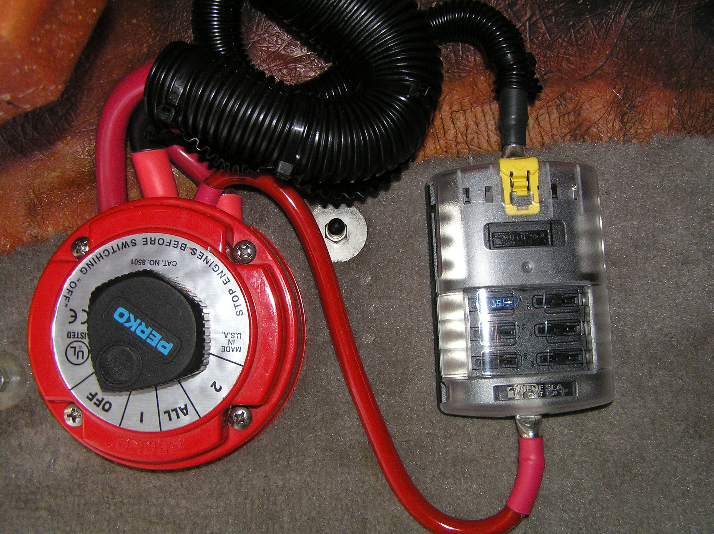

Power Wire Ancor Marine 1/0 gauge
Fuse Box Blue Seas Systems ST Blade Fuse Block 6 circuit
Power Wire From Switch to Fuse Panel 4 Gauge
Ground Wire From Engine to Fuse Panel 4 Gauge
Wire From Fuse Panel/Pump Switches/Pumps Ancor Marine 10 Gauge Duplex Wire
Below Water Line Adhesive 3M 5200
Above Water Line Adhesive Life Caulk
