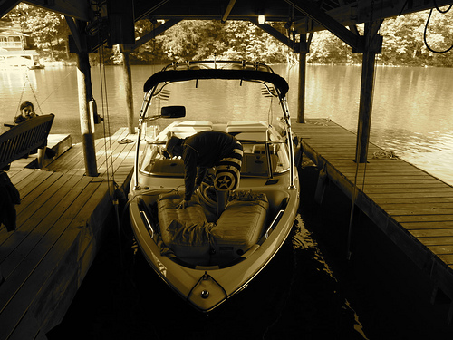

                    Oh, and for the record, last time we had my '09 out, we put 2 540's in the rear over the stock ballast, 2 540's in the fron, an 800lb sack in the walkway/next to the driver, then a 540lb sack and 2 250lb sacks on the floor. the wake was washy as **** until we pumped out the belly - then the ****ed boat started porpoising like crazy.
                    What I'm curious about is how people are adding all this weight and still getting a clean wake with no wash.

                        Oh, here's the same perspective with the '09
