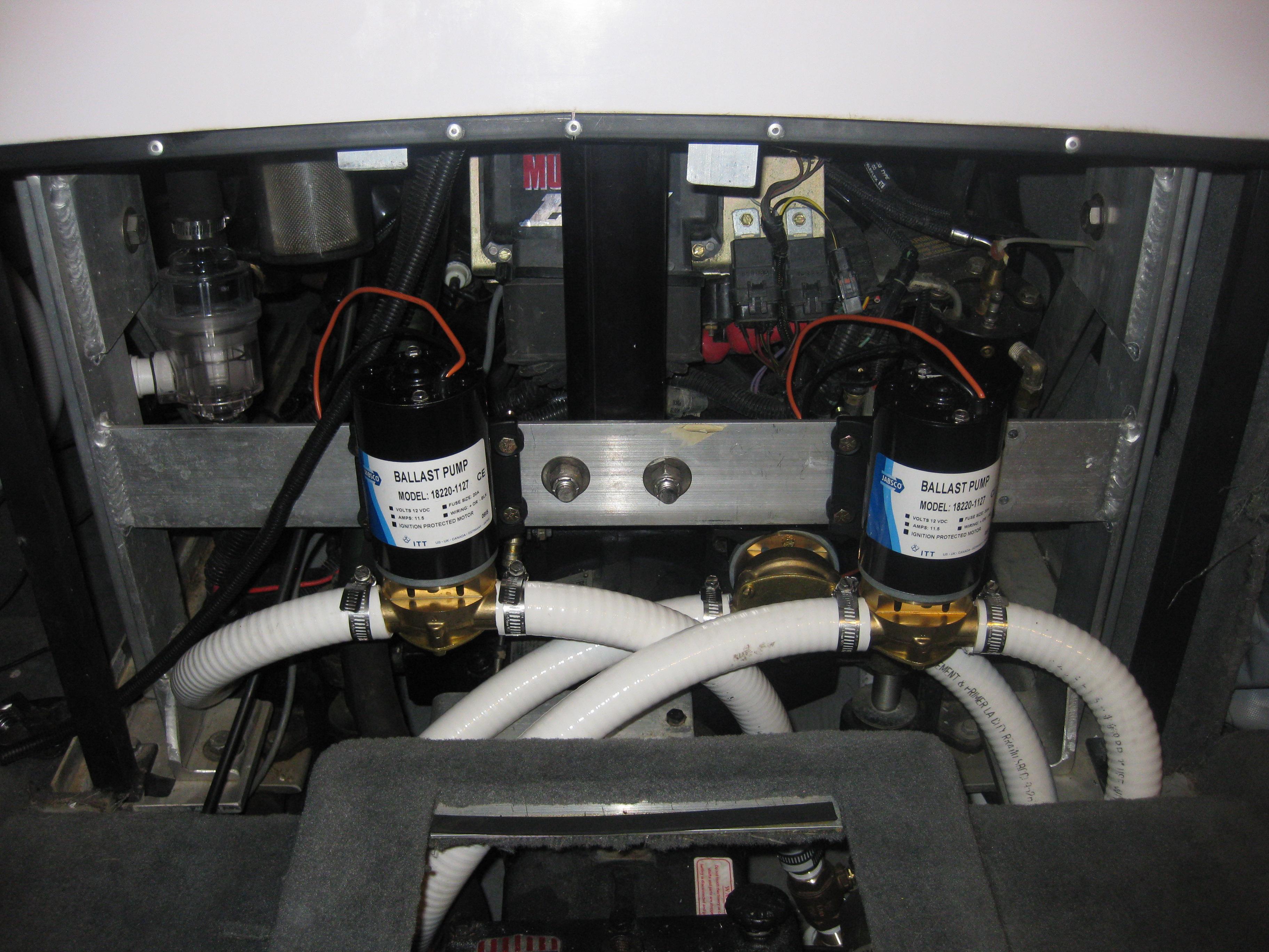

              I mounted mine to the engine/pylon support. I floated the boat last Wednesday to make sure everything worked (did full balast, switches, tower light, star gazer) and on Thursday I blew my right knee completely out with a little motocross. Now I'm out for 2009. Hope 2010 comes soon. Oh well, see the pic below.

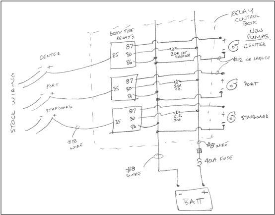

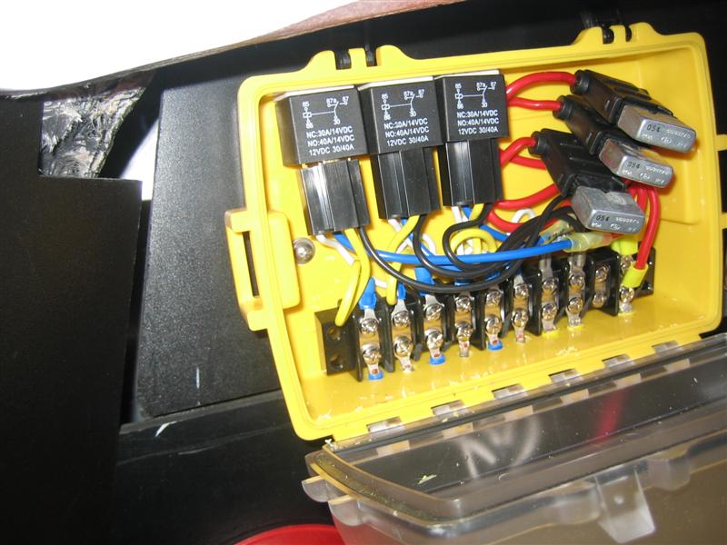

                        I did my 2005 in 2007. Removed the flow-rite (and TH Marine) valves, replaced the fill pumps with ballast puppies, and wired relays to the stock fill pump harness. Works exactly as it should have from the factory. Pulled the valve knobs and cables, it was liberating! The drain pumps work fine, if you have them leave them. Most impeller pump issues are caused by reversing or running them dry, you won't do either if you just replace the fill pumps. The aerators probably empty the tanks faster than the impeller pumps anyway.
                        Here is my wiring sketch.

                          Mikeski, you said you only replaced the fill pumps. Where did you mount them since the factory location might get the motors wet?
