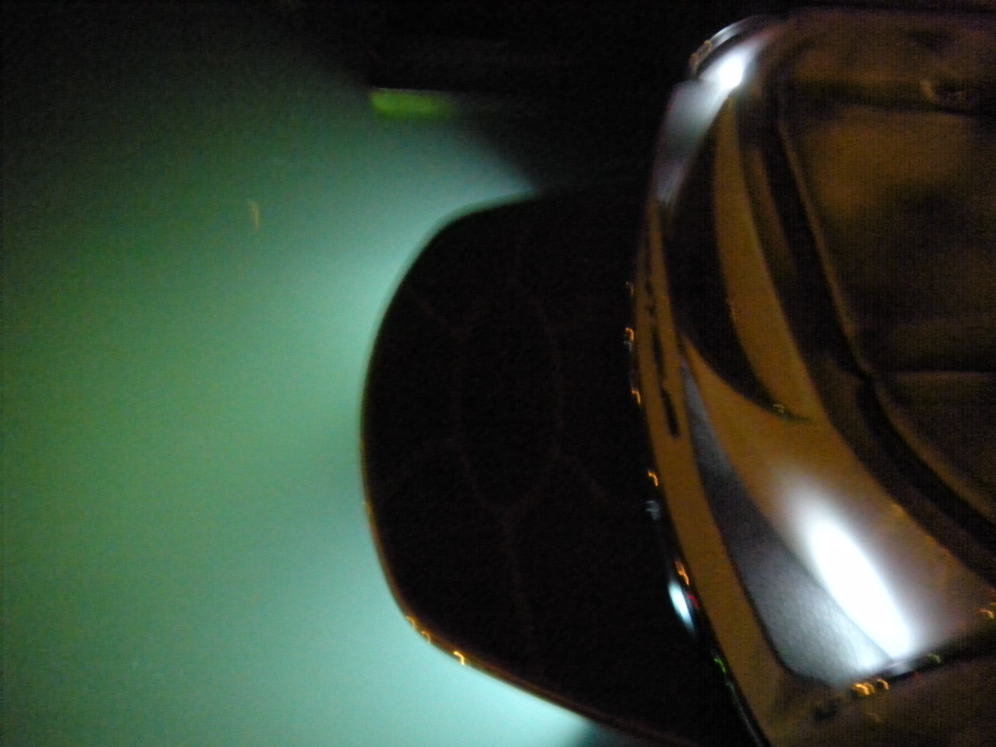

    To begin with, I guess my camera hates night shots, because these are the worst pic's I've ever taken. But, I still wanted to give you guys an idea of what they look like for those who are considering. I installed two Bullet Lines X6000's. The pic's were taken on Cedar Creek Lake in a shallow, muddy bottom area of my buddy's cove. I'm sure the light would project much further out in better water, but they look decent. Ken at BL advised that 3 lights would project the best light out, but I opted for 2 to start with to help my wallet out. I think the addition of one more light in the middle would help a lot.

    Looks great as it is! Nicely done!

        I had someone else install them, but I did check them out when I got them in the mail. The hole is around a 1/4" or smaller, just enough to get the wire through the hull. Yes, on the X6000's there are three mounting holes, but not sure if that is the same for the X8000's.
        I'll try and get some more pic's with a camera that takes better night shots. Definitely post some once you get them installed AuMDLST. I'm anxious to see the difference in the X6000's and X8000's.

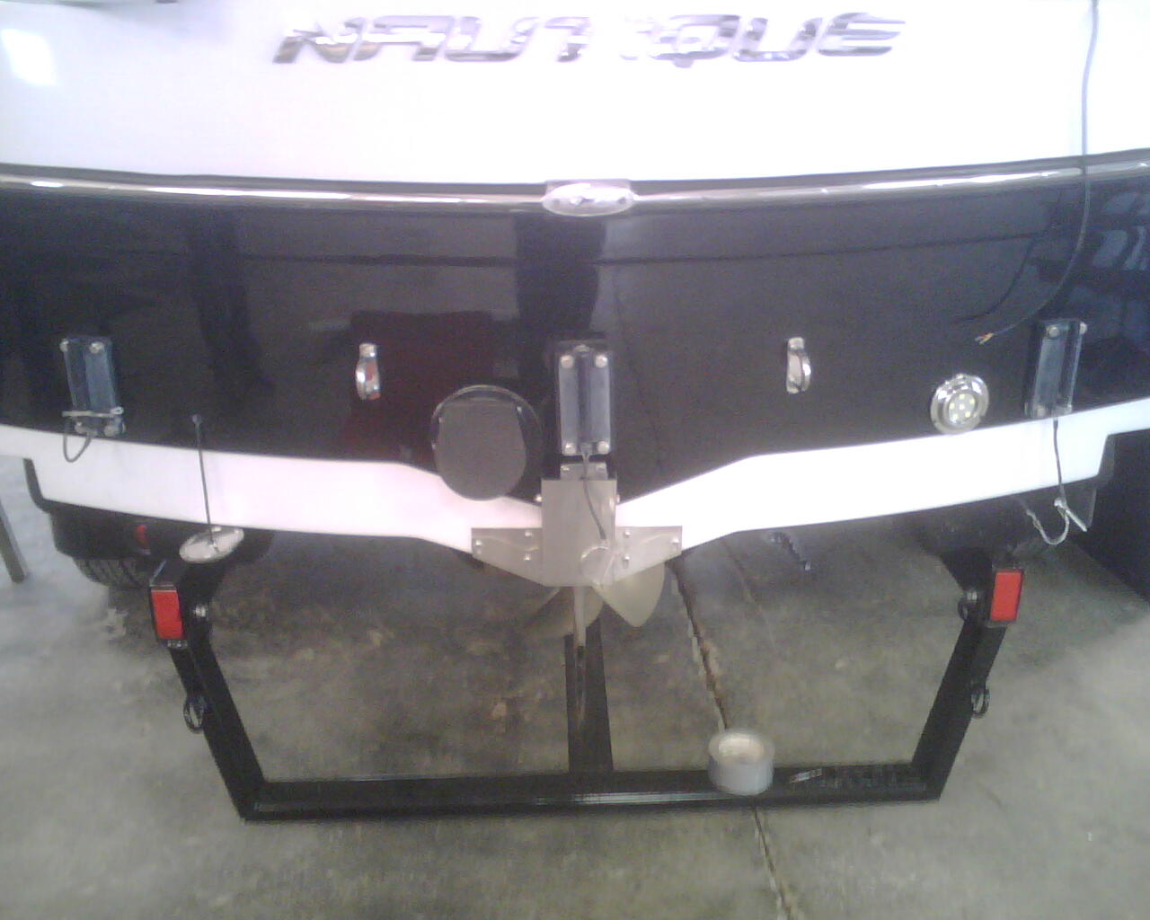

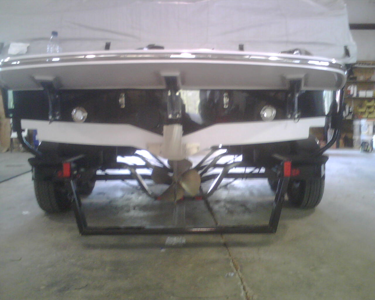

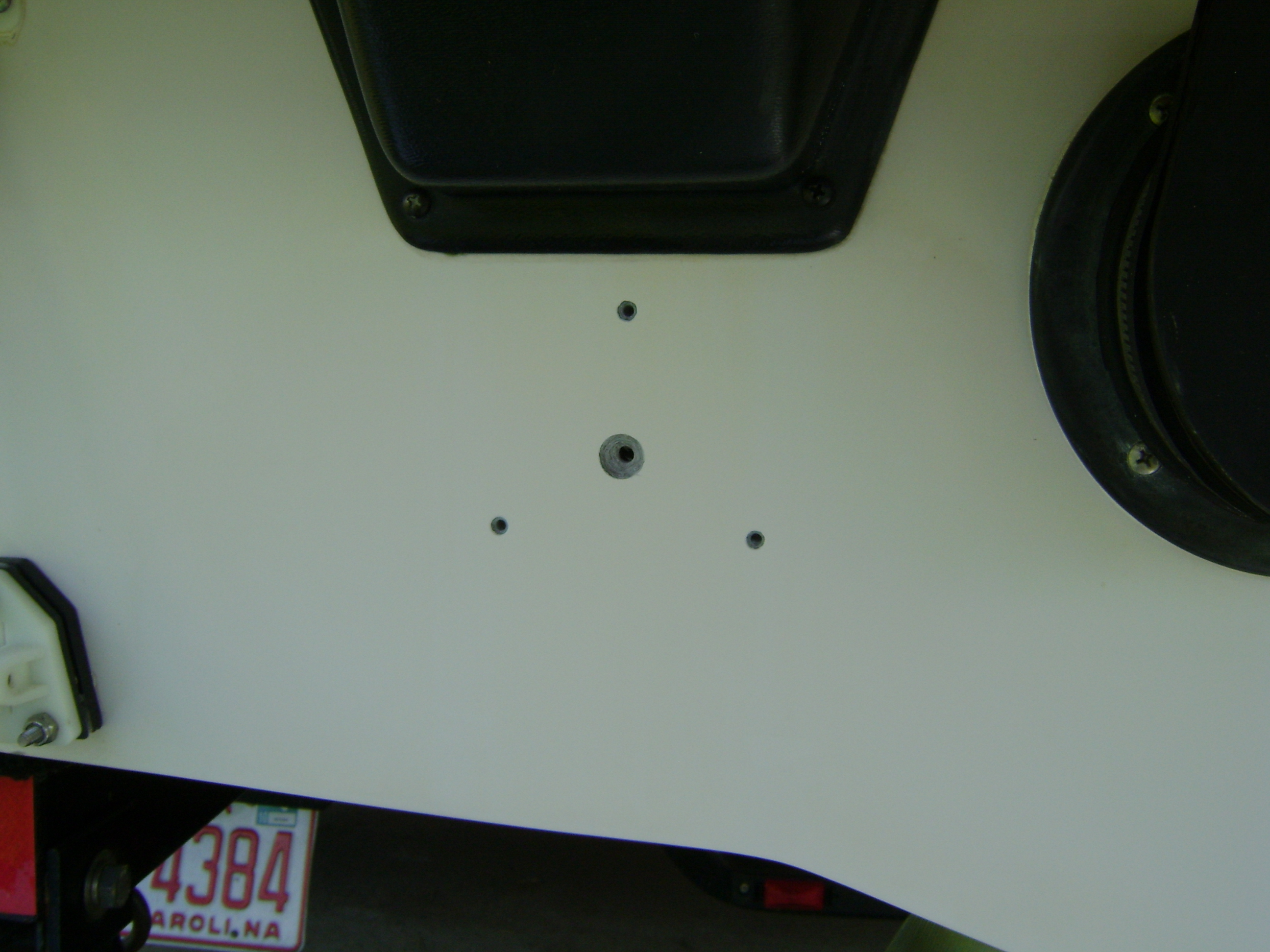

          If those are the ones from Bullet Lights it's very easy to install and not worth paying someone to do it. We installed them on our '08 210 in about an hour. It just takes a gut check to drill into your boat!
          Drill a 1/2" hole about a 1/4" deep (measure a 1/4" on the bit and put some tape on it as a mark), put some take on the hull and then drill... drill very slow...
          Then drill a 3/8" hole in the center of the 1/2" hole through the hull. Coat the wire with some 4200, not 5200, and feed it through.
          The three hole for the screws I think were 5/16" and you drill them about 1/2" deep.
          Below are some pictures... and sorry for the poor quality, cell phone pics...

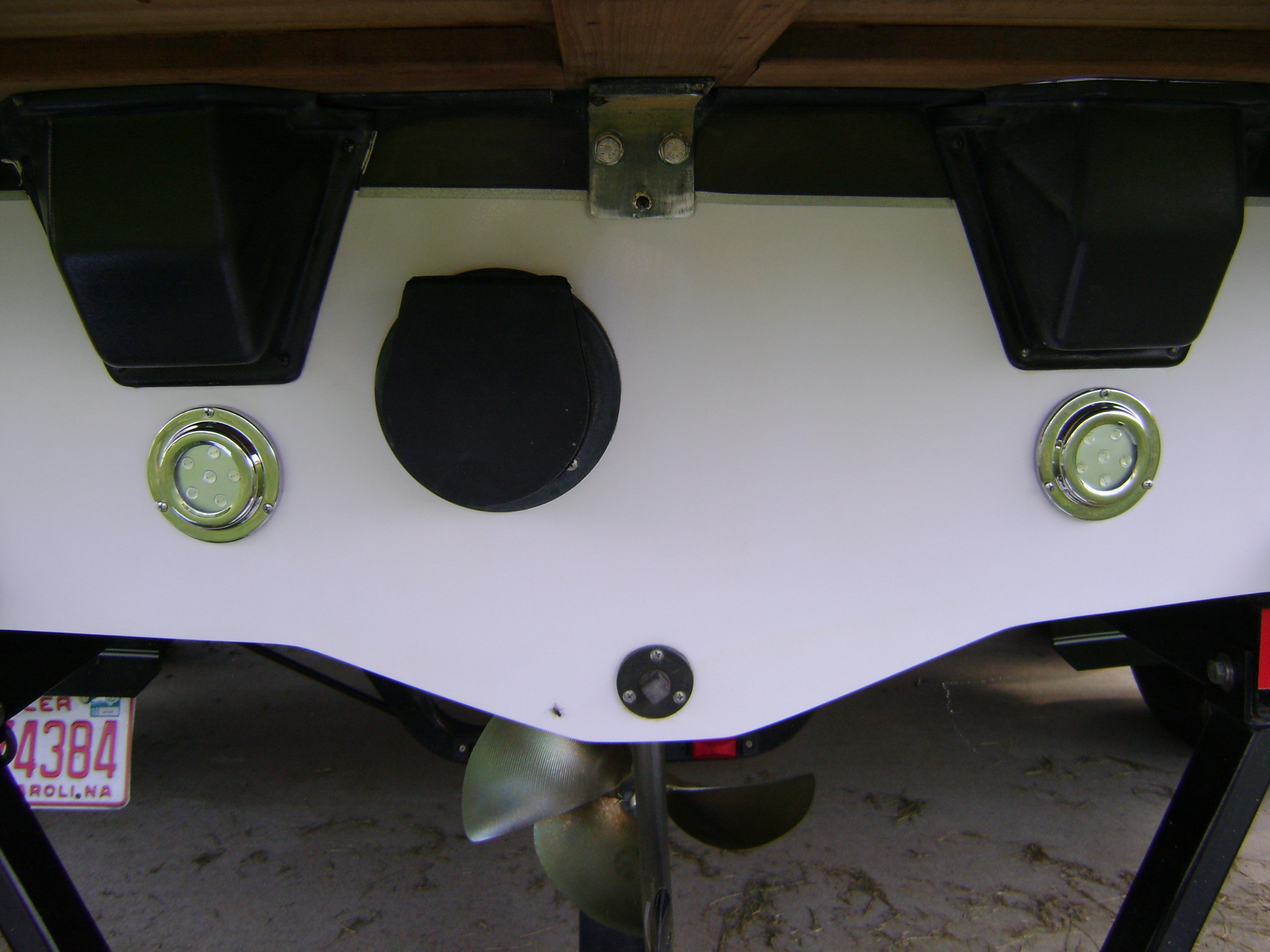

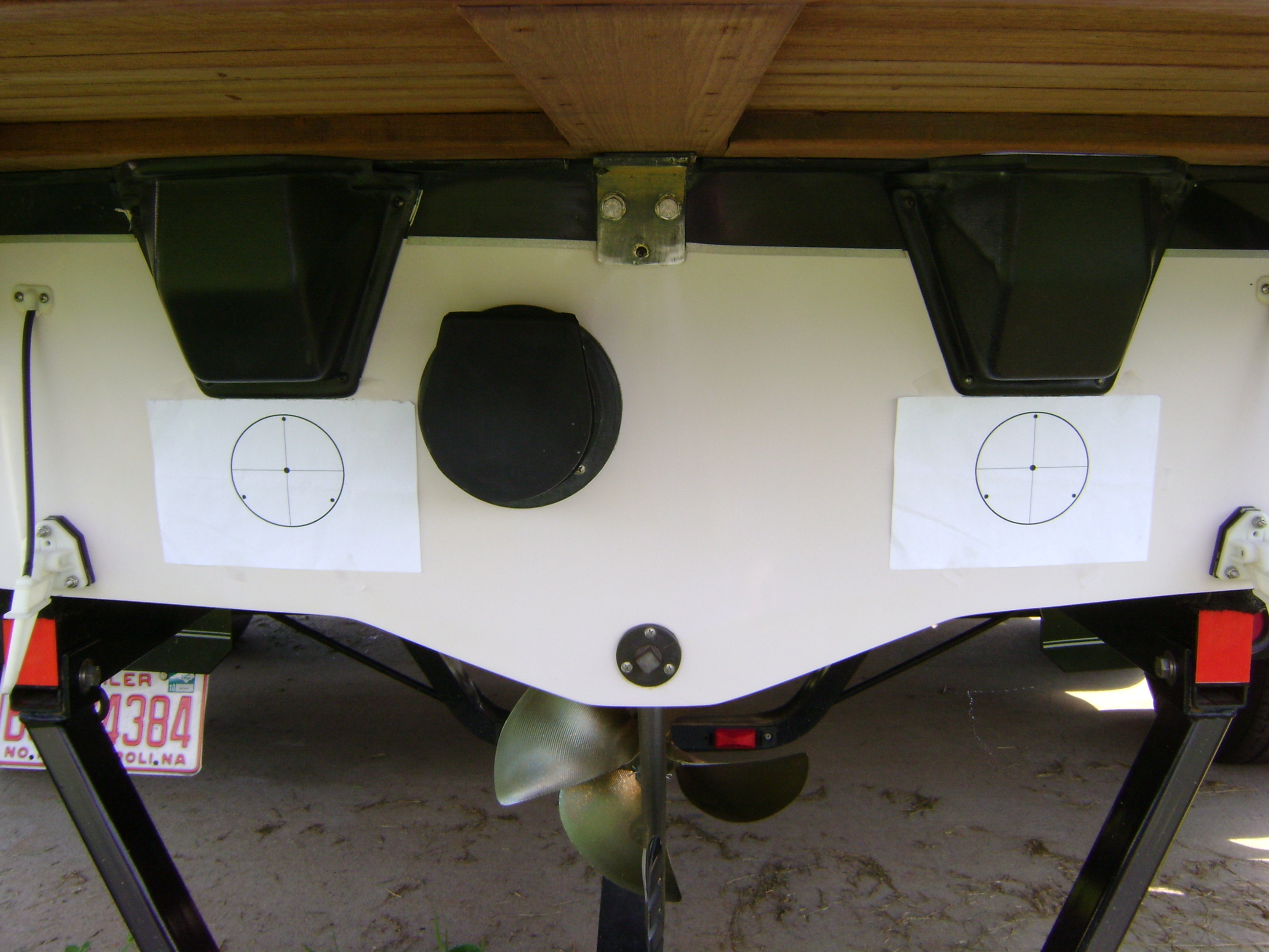

                i just got mine on today and can't wait to try them out.. heres a few pics of the install

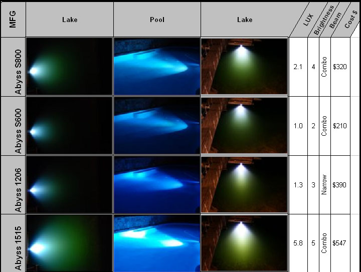

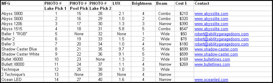

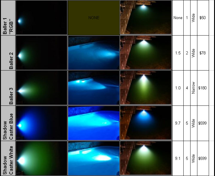

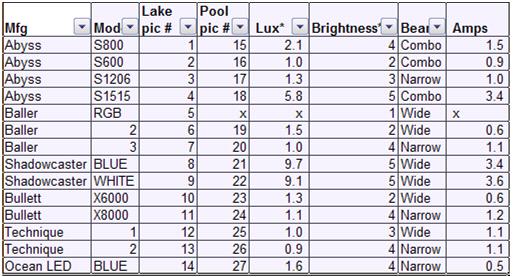

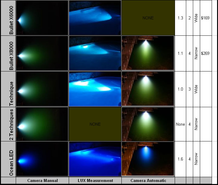

                  Grant and I did some comparison testing of a few different LEDs on the market. Here are the results.
                  • Mikeski
                    • 2909
                    • San Francisco, CA
                    • Current 2017 GS22
                    double click to clear up the text

                      The only issue on that breakdown/spreadsheet is Bulletlines decided to jack his price up on the X8000s after he got some exposure. I was ready to buy a two of them but not since he went up $100 each in just a few days. You guys posting pictures are not helping either. These threads are costing me money......
                      2001 Super Air Nautique
                      Python Powered
                      100 Amp Alternator
                      Dual Batteries
                      Many upgrades coming...
                      • Mikeski
                        • 2909
                        • San Francisco, CA
                        • Current 2017 GS22
                        Buy the Baller #3's from Robert. I could tell no difference between the Bullet 's and the Ballers.
