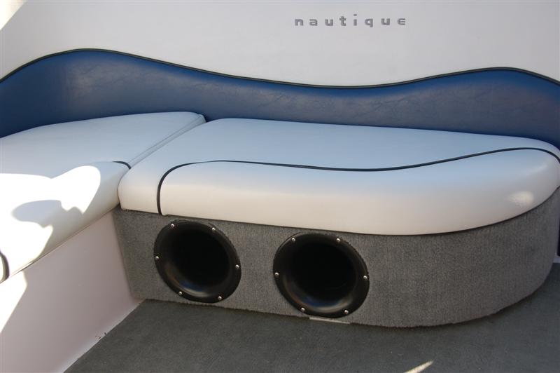

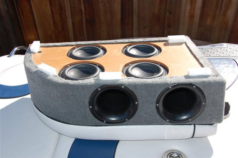

                    I anticipated this issue after seeing some of my lighter friends step on the tip of the seat and watching it flex quite a bit. Here was my solution...

                      Good idea Mikski... Assume you dont pull the plug much?
                      • Mikeski
                        • 2908
                        • San Francisco, CA
                        I pull the plug every time because my boat always seems to take on water. The box is made of resin coated "superlight" cabinet board, has 4 small light subs in it and it sounds great. Only weighs about 25lbs, my wife and sister have no trouble sliding it forward to access the plug.

                          Mikeski, is it still fastened under the side seat or freestanding? Guess you've never had a foot go through a speaker?

                            Mikeski,
                            Great idea! I am going to do something similar but without the speakers. This is normally the spot everyone puts their shoes so maybe a storage area with a door....hummm....ideas are flowing...

                              Foot through speaker??? That would be pretty tough considering the speakers fire down into the floor, you would have to get your foot in between the 1" space. Those black things in the front are 4" ports, no worries putting your foot or arm inside the hole.
                              Everything has it's place in my boat: behing passenger seat gets packs/bags/towels, under passenger shallow flip up gets shoes/sandals (closest to walk through), bow gets ropes/fenders/anchor, rear starboard locker gets dry wetsuits/jackets/lines/sacs/tools, rear port locker gets wet jackets/lines/sacs. When you are consistent with your storage spaces things are much easier to find and the pilot doesn't work so hard (usually me).
